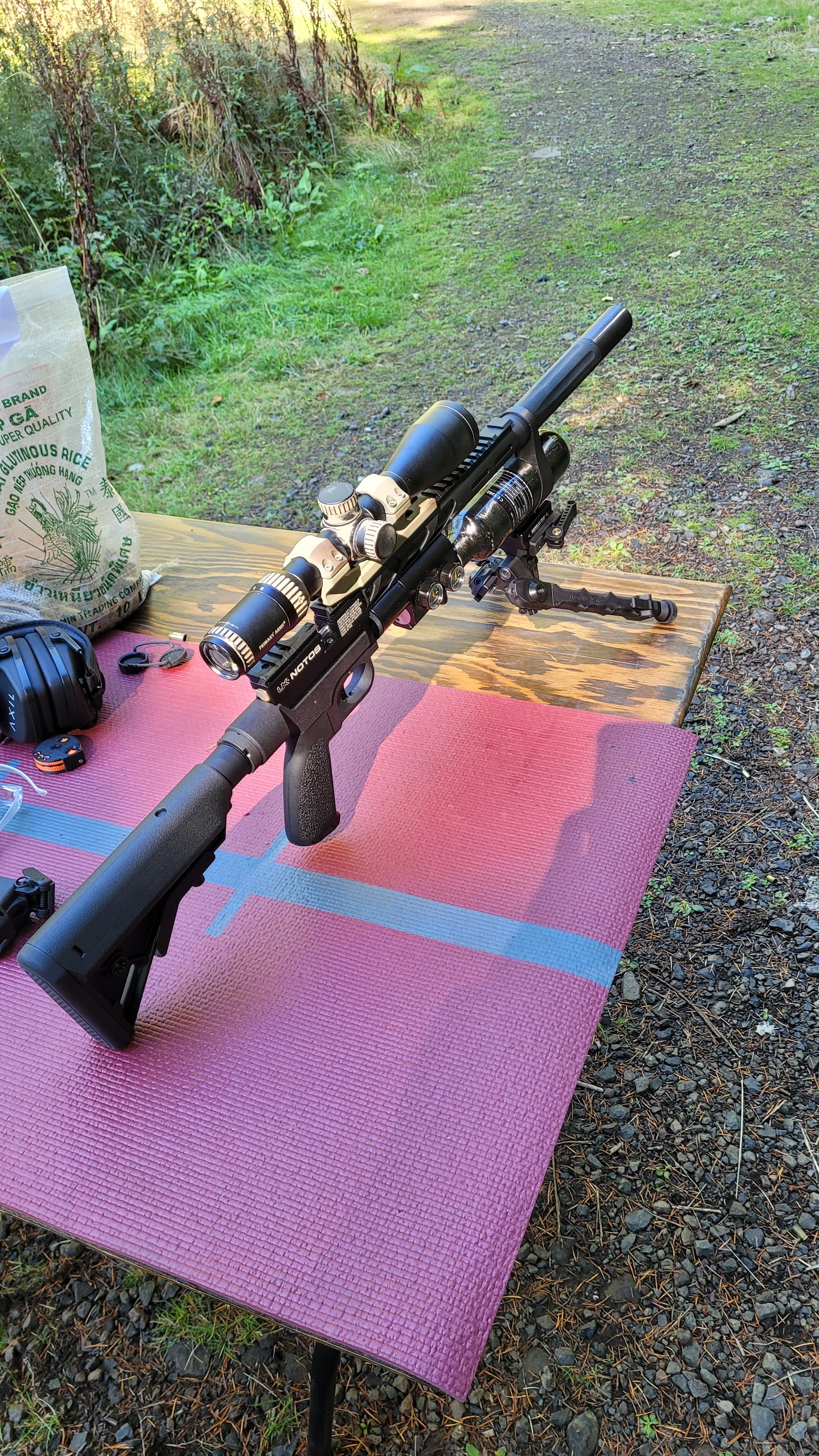

Where did you get the foldable stock and regulator? Could you please share the link, I wanna copy your set up looks awso
I thread the UTG folders to fit the OEM stock. PM me for details.

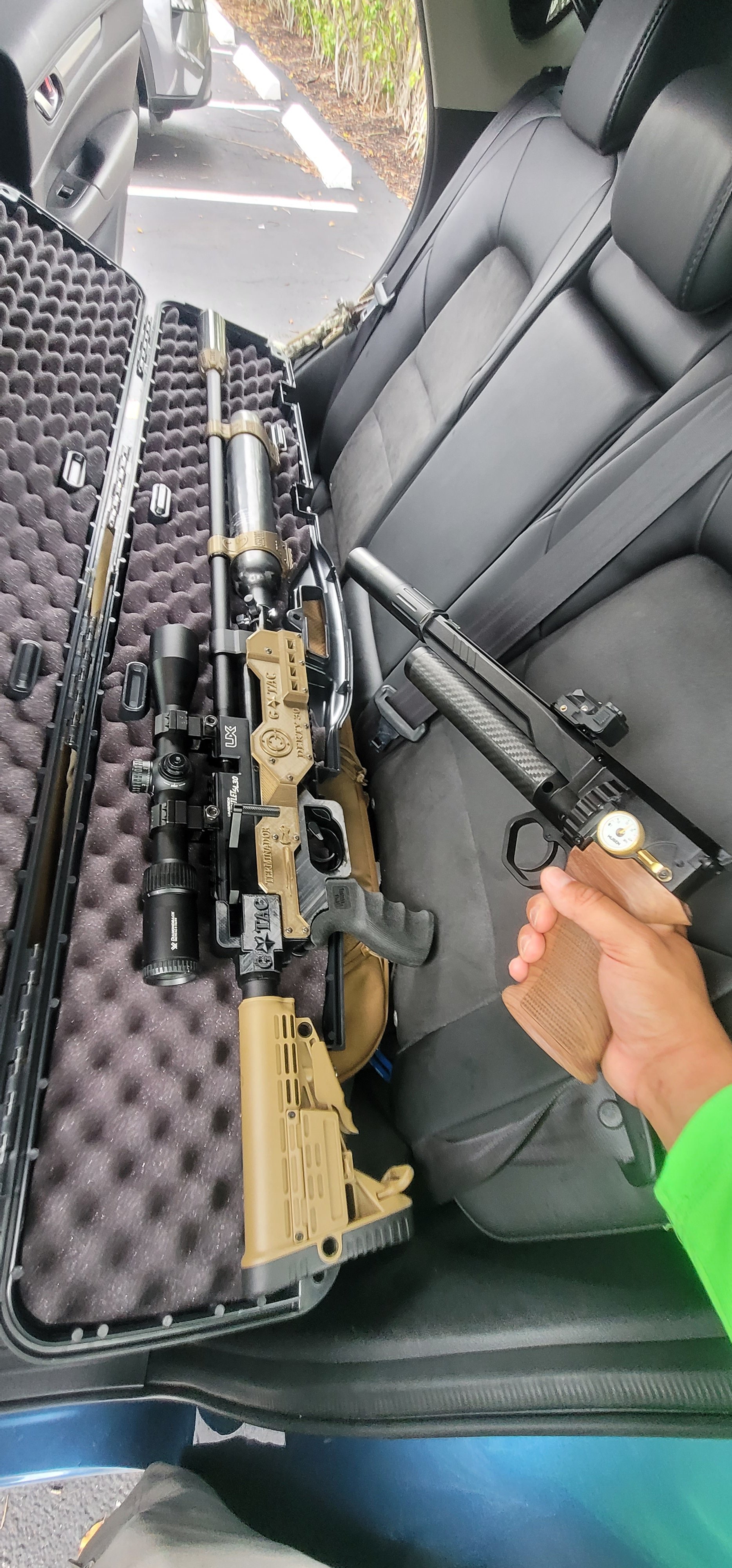

I actually traded it with a member on here for his custom g2 .30 SL along with mags and ammo. Drastic change from 20fpe to 100+fpe 😅 but it's a slug slinger, so I'd say I got my money back. I also got a GK1 that just arrived and that's what I am going to use for my up close. Also sold the M3 🙃 managed to replace that with a K1 .22, just gotta tune it for slugs it likes.

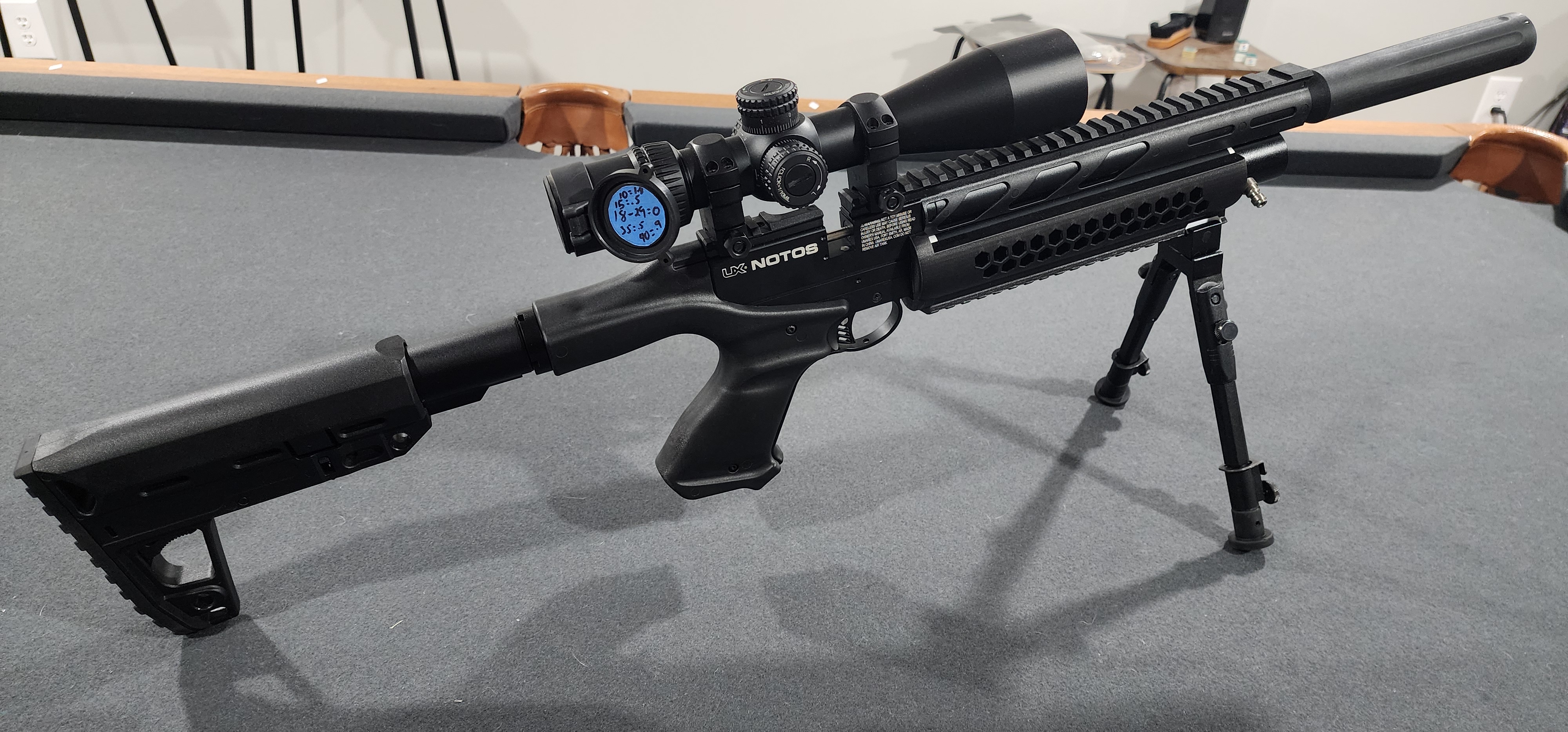

@L.Leon - to sort of answer your question on comparing the two...
I have a modded Notos($690) and a BRK Sniper XR(that's as close as I've been to an Atomic or Ranger, but I think they are mostly the same).
The Sniper is definitely a better gun in all respects but one, weight. Having said that, accuracy is probably about even.
Stock, the Notos was very accurate but couldn't quite shoot as far as the Sniper, it can now that it's been modded with a longer slug liner.
The Sniper also has a much better trigger, hands down. Unless your used to a crappy 10/22 trigger, the Notos is tough to shoot smoothly when compared to a BRK. Luckily for me I've shot a bunch of black pwder guns with what felt like 20lb triggers, so it's not bad in comparison.
The Notos is definitely not as refined a gun as the Sniper, but I'm not throwing the Sniper in the truck because of that like I am the Notos.

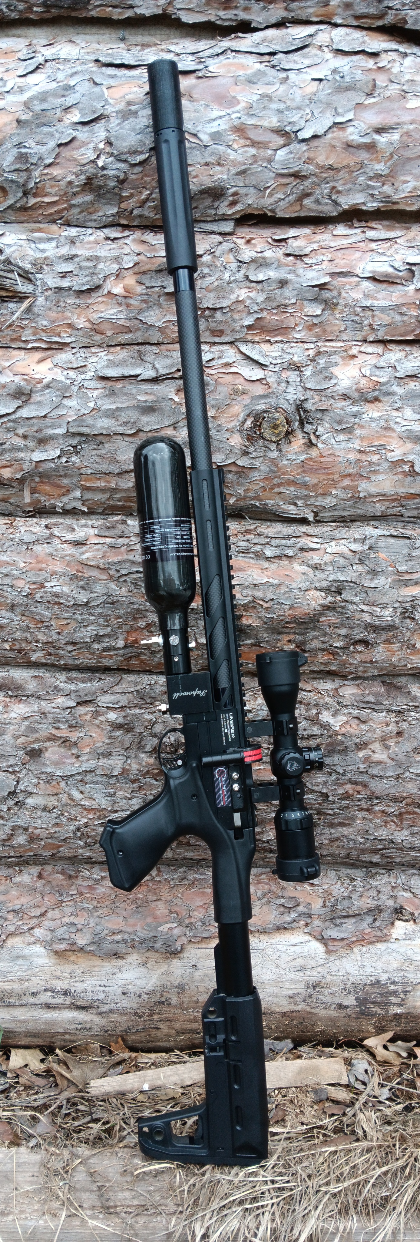

Not sure if there is a better location. If so, tell me. However, I designed this up while Firewalker was upgrading my notos. Here is a picatinny mount that clamps around the barrel and .22L bottle with two 3mm screws and nyloc nuts. I tested it out yesterday with my pic to arca adapter and arca bipod. Plenty sturdy. I used proto pasta CF filament.
Files on Printables

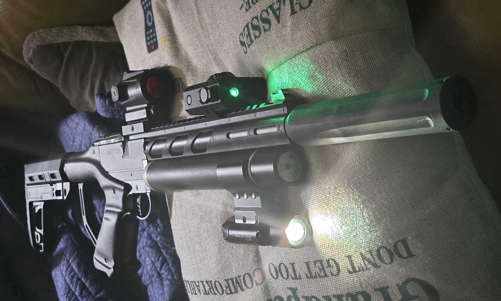

Update! Actually love this gun bone stock! I have a wicked rat problem living in the City, & Jesus these things don't have a chance! Only upgrads thus far are on the the optics end. But this thing is perfect for dispatching rodents quick, quietly, & efficiently! That being said I may keep this for just that alone, as well as it's lightness my Girl has no problem tossing it into a back pack.. (Oakley Kitchen Sink) that is until I get the folding stock adapter... I actually ended up grabbing an FX Dreamlite compact in 25 cal for my "power" needs for now.. FX.. I know.. but the sale allowed me to snack one up for just under a Grand.. I do like it, but modding FX is like throwing $ down a rabbit whole lol. Still loving this Notos for what it is. As well it's good to know that I can always add more power & customize it when I'd like.. winter is coming up so plenty of time for that! Just would like to thank everyone here who's helped me out via advice, support & most importantly, your time. I'll be back here shortly after some more upgrades with new updates on progress. Thank you all! -SF

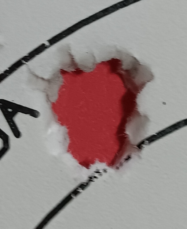

I'm up too 800 fps with no porting thanks to C88 and his FX barrel!
0.159" center to center 20 shot group.

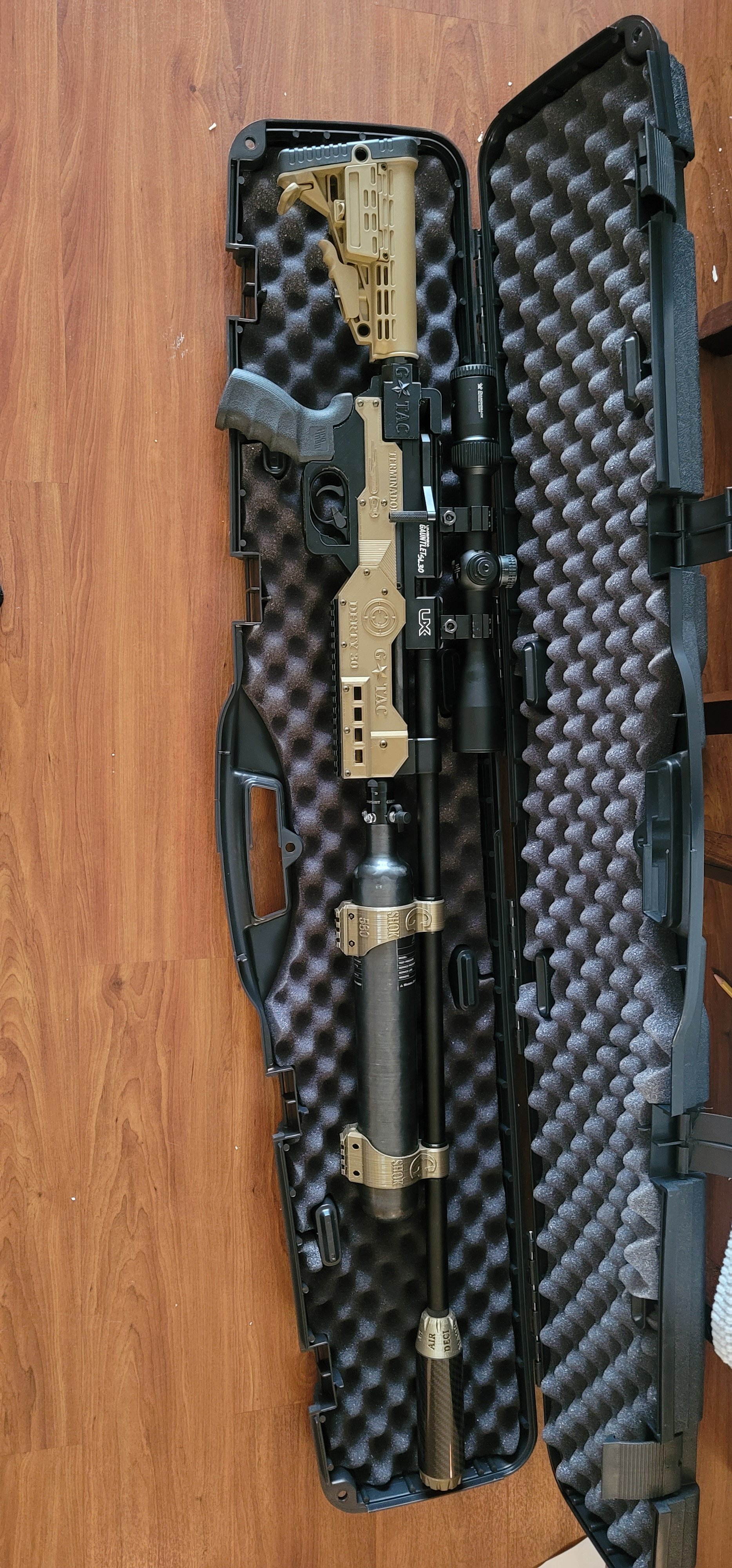

The old girl has been dismantled, parted out, ported and sold. So long old girl...
View attachment 456673View attachment 456674
