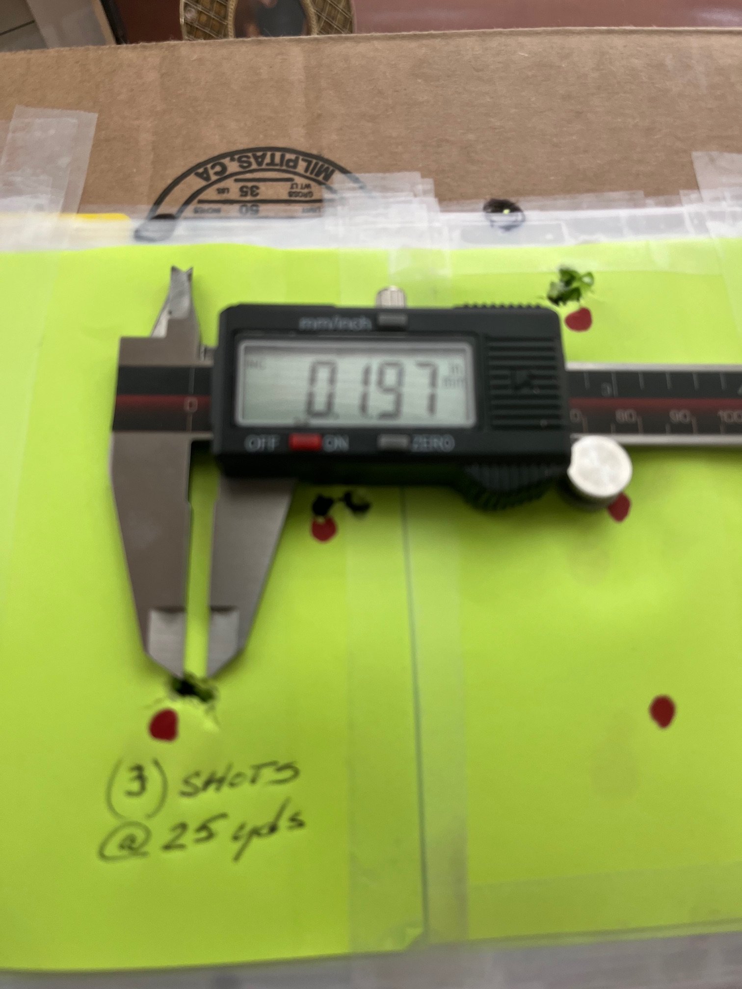

Thought I'd show a group at 25 yds (shot today) from a new Notos I got from AOA a few days ago. This air rifle is accurate. It shoots the JSB Hades pellets really well. I've shot several groups around .2" at 25 yds since I've had it. Exceptional in my opinion for a $260 air rifle. My FX barely shoots better. Problems: I had to work the trigger over from plus 5# down to 2 1/2#. Took some time, but the second stage is very crisp and nice now. Second problem is the magazine. Finally got it to run two pellets through before jamming. That's the best I've got it to work so far. Ordered two different aftermarket mags. Hopefully they work better. Single shot tray works okay. 20PPC

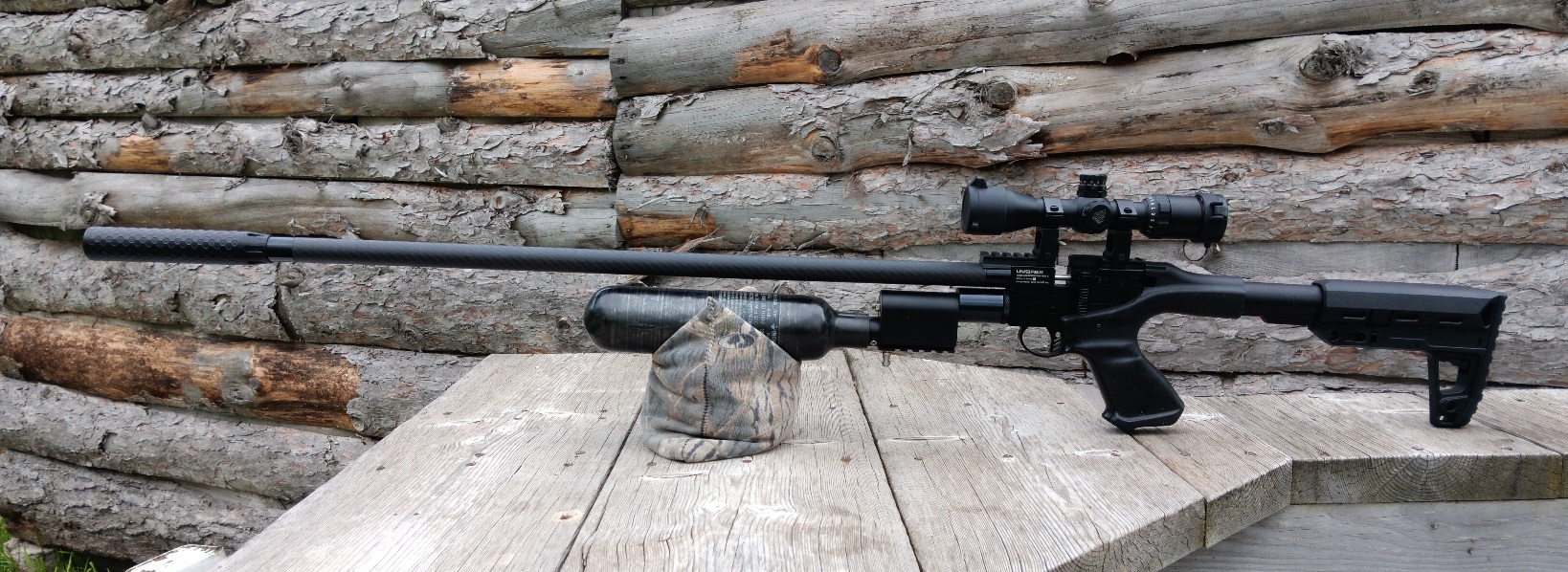

crossman premier hollow point 14 grain mostly.. but it does well with jsb 18 grain round nose, honestly I can't tell any difference between the two with this pistol at 10-50 yards..I also shoot jsb jumbo monster redesigned 25 grain pellets and they hit much harder but out at 50 yards they are around 6" low out of both the umarex notos and the hatsan velox.
I like the length of the velox a lot better but I like the weight of the umarex notos.. hopefully you can get the air tube shortening worked out, even if we have to get some more air tubes so you can perfect the machining process..
honestly I prefer a pistol 12" or less, I am sure it is why I like the hatsan velox, but I don't appreciate the air gauge on the left side sticking out..I wish it was on the right side so the protrusion is in line with the magazine tray and the bolt.. do you know if a plug is available? and I could machine and thread it to the other side?
also I was looking at the reximix rpa, I think.. wood stock and pr plastic.. wondering if a straighter grip is available anywhere as it looks like it is too slanted and likely a straight grip would get it down to around 12" .

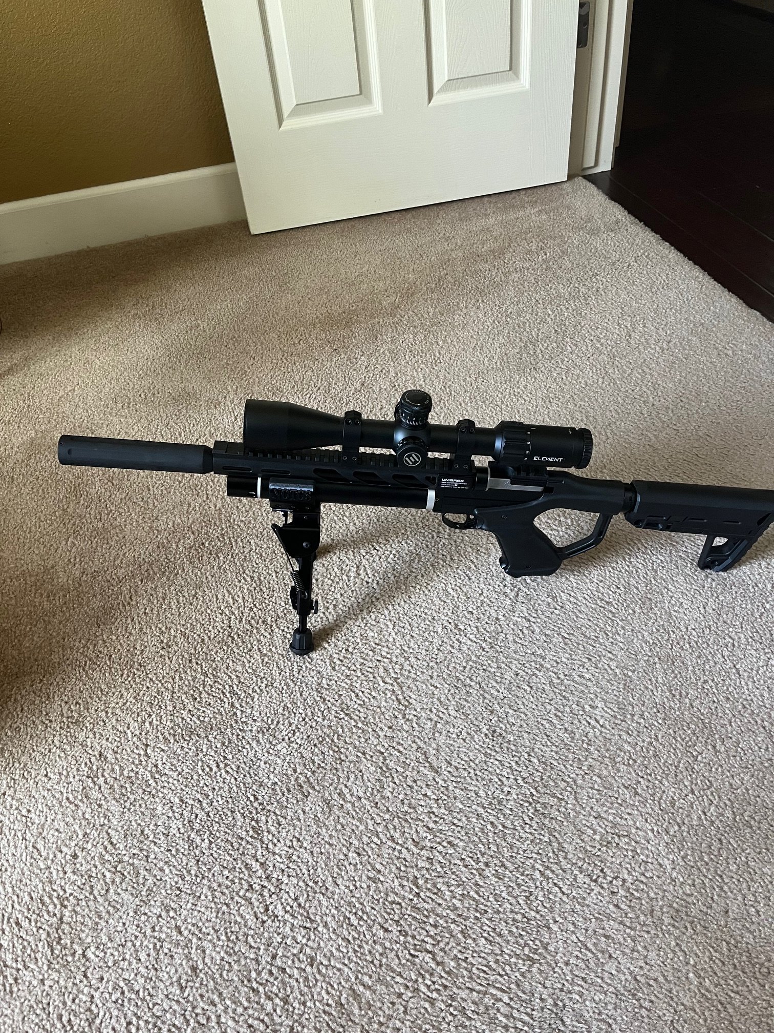

Just received my Notos today! Hopefully I can try it out soon.
I saw some folks commenting on adjusting the tightness of the screw in the magazine to make it work better. Sounds like too tight or too loose can be an issue.
I now understand why people complain about the trigger! What do people do to improve it? Only lighten up the set screw? Or are we doing additional mods?
I had issues with the factory mags. They were stiff going into position and I’d often insert them to far. They have both loosened up going into the breach and the magnets click when they slide into position.

I spent quite a bit of time (very carefully) to get the trigger to an acceptable level. I used 600 grit and some Arkansas whetstones (being careful to not round the top edge of the sear) that I've used for years on cf triggers. So far it has stayed at 2 1/2# with a smooth first stage and crisp second stage. I'm really liking this little rifle except for the mags. Best of luck on your trigger. 20PPC
