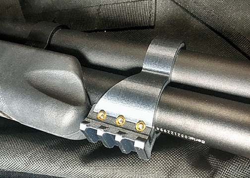

A plastic barrel band with a bolts to snug it to the air tube with an additional slip on band near the muzzle stabilized mine well enough to make it much more consitant.
Where did you find that barrel band?
the first one was on Ebay, but I don't think it is available anymore. I loaned that one to another Origin owner, and he offered to buy it from me, so I got one from Buck Rail that is on mine now.
Yes, it says it is for the Avenger, but it fits the Origin just fine and does a good job keeping flex in check.

The one that fixed it had clamping screws. I placed it about an inch from the forearm and bingo!
Maybe the three bolt clamp limits the expansion,( if the unlikely event that tube expands enough to make a change at all), but it also took the flex out of the barrel and shroud.
