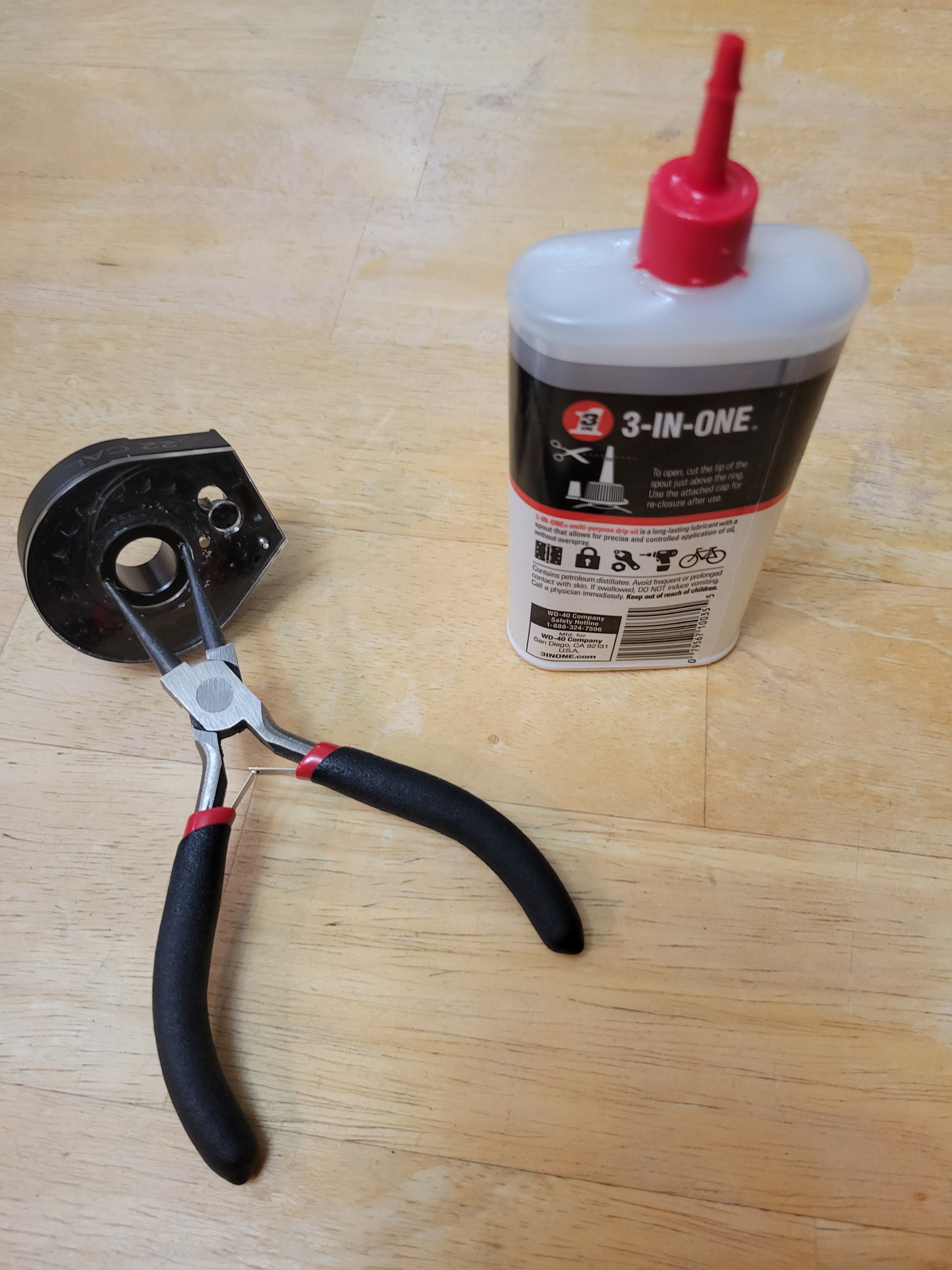

One of the magazines does not have any spring tension anymore and the drum inside the magazine will not turn.
I assume the spring attached to the drum and the bottom of the magazine has somehow disconnected itself.
Does anybody know how to fix this ?
I cannot figure out how to disassemble the magazine.
There is no screw .
There isa disk with 2 slots, likely for a spanner wrench.
I seem to have fixed it.
The issue is too much friction between the internal drum and the top and bottom of the magazine.
I could not open the magazine.
I jiggled left and right the center part using an improvised spanner wrench while adding a small amount of lubricating oil.
The oil need to get between the drum and the external magazine casing.
