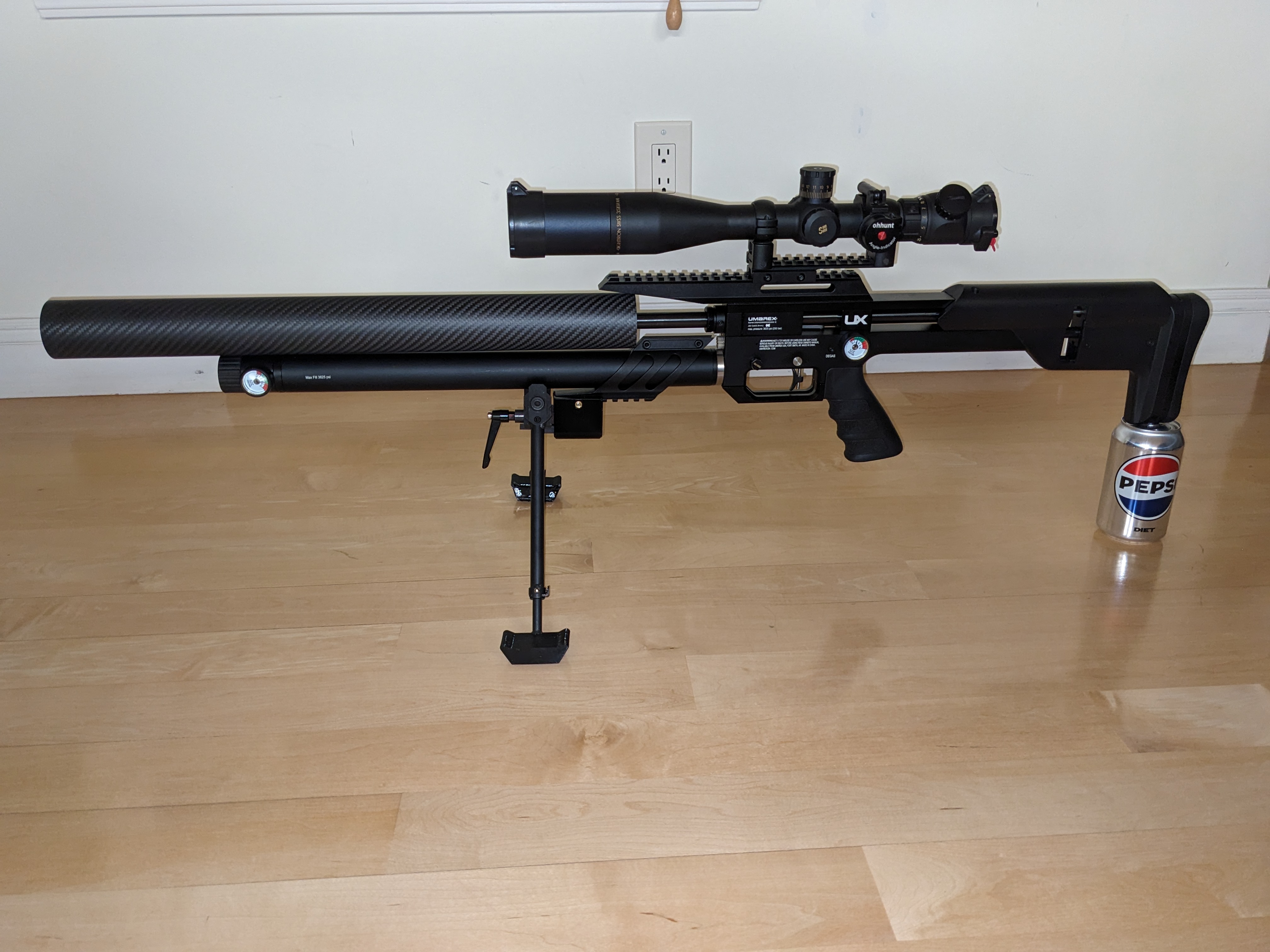

Just got a Zelos in .22. Way too loud out of the box. I 3d printed an insert with 1 cone, 2 Tesla valves and a porous infill section that replaces the end cap and air splitter that screws onto the end of the barrel. Wrapped the barrel with some felt. Much quieter now, but not quite enough. The next step is to replace the stock shroud with a 50mm CF one. That should be real quiet without making the gun any longer than the air tube.

Nothing a 50mm replacement shroud can't fix! I just received the 50 mm tube today I haven't fitted it with the parts on the breach end cut it to length yet but will do in the next few days. Work in progress.
