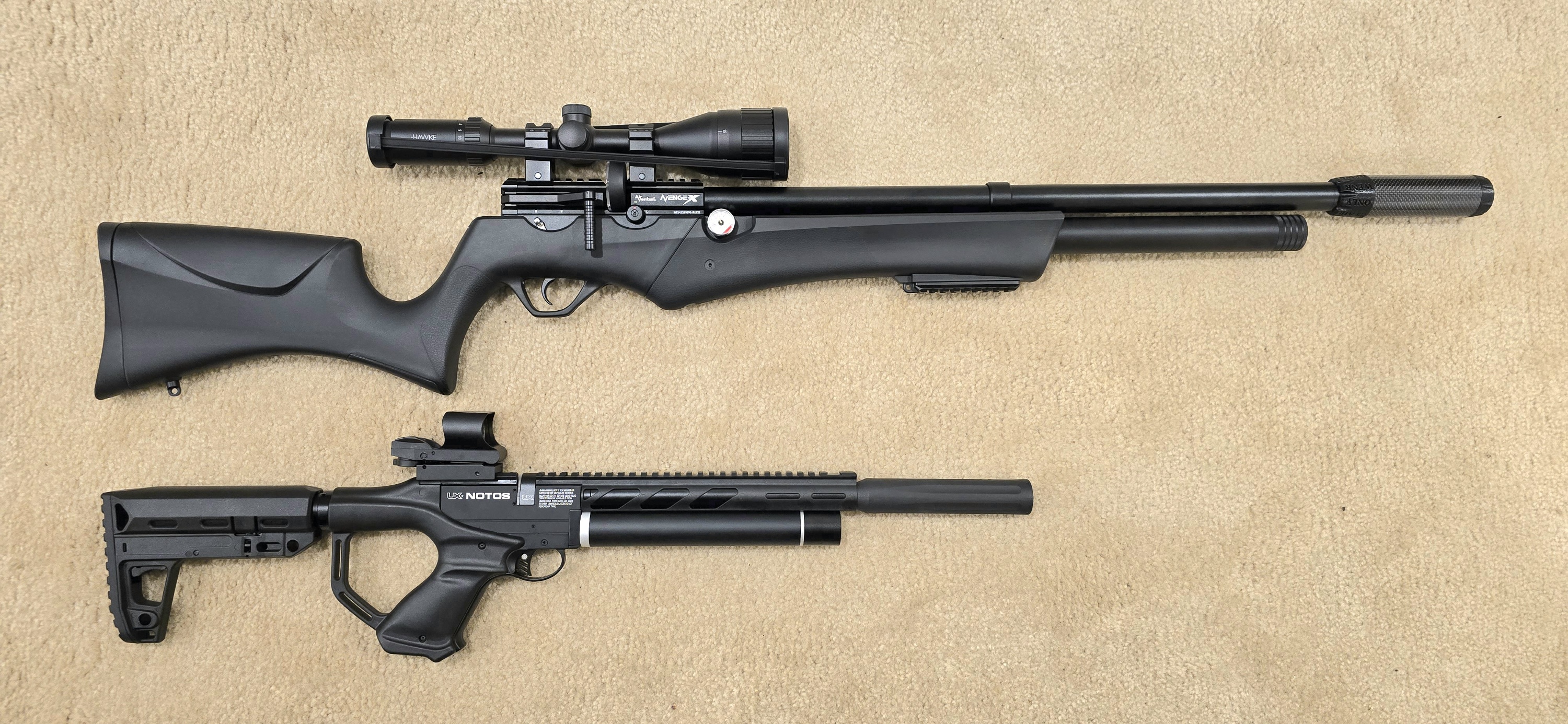

With a small moderator, the Avenge-X is a bit over 4ft long, better suited for the bench, it's quite clumsy. It absolutely dwarfed the Notos. :ROFLMAO:😂
That is a long rifle.
I have the original Avenger and it seems to be just as long.
I like mine quiet so I have 6-8" moderator which makes it 50"+ long.
