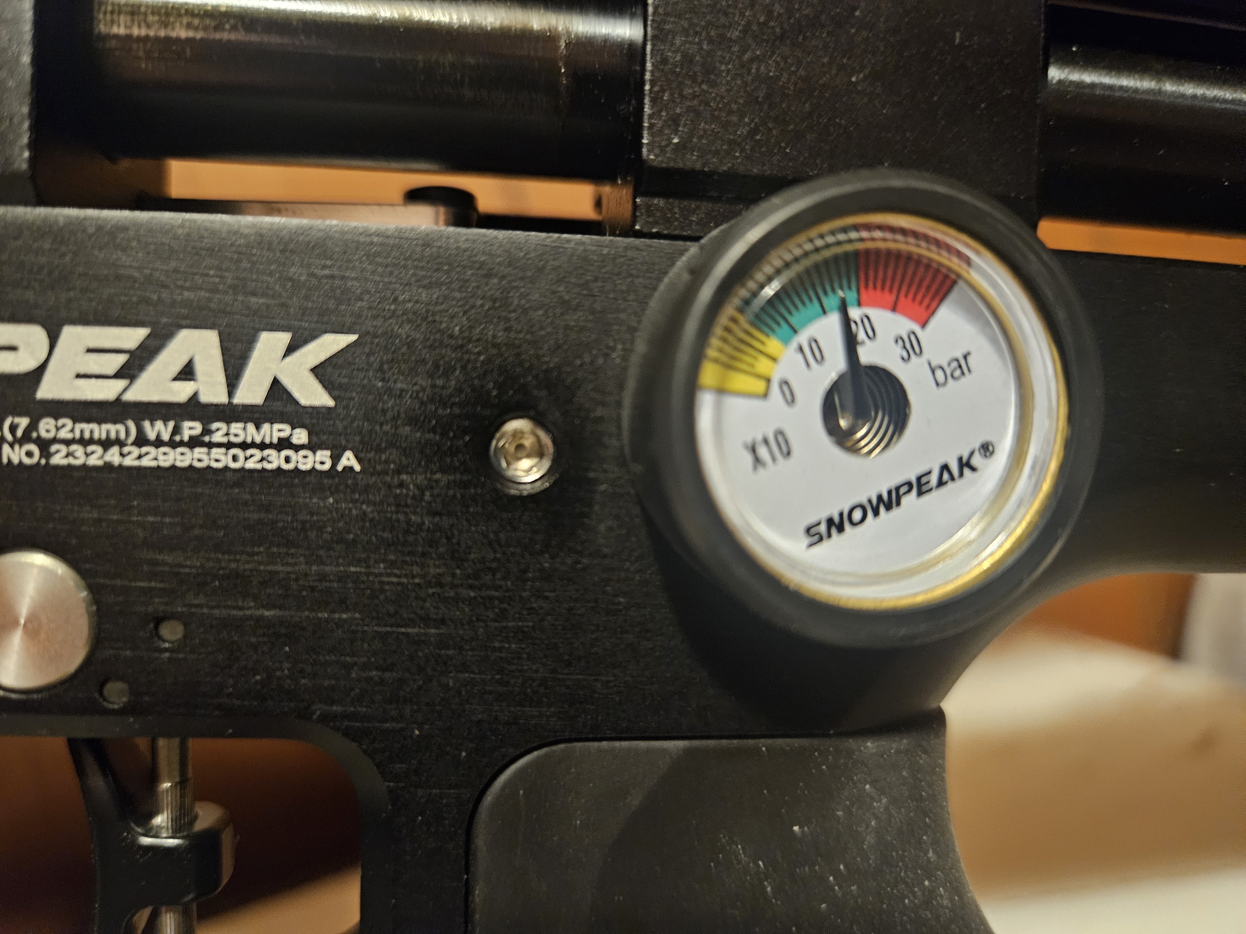

I guess this little hole is for the regulator to breathe?

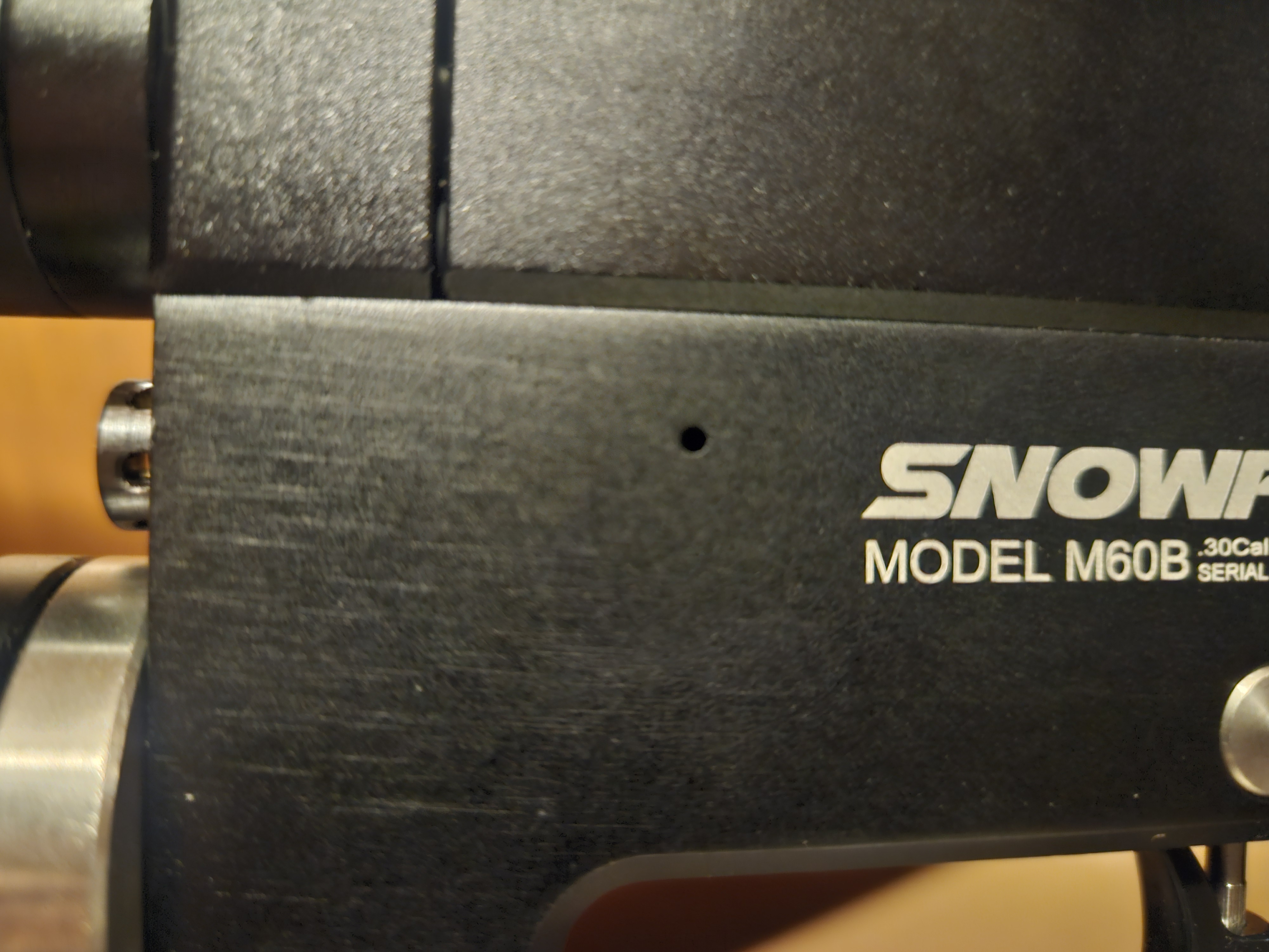

Also, what's this set screw for? A vent?
Reactions: Firewalker

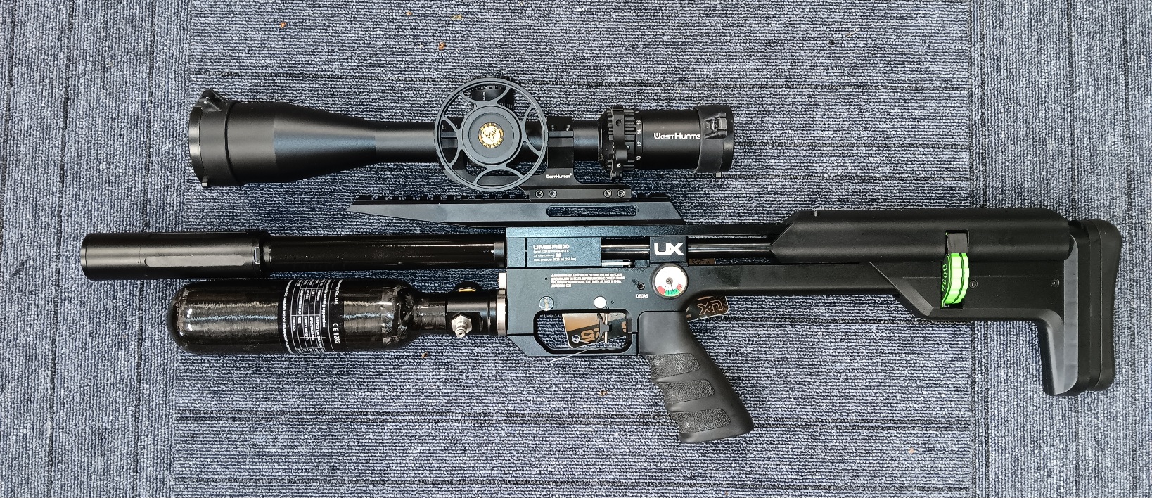

Do you have the weight with the carbon fiber bottle? If it is the same weight or lighter... a CF bottle may be the way to go.
Zelos air tube is 22.6 oz.
.42L Carbon Fiber bottle is 18.4 oz.
.36L Carbon Fiber bottle is 15.2 oz.
More air, less weight, no suicide-foster fitting!
Now that is convincing. The .36L CF bottle will probably get more shots too.
Its just a 250cc tube, a 220cc bottle is almost as large and the 360cc bottle is almost a third larger and the 420cc bottle is almost 3/4 more air!
All three still weigh less than the tube.
