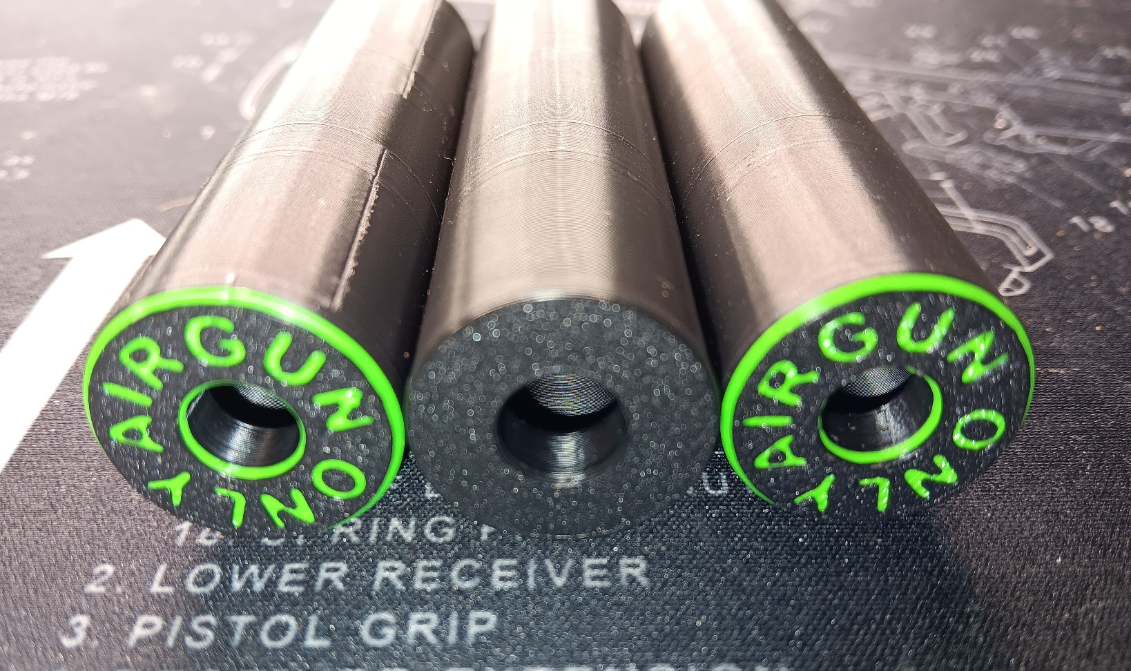

O.90" ID X 3.38" deep. I'm evaluating some as we speak.
