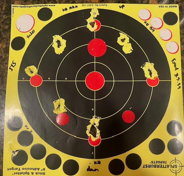

Thanks for that input. That isn't a bad idea. But I agree, 1, 4, 6 were the tightest groups. I think I am going to leave the B3D baffles in for a decent group and the most compactness. Hopefully my next hunt, I'm not scratching my head half the hunt.

I shot a few 5 shot groups and it seems the Zelos really likes the .25 JTS 25.39gr (West group & South West group) at 920fps and the .25 H&N Barracuda Hunters 27.47gr (North East group) at 850fps. They are pellet on pellet at 15 yards. I tried the .25 JSB Exact King Heavy MKII (North group) at 800fps and the .25 JSB Exact King Heavy (South Group) at 800fps and both had 1 flyer above the group. JSB Hades North West. JSB Exact 25.39gr is east. Looks like I'll be getting more JST DC and H&N BH.
