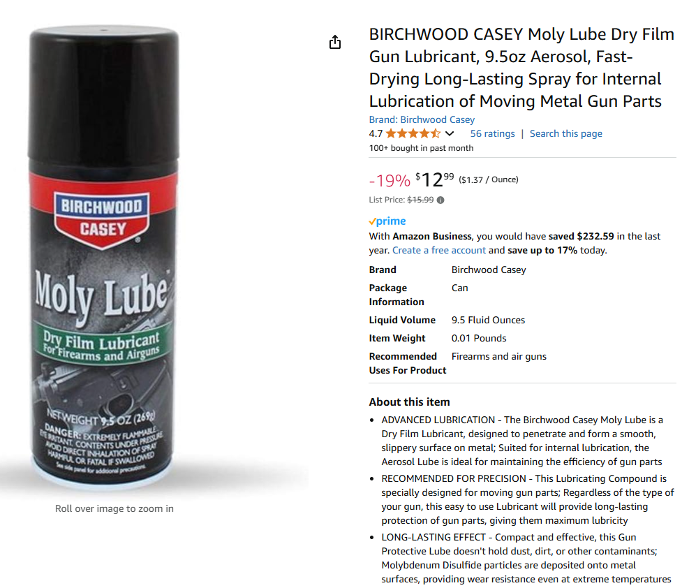

Thanks for the info. Still new to this hobby but I'm learning! Which Synthetic oil and is this the moly gun grease you're talking about?
Reactions: Dr. Kralenstein
Ptfe is good stuff too. The Moly is was talking about is something like Liqui Moly or Tufoil. Tufoil also has a gun based PTFE lube.
The moly stuff is good on contact surfaces like sears and triggers, and the slide of a sem auto. If used correctly and maintained correctly, it won't build up dust like your typical moly grease.
All lubricants will trap dust and debris, just some worse than others. As long as you clean them periodically, it should turn into rubbing compound lol.
Moly grease for moving external parts. Silicone oil for internals for the o-rings and poppet. A drop or two in the fill port and then hook the compressor/pump up and it'll push the oil in and coat surfaces. Silicone oil on the bolt and barrel seal o-ring.

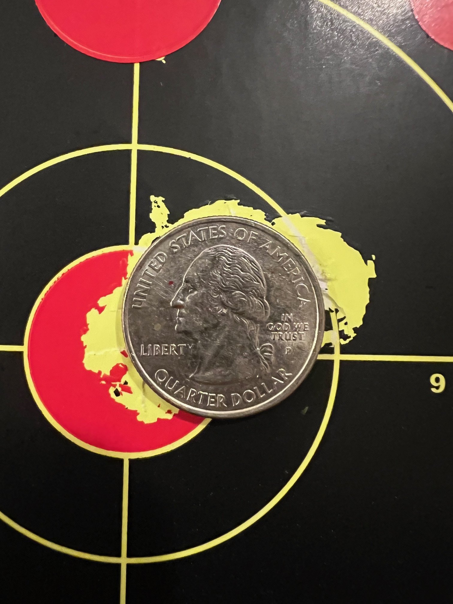

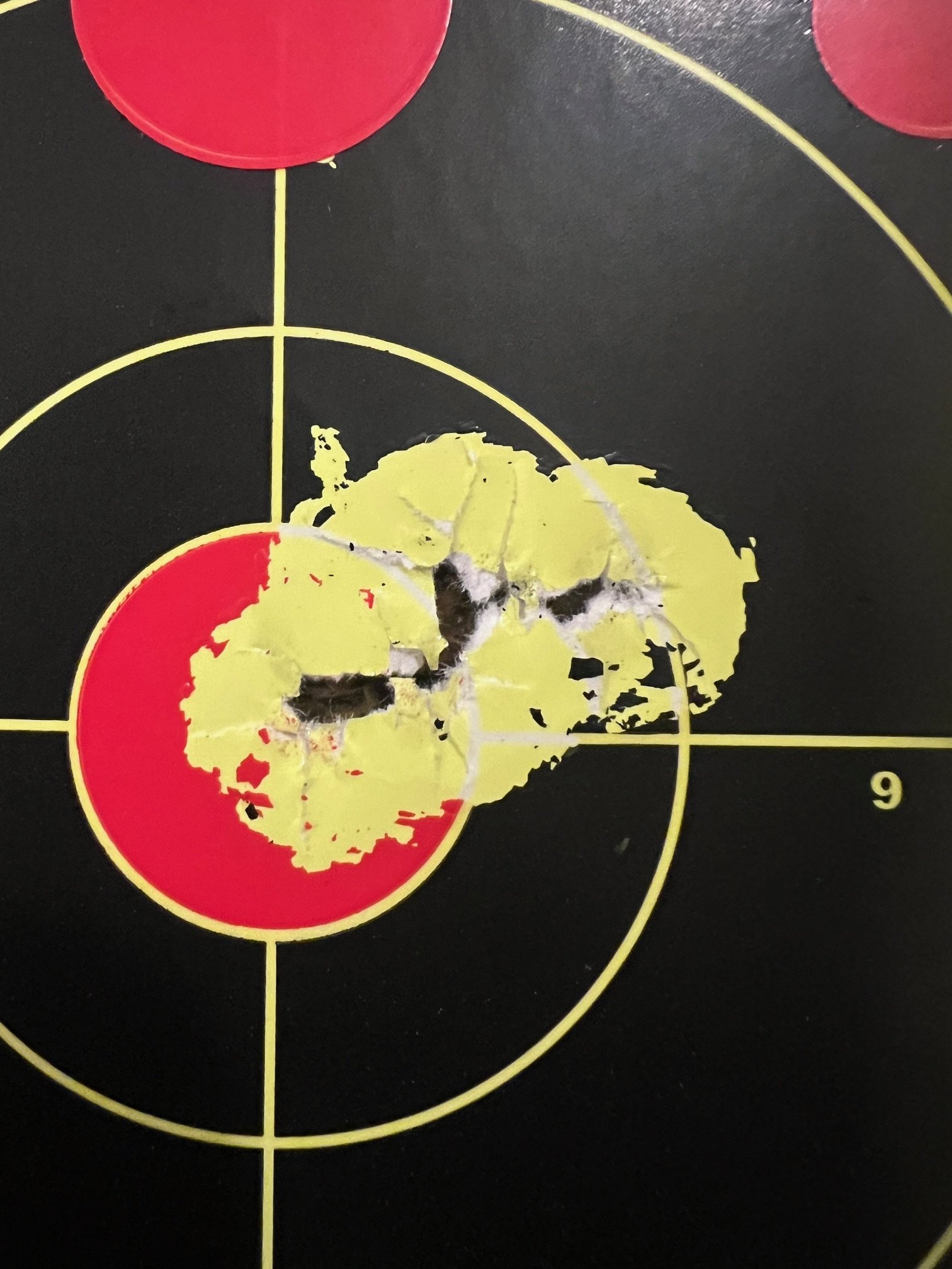

So I took the Zelos to an indoor range. I sighted in at 25 yards. I shot at 50 yards and it's pretty dead on still. I honestly didn't try too hard at 50 yards due to the other shooters and just didn't expect this good of a group. But I'm ok with it. I'm happy with the 50 yard group. I guess I should have shot at 30 & 40 yards to see if it's still shooting dead on or if I'd have to hold at those ranges. Bottom group is 25 yards. Middle big red dot is 50 yards. Shooting .25 JTS 25.39gr at 915fps.

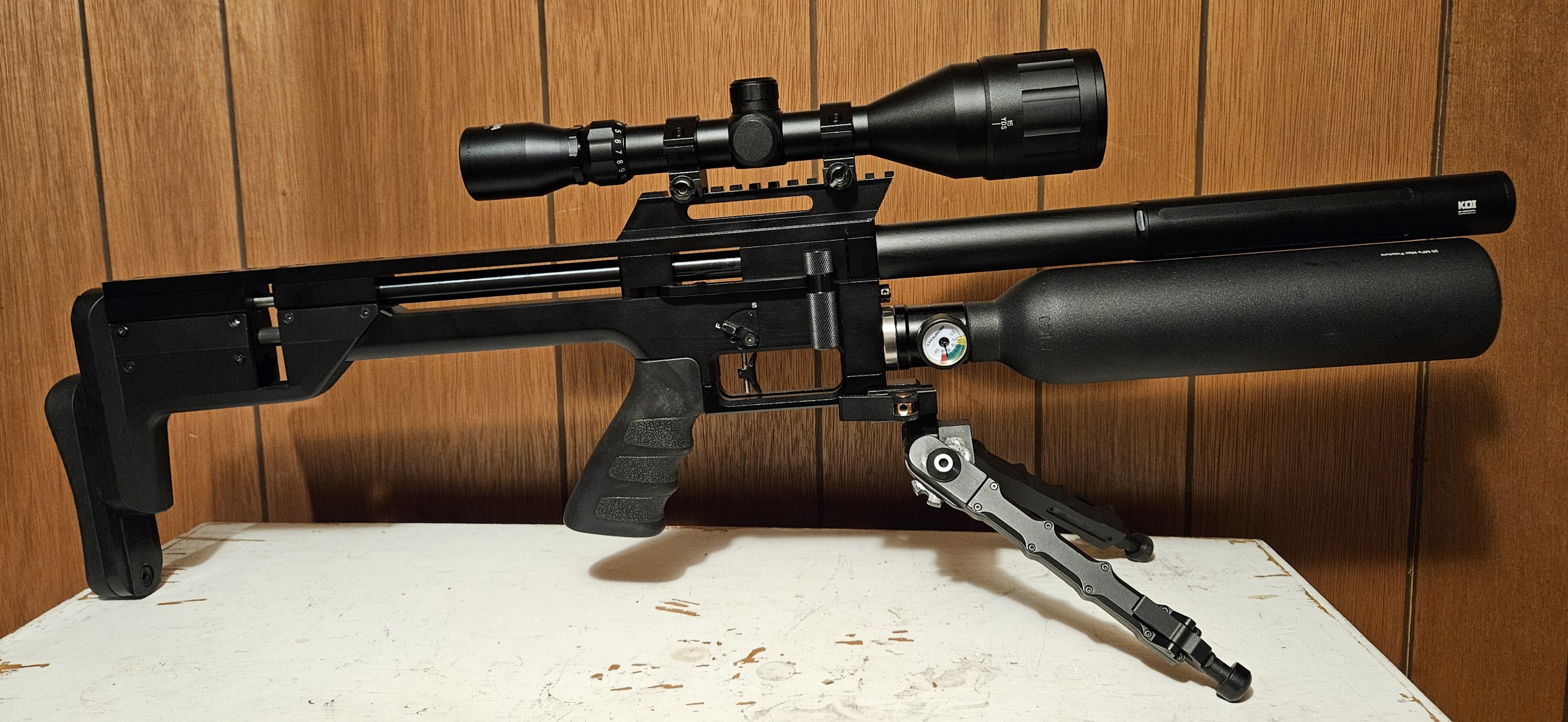

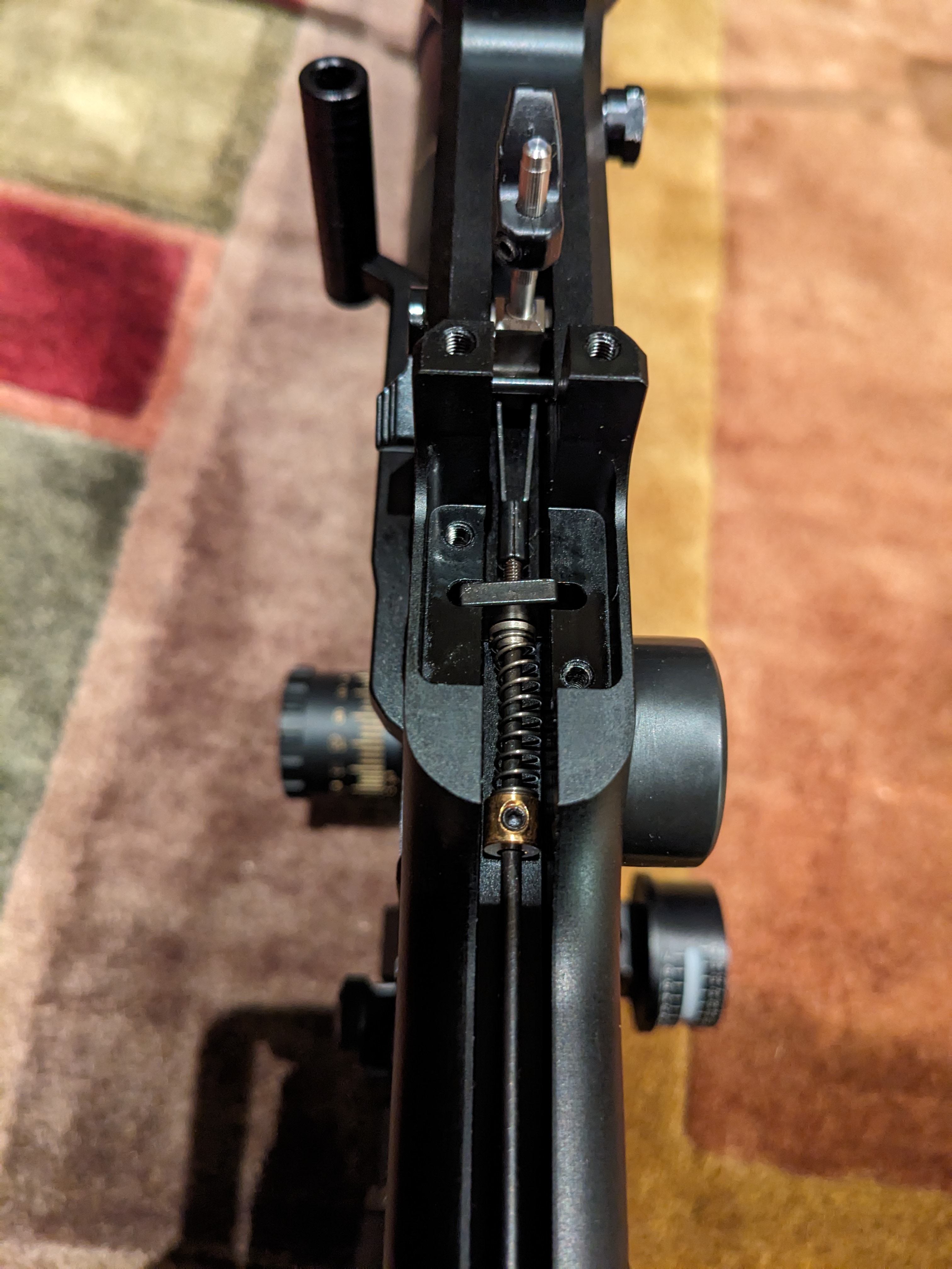

This is how you can adjust your first stage trigger pull. Remove the hand grip, trigger guard, and another block with two screws. Then you give access to a spring compressed on a rod. Change the compression to change the 1st stage trigger pull. Mine was said way higher than any other gun I've ever used.
Now I wish I knew a way to adjust over travel.
Nice!
