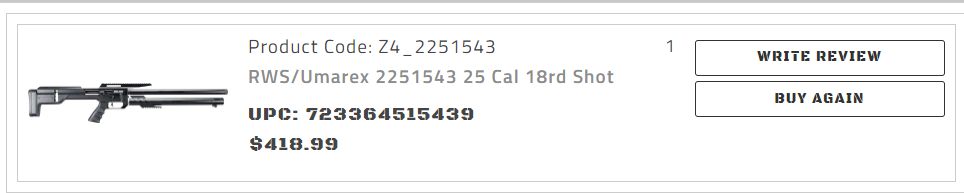

Umarex Umarex Zelos
What does RWS mean? Is this another manufacture? If not, why would it be RWS/Umarex?
