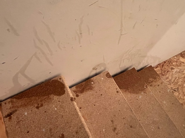

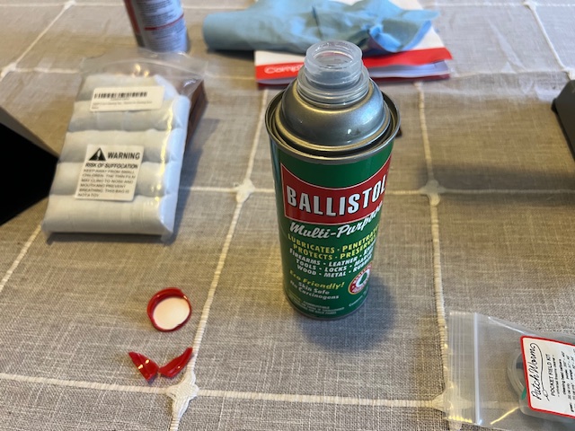

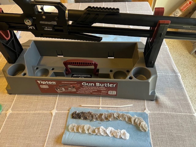

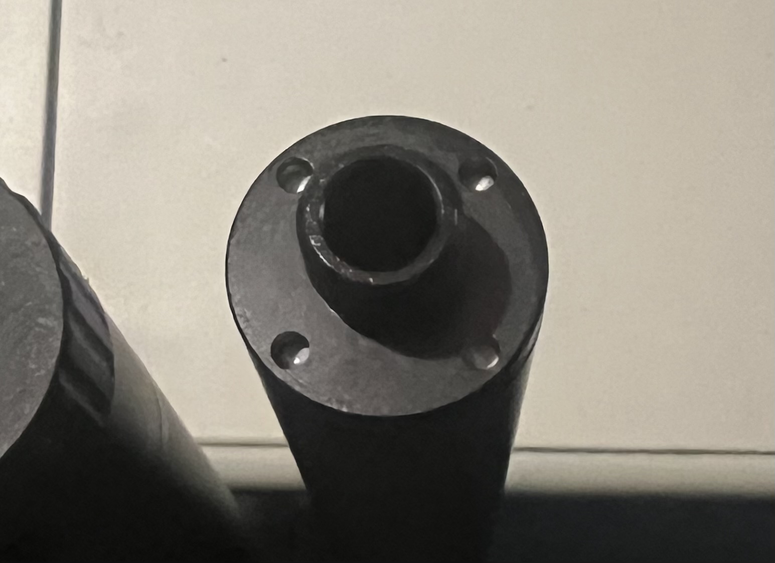

I received my Zelos today. I was over excited and went down to my basement to get some cleaning equipment. I quickly ran upstairs and dropped my ballistol can on my unfinished stairs and broke the cap. :( However, I did run a few patches through it until it was clean. After cleaning, I filled the Zelos and my reg was set to about 2300 PSI. Shot some JSB.25 26.54gr Hades at 940 fps. Dropped the reg to 1900 PSI and now shooting 880 fps. I did try to remove the end cap but it's screwed on pretty tight and it unscrewed the part that has the 1/2x20 UNF. I got it out but was wondering what the tool is called to tighten the muzzle 1/2x20 UNF part (See attached picture IMG_0354).
I received the Baffles for the Zelos from Bravo3D. I installed all 4 baffles and shot a few test rounds. It reduces the noise by a lot. It makes the Zelos more indoor friendly when shooting. It has improved my FPS by 10-15 shooting 26.54gr JSB Hades .25. I had the gun set at around 880fps. Now that I installed the baffles, I am getting 890-895 fps. I guess the 4 extra baffles helps the compressed air push the pellet a little bit more. At this time, it doesn't seem like it affects the accuracy but I am only shooting at 15 yards.
