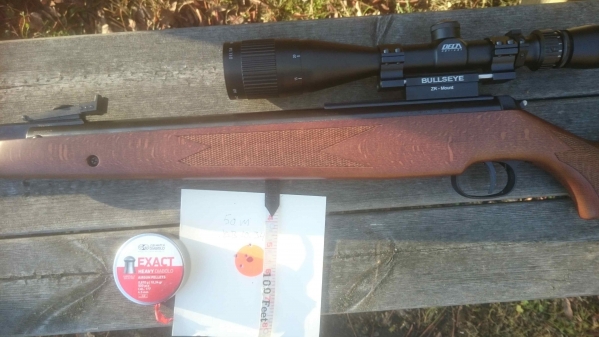

What caliber are you looking for? I have the 350 in 177, it's not an easy gun but i love it for the power and it is very accurate, but it takes time to learn how to handle it, i shoot all my guns from a triggerstick, but the Diana didn't like it, or should i say i didn't know how to do it right, so i shot it from a bench and a sandbag, and she is super sensitive about how you pull the trigger, you have to squeeeeeze it very gently, now after i have shot it some more i can shoot it from a triggerstick and keep the group under a inch at 50 meters, i have not shot with a 34, but i think it's easier to handle from what i have read and seen, and the 350 might be easier in 22 cal also...
