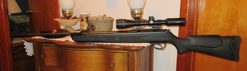

Walther Talon Magnum .22 as in one of these things aka Hatsan 125??
Mine before gifting it to a good friend who likes the higher powered stuff. Shot just short of 24fpe and best groups I ever managed were 3/4's of an inch at 30 yards and that was on a good day. Trying to shoot and humanly, a ground hog at 50+ (let alone 100) considering the shot placement needed? Taking everything that needs factored in to even try and there are any number of very capable shooters here who very likely could, I'm not one of them and why I have a couple 40fpe PCP's here for shots like that.
