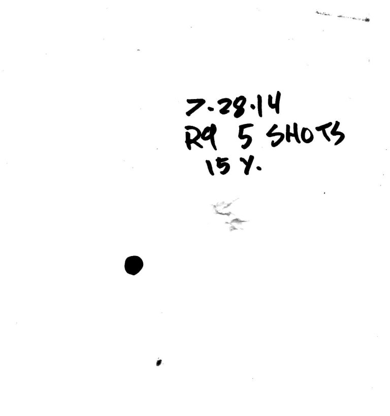

generally .. out of the box accuracy will be better with a fixed barrel 'anything' over a break barrel ...a 760 pumpmaster shooting bb's out of a smooth bore is more accurate than most break barrels lol ...
Riiight! Show me a target.....
