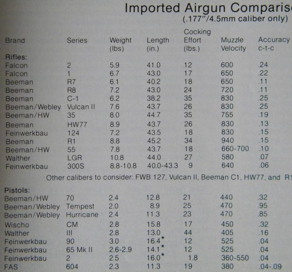

I've never checked the stats personally but this seems pretty relevant to the question.
The shooter has nothing to do with the inherent accuracy of any gun despite the mentioning it does. A gun has a certain ability and the shooter has another, the 2 are not the same and can easily enhance or reduce results pending what gun is used. It seems many forget or have never seen the old Beeman guides that mentioned CTC accuracy of numerous pistols and rifles clearly showing some guns are more accurate than others. Of course variables come into play (pellet used, break in period, etc.) aside from that there are certainly more and less accurate guns. This usually becomes very evident when looking at numerous tournament results (FT, EBR, 10M) over a several months or longer and over a large area with many different shooters. It certainly does seem though in most competitions break barrels either are not even being used or are out of the top 3 places.
Sorry for the really dumb question, but what does "c-t-c" mean? That list is a great bit of information!
