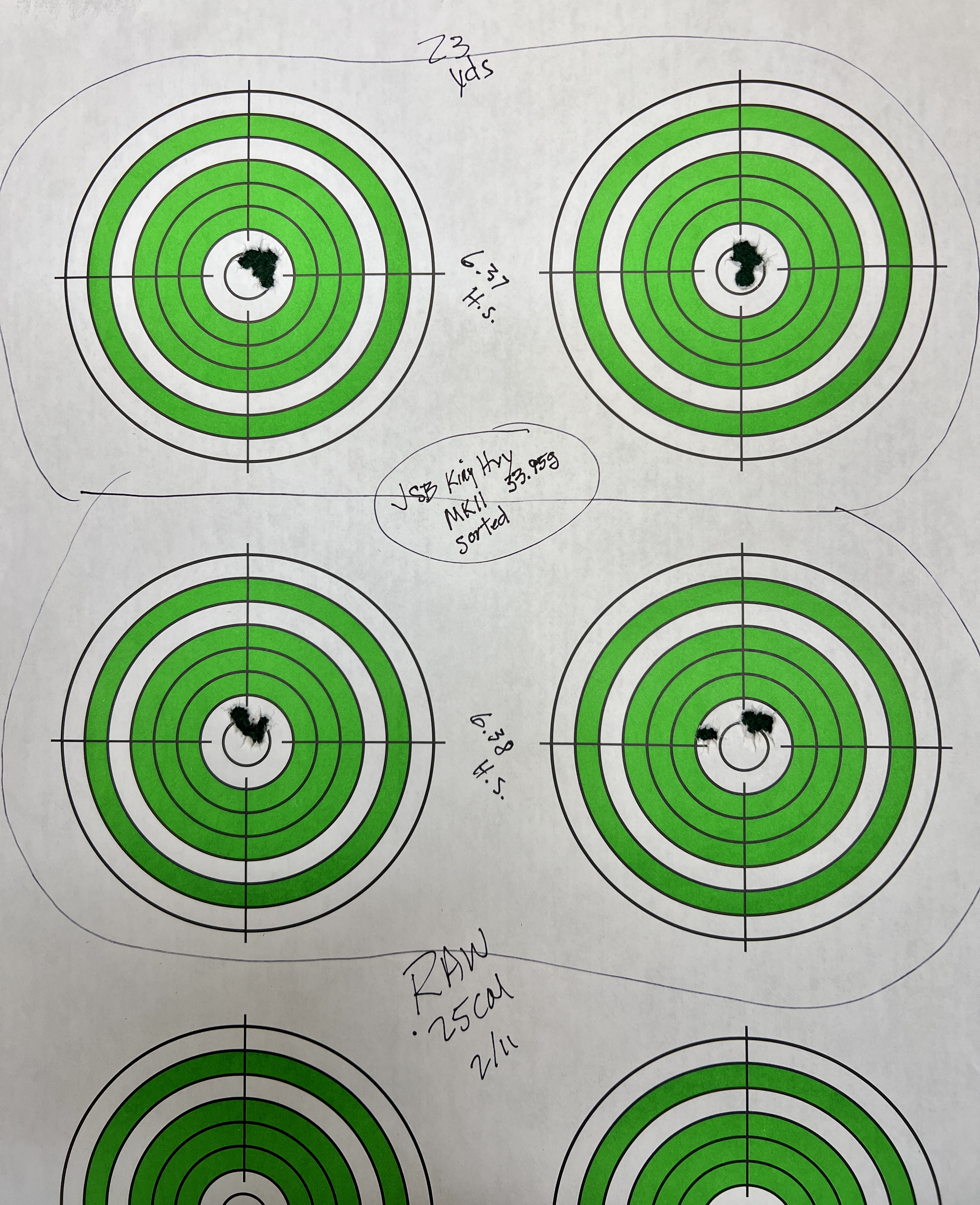

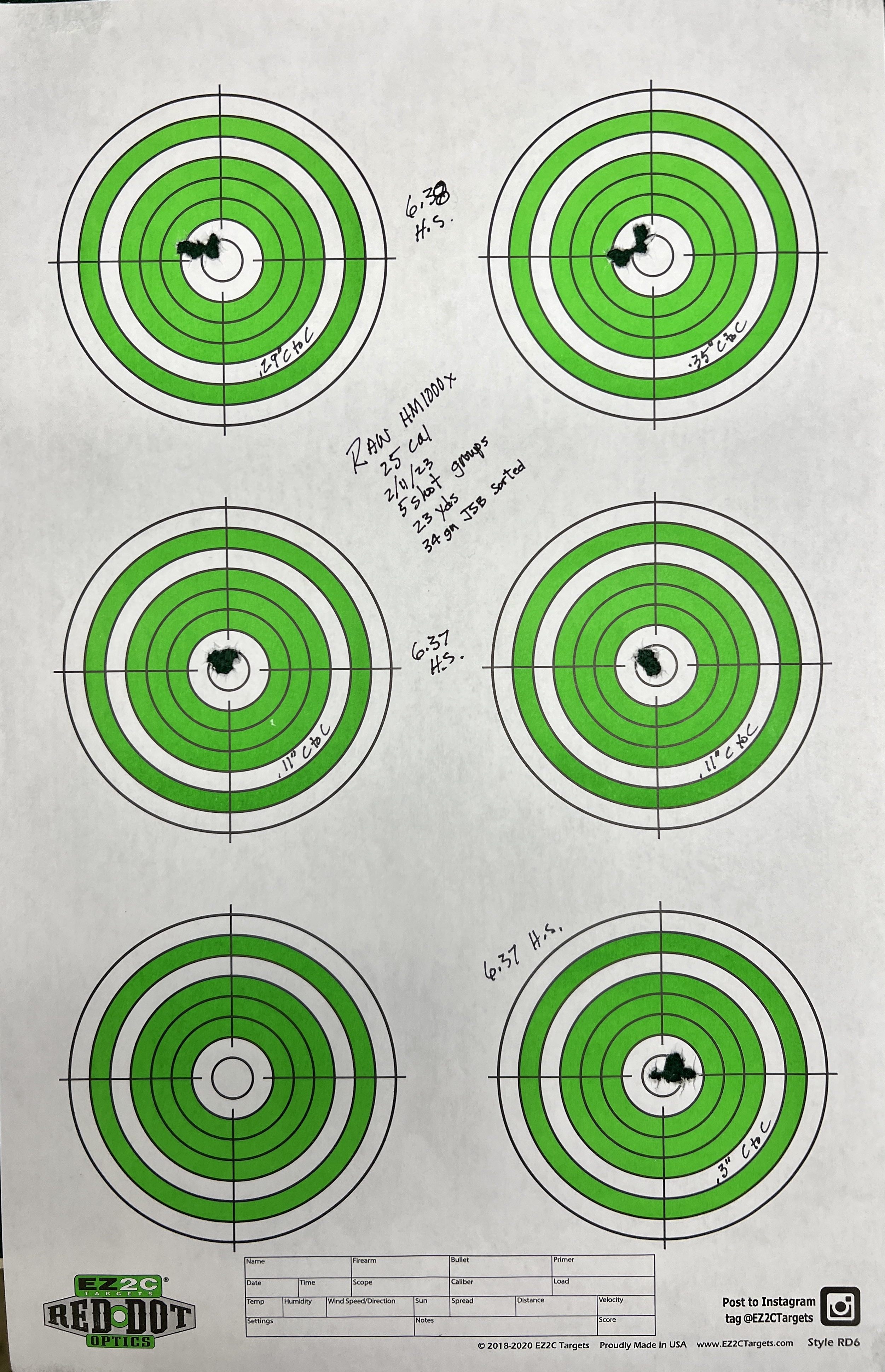

This 25 cal RAW I purchased late last summer has never shot great groups. I couldn't get it to group less than an inch at 50 yards and today I tried it at 22 yards with a couple different head sizes as well as slugs. It shot terrible. Below are a couple targets to show what I mean. If it can't stack pellets at 22 yards, indoors with no wind or other elements, it will never shoot good at 100 yards. Occasionally it will plant a ho-hum group, but no where as precise as my Maverick using the same pellets from the same tin. Think this will have to go back to Martin to figure out where he went wrong with the tune/setup. I am using a March Hi Master 48x scope with No Limits rings.
Following targets are RAW:

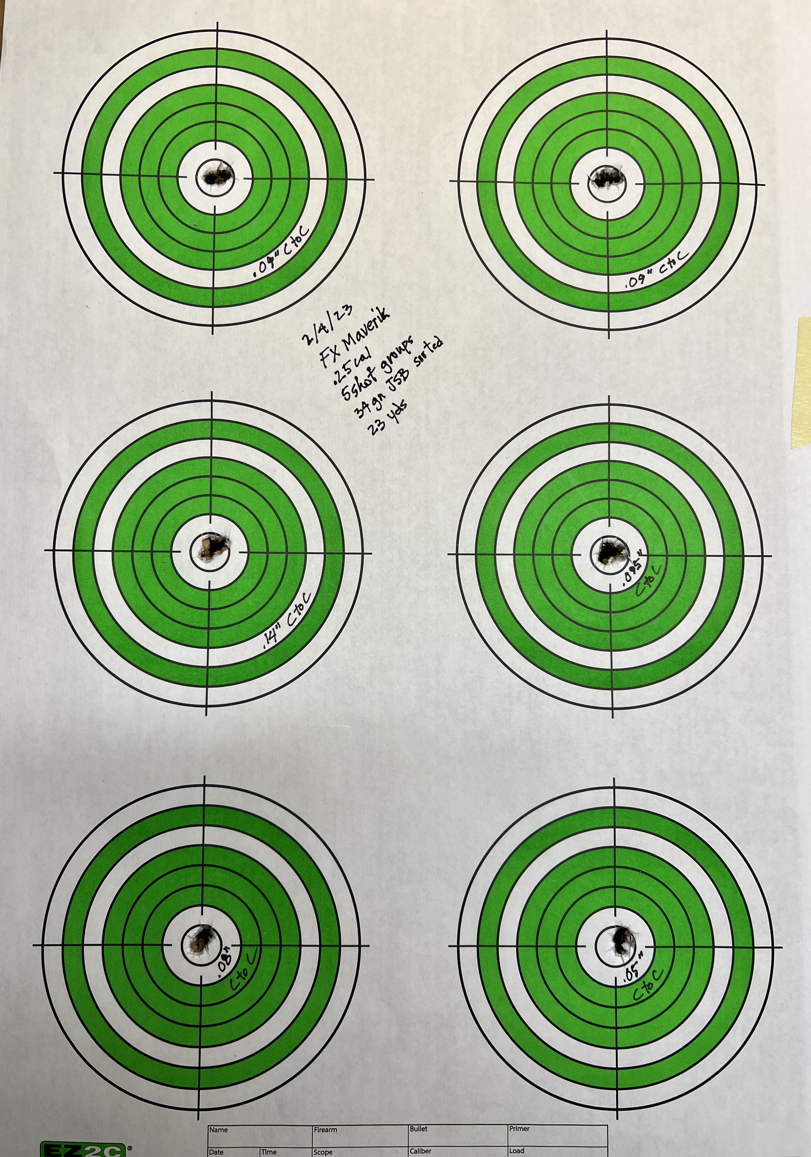

Compare to my Maverick shooting same pellets from same tin:

I religiously clean with ballistal after every 100 or so shots. Let me be clear: I have a RAW in 22 that shoots same hole out to 25 yards. This gun has NEVER shot good groups from day one. Yes 48 power is high power, but unless you’ve tried it at 25, don’t try to advise me to turn down power. My Maverick shoots like the above target all day at 25 with 40x scope. My 22 RAW shoots bug holes all day with a 45x scope.

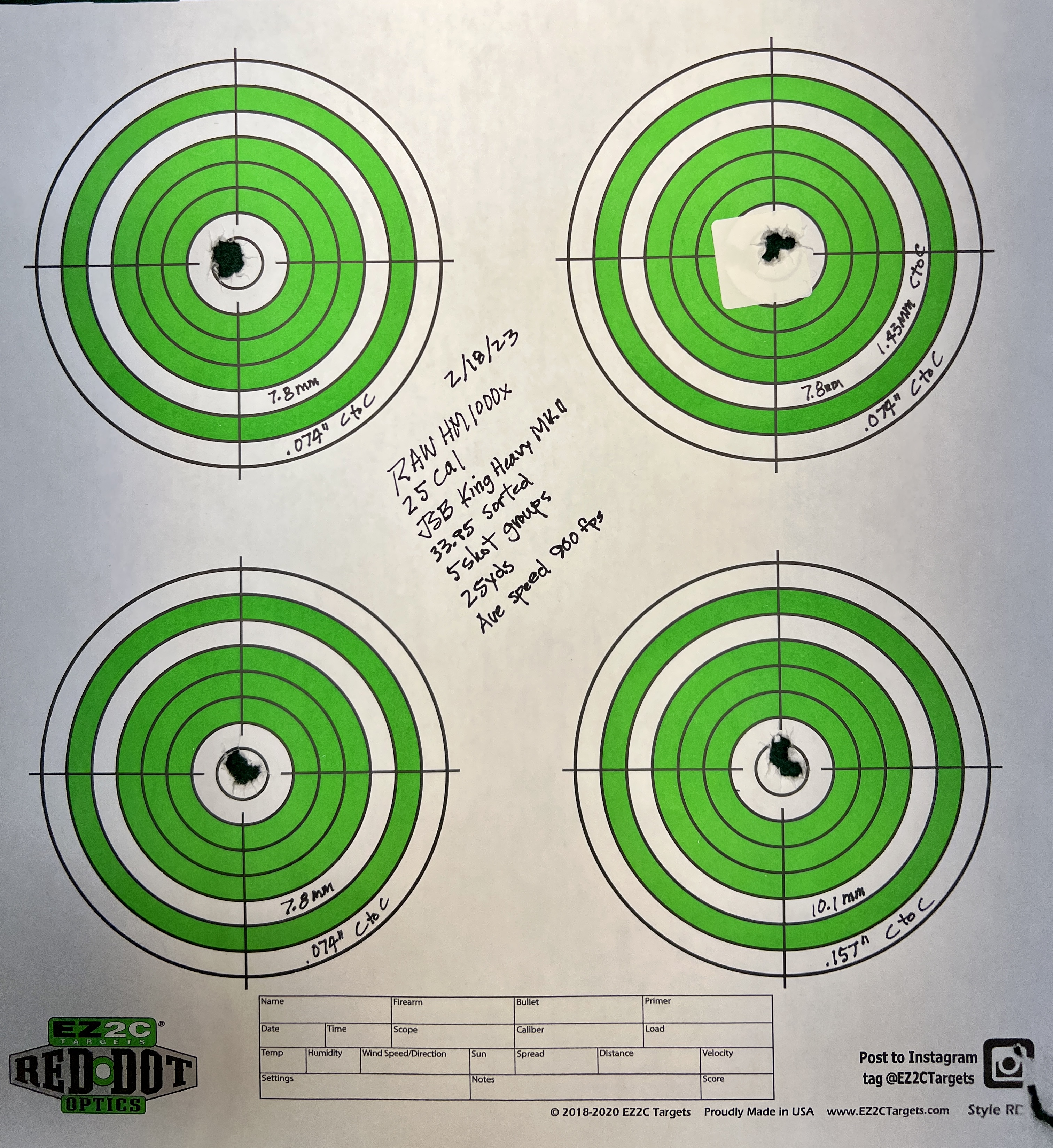

Martin advised me to up the speed on the 34 grain pellets - they were shooting too slow at 875fps ave. So today I upped the power adjuster by about 2 turns and it upped the speed average to over 900fps with a STD dev of 4. I'm sure with dinking around with the hammer spring I can tighten the STD dev and perhaps the groups, but for now this is the consistency I have achieved at 25 yards:
Ross, nice! Have you tried the 25gr JSB's? Your barrel might like slinging things FAST. Maybe try some 25gr @ this tune....
Once I get this dialed for 34 grain, I'll try my 25's. I really want this dialed in for slugs at 100 yards - that's where I'm headed.
Ross, I've heard the .25 platform is less fussy for slugs than the .22 👍.

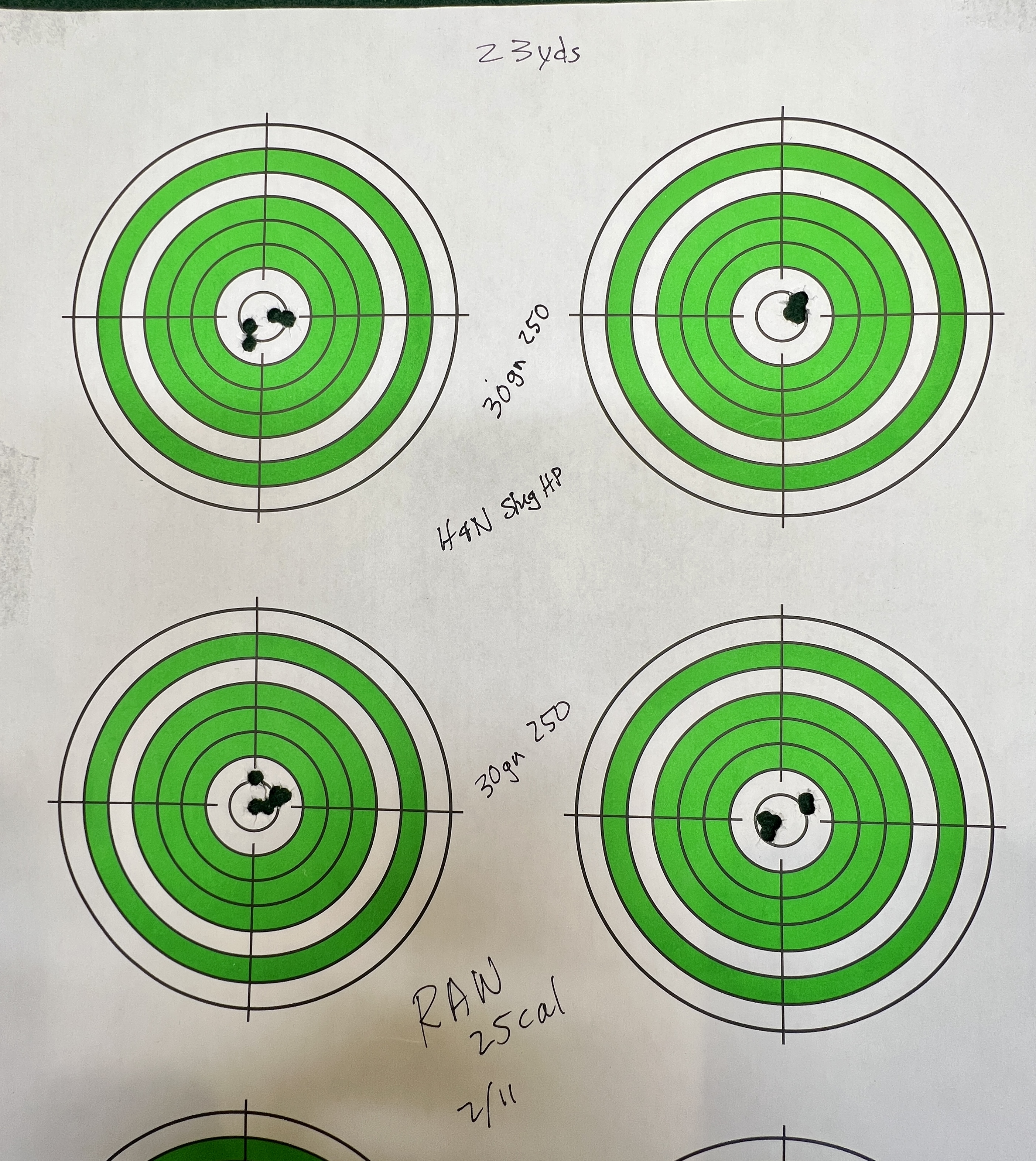

Hope you are right. I was told that the lighter H&N slugs do very well in the 25 cal. We'll see. Here's a target from earlier when it wasn't shooting consistent. Granted this is 25 yards - not 100, but indications are that one of these might do well.
Keep in mind, the speed was low and the rifle wasn't shooting consistent. Didn't try these after I dialed in the power adjuster. I have both 249 and 250.
