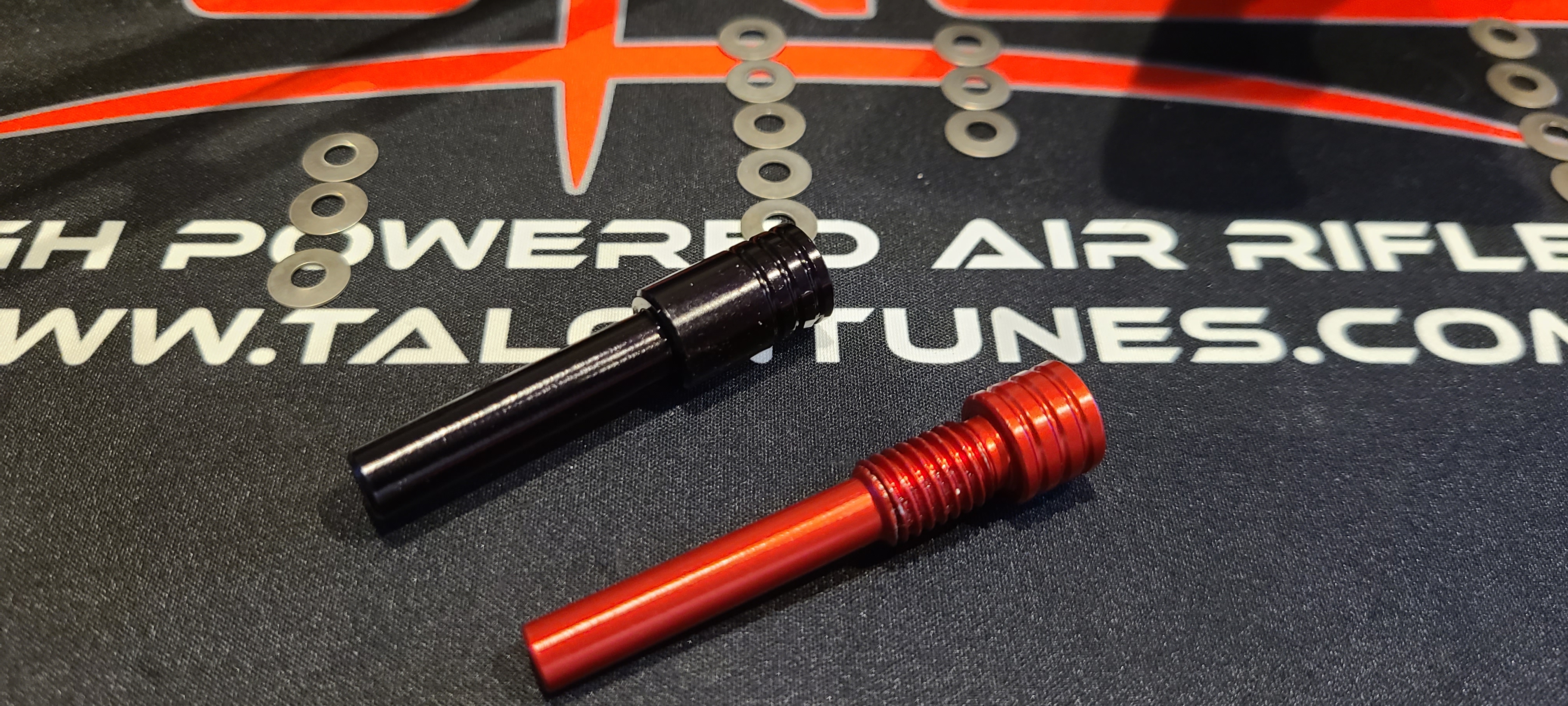

UPDATE 910 Airgun – Regulator Piston Removal Tool O-ring size
I purchased this over price piston tool.
It does not grip the piston.

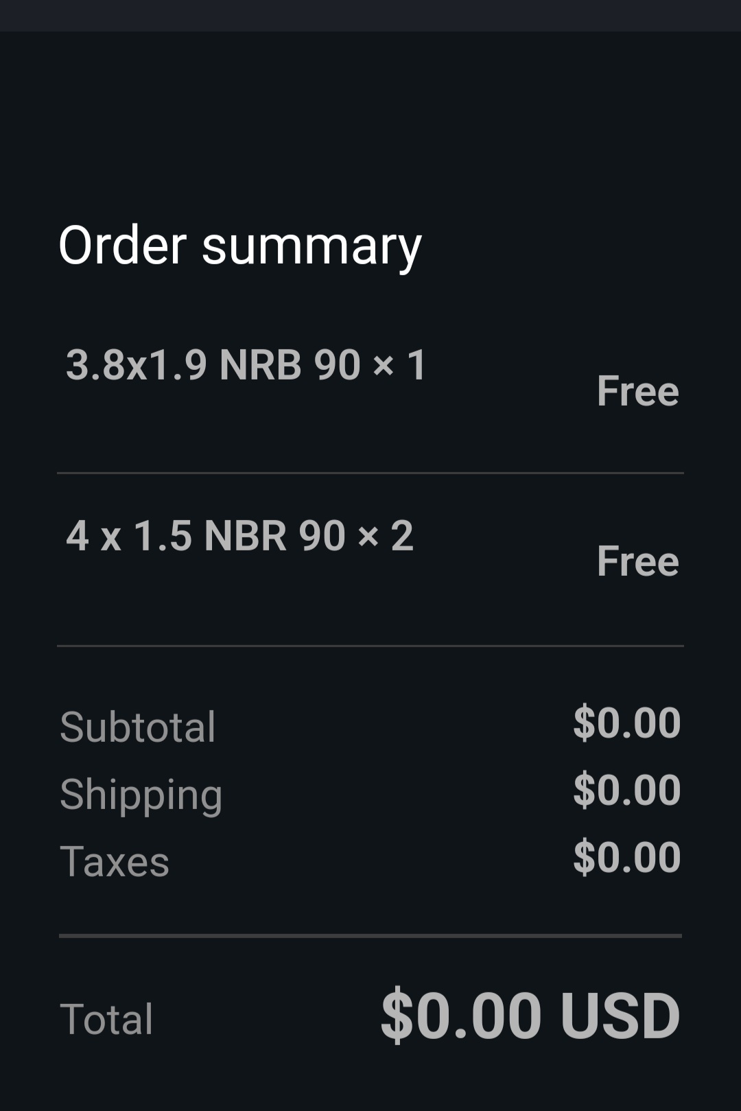

I contacted Newman he said there should be 3 o-rings inside to grip the piston, and to contact Bullet Central where I bought it to get the o-rings.
I have asked both Bullet Central and Newman what size o-ring does it take????
No answer from either.
Has anyone bought this tool, know what size o-rings are needed ?
