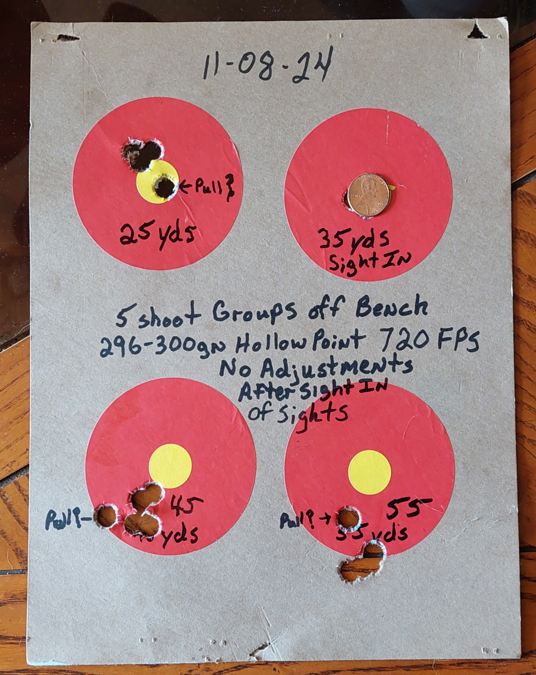

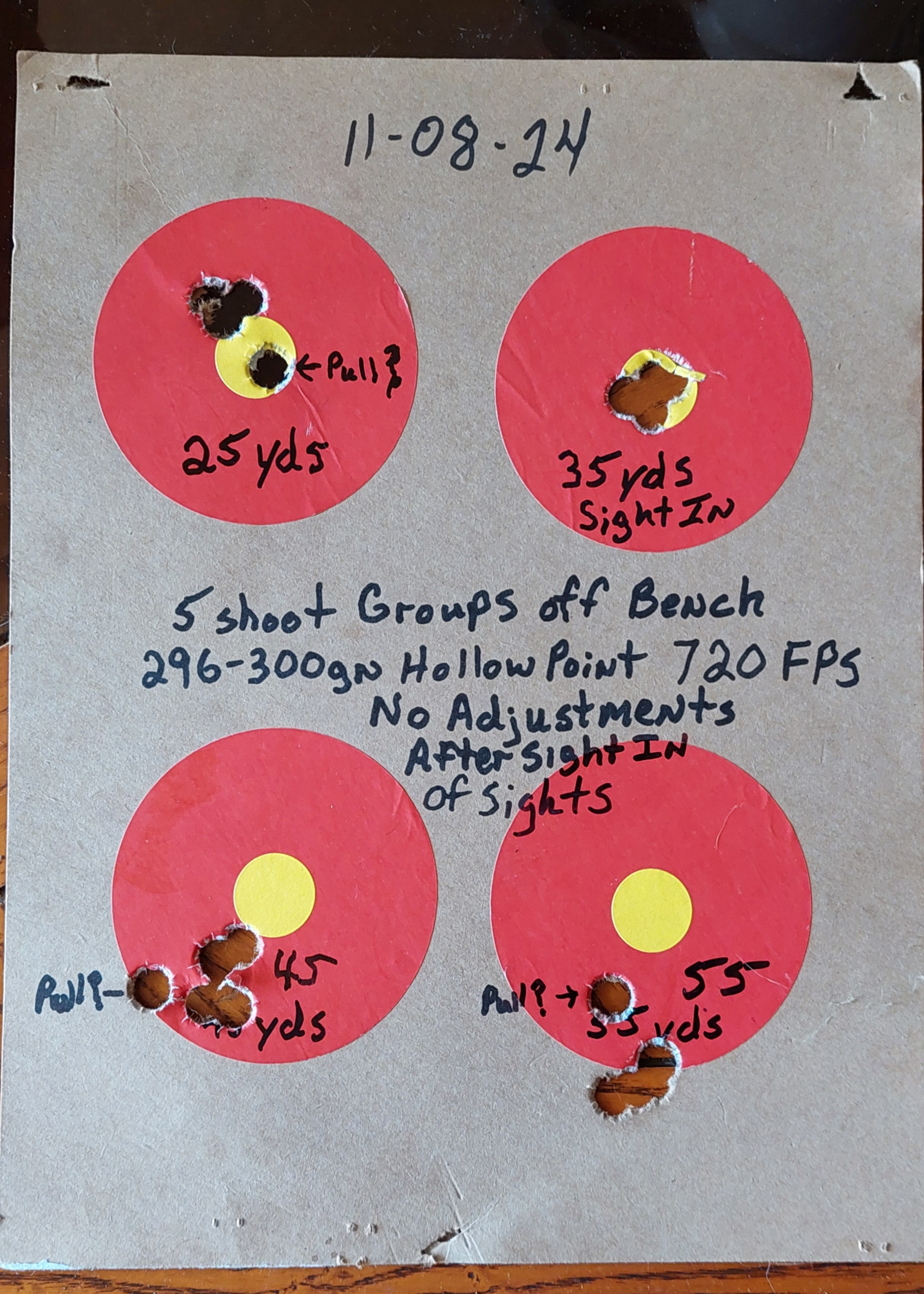

Pic is of after sighting in, 35yds is because that's primary range from blind I'm hunting from this years. Other yardages was quick shots for reference before further shooting to determine scope adjustments for each.
Shooting a NEO .460- 315 mold hollow point slug sized to .459 (slightly filed down hollow points pins due to casting issues, likely my inexperience, but stopped my having voids). And a DonnyFl Ronin.
