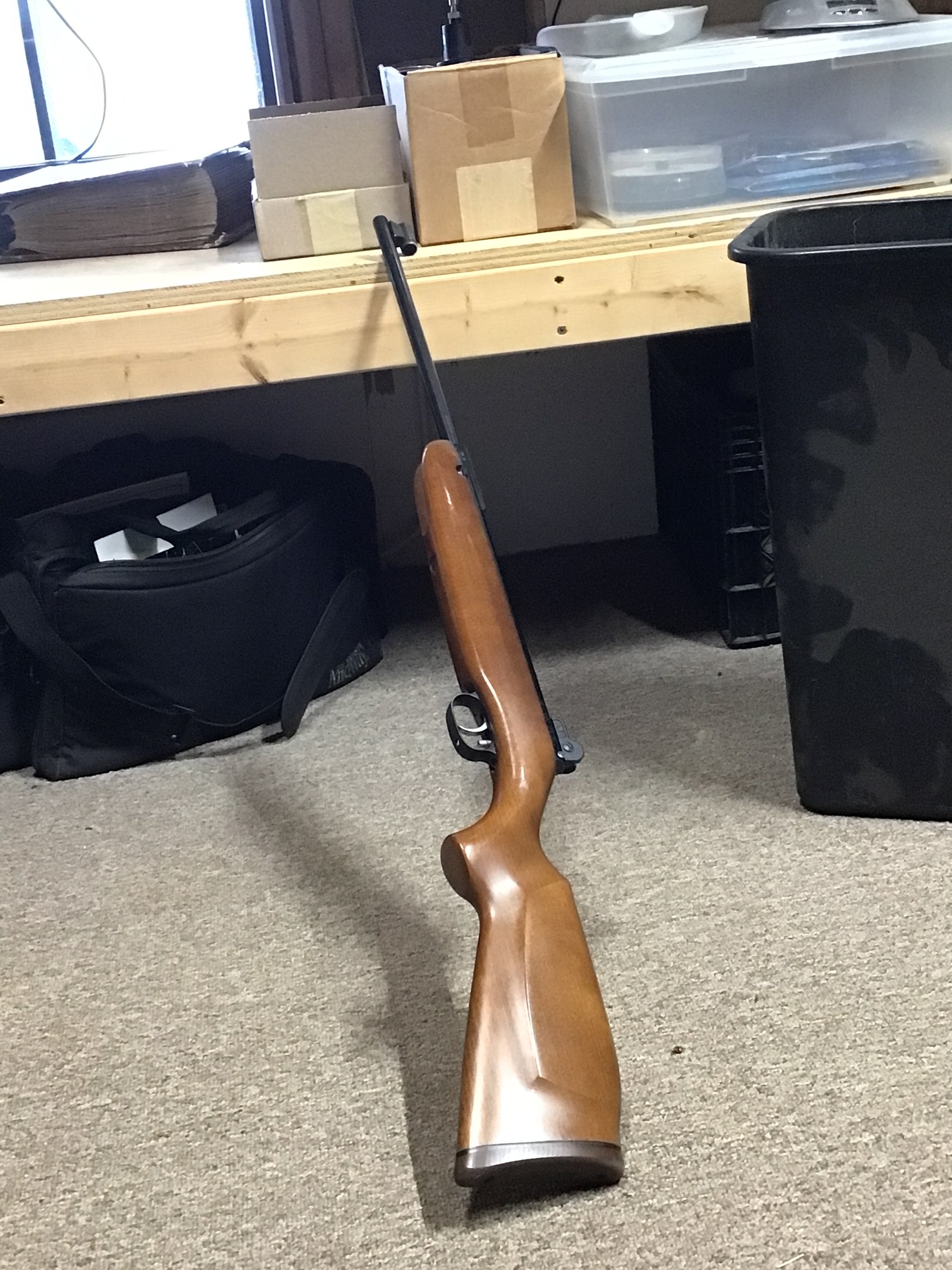

This is the gun that I left cocked for an unknown time. IIRC it was shooting 7.33s at around 710 fps a few weeks ago. After I found it cocked the power was down 30 or 40 fps. Yesterday I chronographed the gun at 666 Avg before setting off to replace spring. I took the gun apart and put a fresh spring in it and it only averaged 685. Not a colossal gain and not anywhere it should shoot with a new spring.
The gun felt jumpier than it should at that velocity. Like it didn't have enough back pressure. I knew something was wrong. This time I took it completely apart and removed the piston. That showed a long score along the bottom compression tube in seal travel. A metal chip got stuck in the seal and carried up and down the tube. There was my pressure bypass.
I cleaned the metal out of the seal, filled the score, honed the tube and reassembled the gun with the old spring and seal. After ten or twenty shots I chronographed it again. A ten shot string went AVG 716, ES 8 and SD 2. Right where it should be. More importantly the gun has a nice smooth cycle again.
Apparently leaving the gun cocked perhaps for weeks didn't hurt the spring at all. It must have developed that score after I chronographed the gun weeks ago. I have no idea where the metal chip came from. This gun is 8 years old and probably has 100k shots on it. Maybe it's from the spring that's not very old.

Glad you got it sorted out, you'll sleep better tonight.
