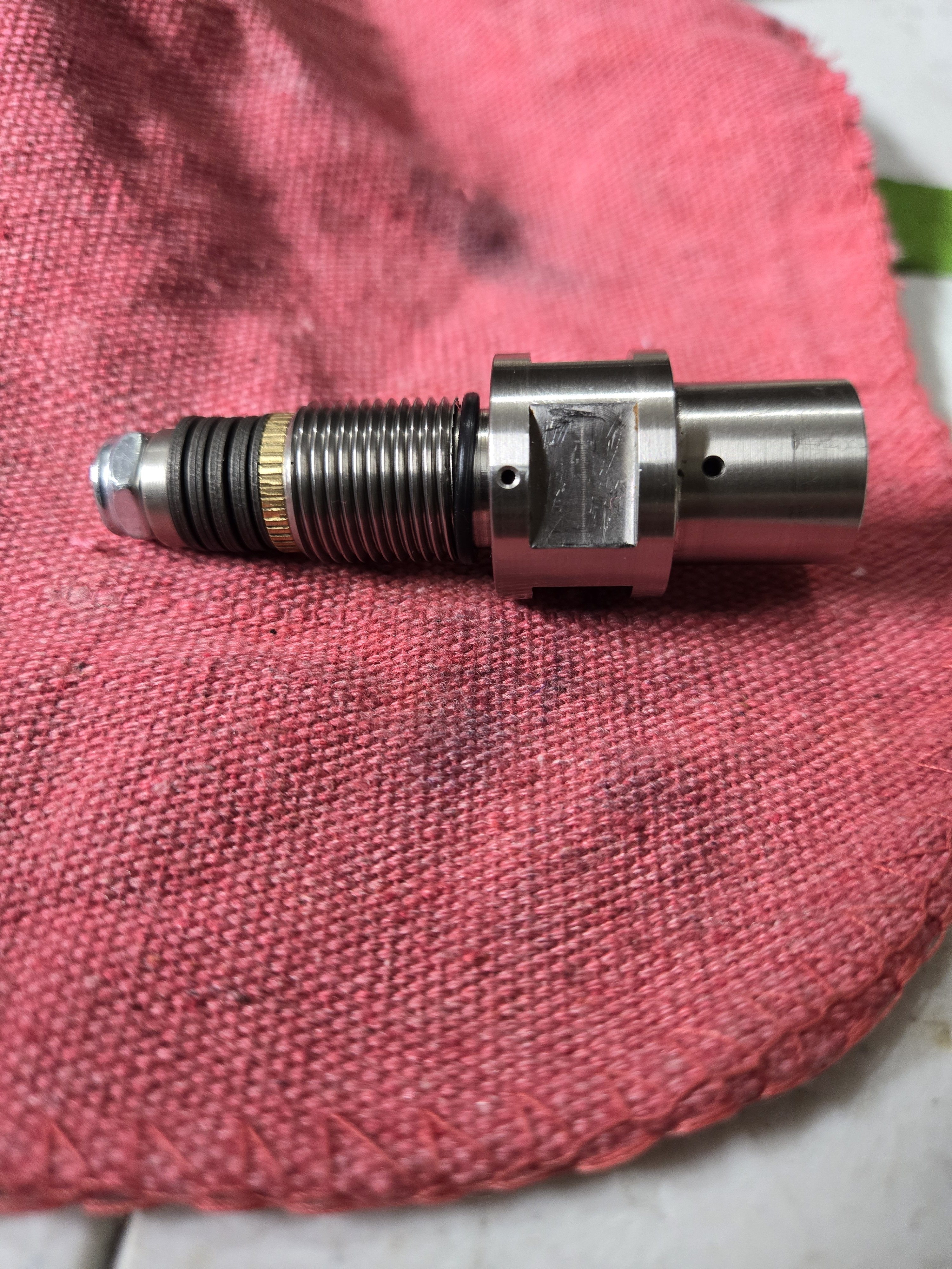

My RAW regulator is leaking out of the hole closes to the block. I removed the regulator, have the o rings to replace but not sure how it comes apart. I have tried Air Arms, and you tube but I can't find a video of how it comes apart. Thanks for any help.

Thanks I took apart the regulator and the bigger one on the stem was hard and fell apart when I tried to remove it.

Thanks for the replies. So....I removed my regulator in my RAW and took it apart. I use c clip pliers to remove the brass inlet nozzle to replace the o ring under it. I lightly lubed the o rings and put it all back together, tried filling it with air and was still leaking out the regulator vent hole....I'm like REALLY WTF... Gave a call to Martin, told him what I had done, he told me the silicone on the orings inside the regulator could be the cause. I took it back apart, sprayed the inside regulator body with brake clean, took off the o rings on the nozzle, cleaned it, wiped all the silicone off the orings. Put it all back together, prayed, sprayed it with some holy water...and no leaks.
I have been told by acouple knowledgeable air gunners that they never use silicone or silicone oil on their orings, for that same reason. I was told if everything is clean, the orings will seal, they don't need silicone or oil.
Maybe this may help somebody out there with a leak.

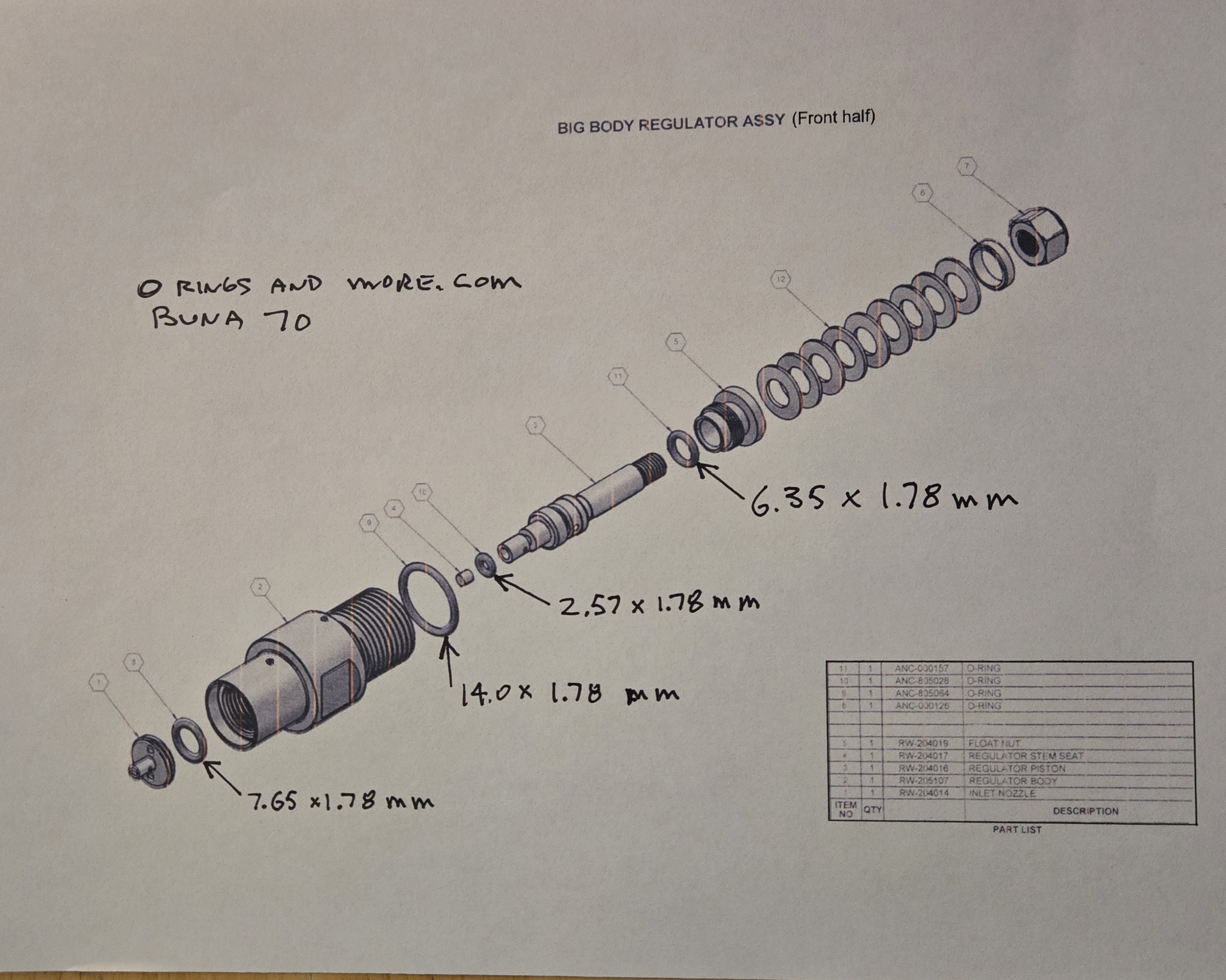

Some say use a little silicone, I assembled my reg with no silicone on the orings and it's holding fine.Do you have the 4 correct O rings ? You can buy 50 or 100 of each size for about 1.00 per o ring from Oringsandmore.com.
Excellent, I love parts diagrams (y). I do have a ziplock bag of O-rings that came with the rifle, just need to dig them out and see if they are what is spec'd for the regulator. Thank you for all the info!
