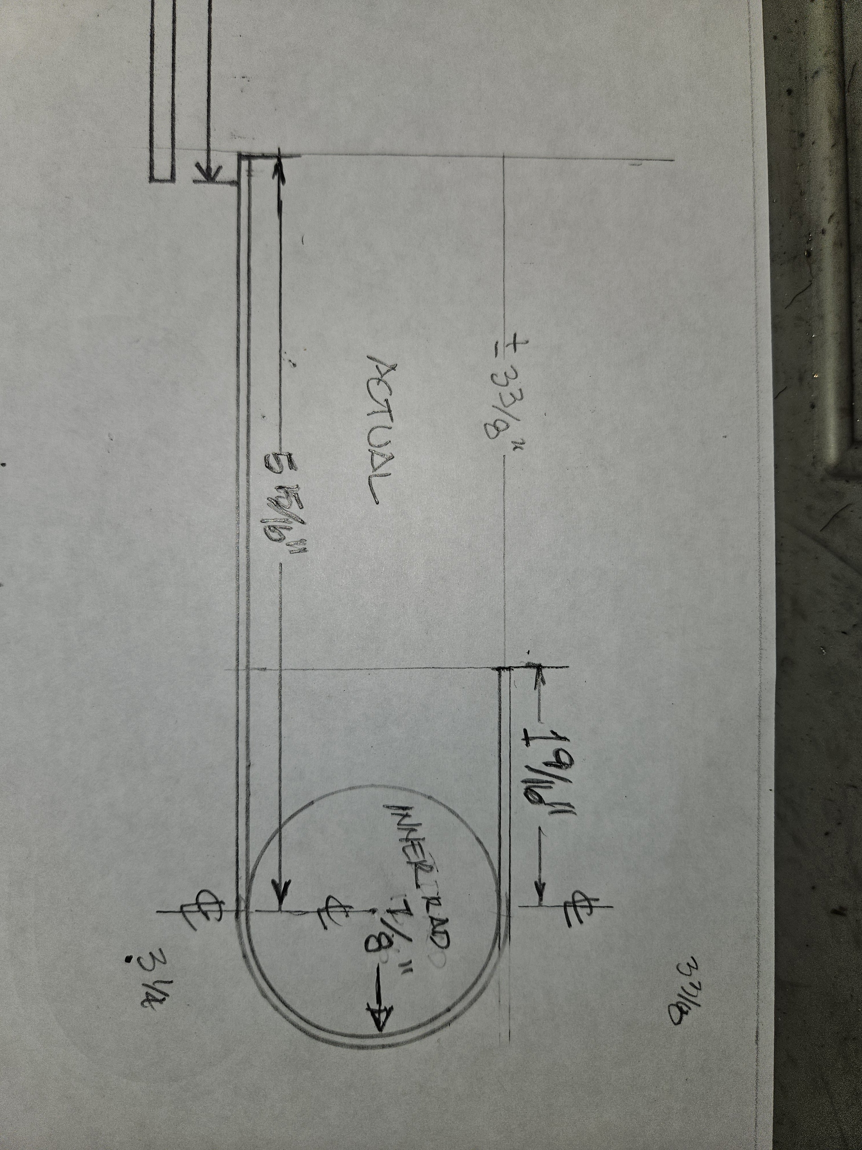

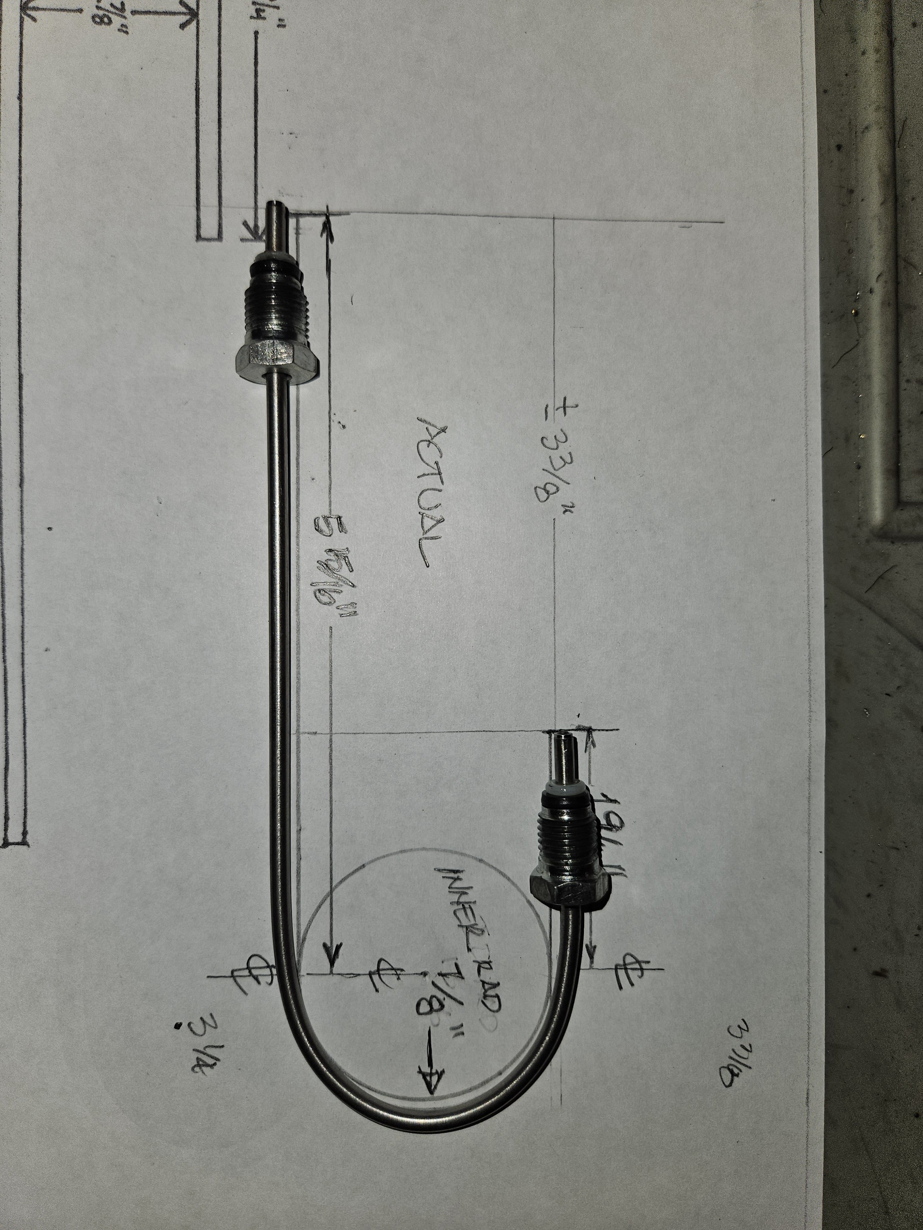

Contact Zack at OCO Labs, they can make the 'newer' ones that use O-Rings that last a long time, especially removing/re-installing.
A little costly at around $30 per piece, but I have NOT been able to find the fittings that are used (dang it!).
You will need to give fairly exact tubing dimensions as the ferrules are pressed-on, not threaded, with a specialized tool.
I made a small drawing with dimensions and the radius of the 'U' bend included in real size and emailed it with my request to Zack. While the radii and long leg were the same the short legs were slightly different with the rear one being about .125" longer.
