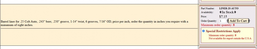

Long_Shot, I don't take your feedback the wrong way at ALL. I humbly admit that I'm not an engineer, scientist, or physicist. I'm not an expert in this matter. It's my understanding that a faster twist (in moderation of course) improves stability on slugs. This is very evident when shooting a .22 air rifle. The 1:16 twist has been proven to be more stable than the 1:17.7 twist from LW when shooting slugs. Would a 1:15 or 1:14 twist be even more stable than the 1:16? I don't know. There are several people that are shooting a 1:14 barrel. Bob Stern has one, and he gets incredible accuracy from it. He sent me pictures of some of his groups using his NOE boat tail design. The groups were impressive.
Is there anyone who posts on this forum that's using one of the older .25 ACP barrels with a 1:14 twist? I realize the barrel is a firearm barrel, not an air rifle barrel. But slugs aren't pellets, and I think they would lend towards better performance from barrels designed for firearms. Barrels with faster twists and no chokes. But I also think everything has a resonant frequency. This was Nikola Tesla's theory regarding mechanical engineering and structural integrity. Everything has a "resonant frequency". A frequency at which the harmonics created cause subtle vibrations in a structure, and if left on for too long, the building could topple. It's a magic combination of frequency and placement of the device where a very small force properly placed and exerted could yield a MASSIVE result..

A 1-20" or 1-22" twist for .25 might work, but a faster twist rate could be a more stable slug barrel choice. So basically the reduced barrel harmonics in a fast twist could help in the slugs stability from breach to POI. That makes sense.
I was wanting a new 28" barrel anyway. No point in having all my barrels the same twist rate. I'll be looking into this more before I order the barrel.
