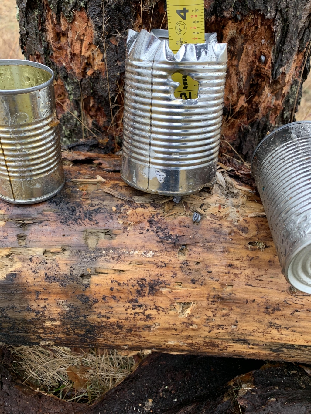

Update to my research on undersized slugs
This is 4 32gr slugs out of the same gun at 113yrds going 930fps. Sent that one a little high and it caught the rim of the can and ripped it off the log I had it screwed to. Still the flier was only an inch high. I will test more as the weather improves and decide which weight is better. One thing is for certain, slug diameter is key. I could shoot .249’s at those cans all day and never touch them.

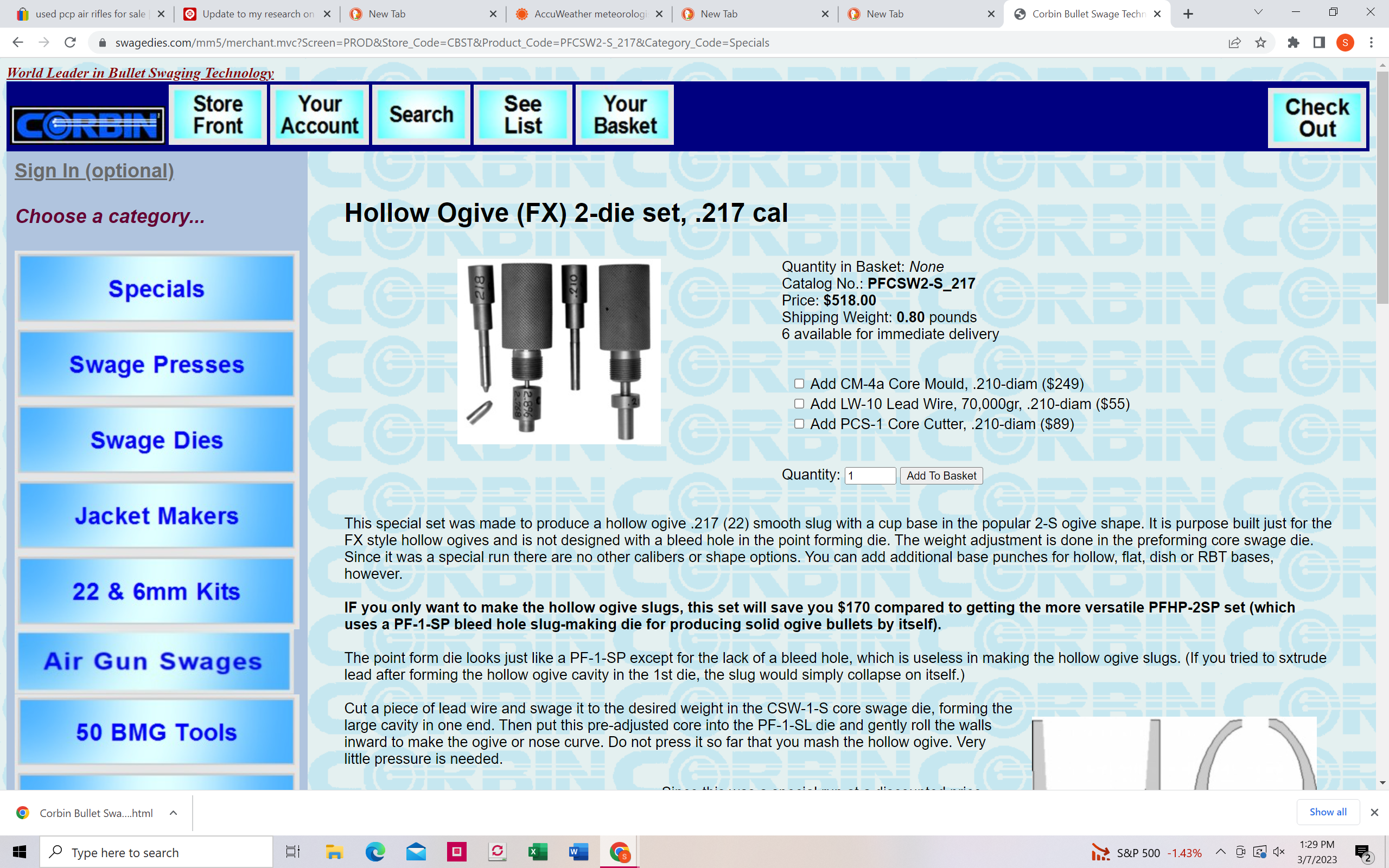

do u happen to have a swage die in .218 hp u might want to part with?

Yes I’m looking for a die for swaging a slug. Either by hand or arbor press preferably.
I have a commercial slug business. Been working on things for last 12 months.... Plan to open by April 1...Go to Corbin website and click under SPECIALS.....As of last night, when I spoke with Dave Corbin, he had a few .217 2 die sets, left, and at least one of his CSP-1 or "S" press, which is the most popular swaging press in the world......
