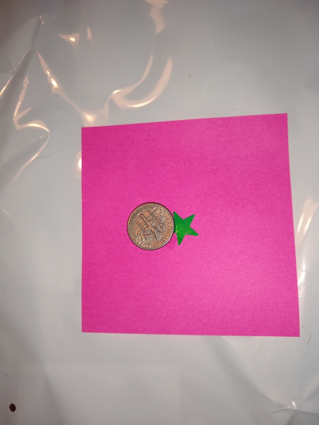

Now, for the best 5 shot group of the night:
So yes it is a dime size group at 48 yards. My fantastic Harbor Freight $10 digital calipers say it is about 1/2 inch center to center, or about 13mm. If I thought it would hold at 100 yards, it could be a 1 MOA gun, but my experience with the Marauder is that the pellet will become unstable somewhere after 75 yards. I may try it, but for now, it's my 50 yard gun!
Yes, I'm HAPPY with the results. Thanks everyone on AGN and thanks Tom! Couldn't have done it without you!
Edit - Adding one bit of clarity. The 830 FPS was with 14.3 grain Crosman Premier Domes / Hollow Point. The group was JSB 18.3 Jumbo's. The 18.3's run about 750 to 760 FPS. Little slower, but with these results, I think I'll leave it alone.

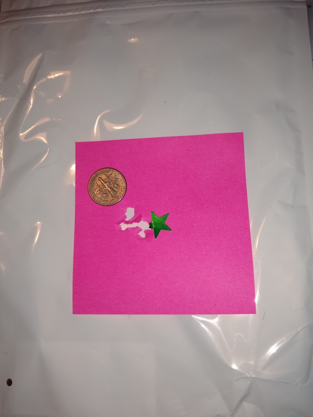

Finally got a day at the range today. Drove through driving rain, hail and gusting winds. Rain was flooding the areas around the range and a couple cars in the parking lot were in a foot of water. Storms are supposed to be hit and miss today, so went inside and paid for access and took a chance.
By the time I got back to the car to drive to the rifle range, the rain was letting up, and when I set my targets, pretty much done. Light drizzle here and there, but otherwise, no wind, no rain. I was the only person on a 20 lane range, except of course the 4 range masters.
At 50 yards, with my Marauder and new regulator setup, I shot Crosman 14.3 grain premier domes, JSB 15.89 grain and JSB 18,1 grain at 50 yards. minimum 10 shot groups, but Results were interesting.
Crosman Premier Domes, 3 inch groups at 50 yards. Needless to say, didn't waste much effort with the Dome's after that.
JSB 18's, really surprised me and not in a good way. 2 inch groups.
The JSB 15.89's did the best with 10 shot groups of .8 inches according to my fancy Harbor Freight calipers.
All that got me to thinking, maybe the 18 grain pellets need more speed to stabilize, so back to the chronograph I went. At the current settings, I'm getting about 770 fps, so a little slow by most standards. One turn on the Hammer Spring got me up to 780, and two turns to 792. That's where it stopped. No matter how many turns on the spring, no more speed, meaning where I've got the regulator set is a tad low to send the 18 grain pellets any faster than 790'ish.
Well, back to trial and error. I'll be adjusting the regulator up from the 1600 PSI currently set at to something closer to 1800. That should give me a bit more room to "tune" the speed of the pellet, cause 20 fps isn't much range. I might need to buy that lighter Hill hammer as well. Did someone say something about this being an expensive hobby?
