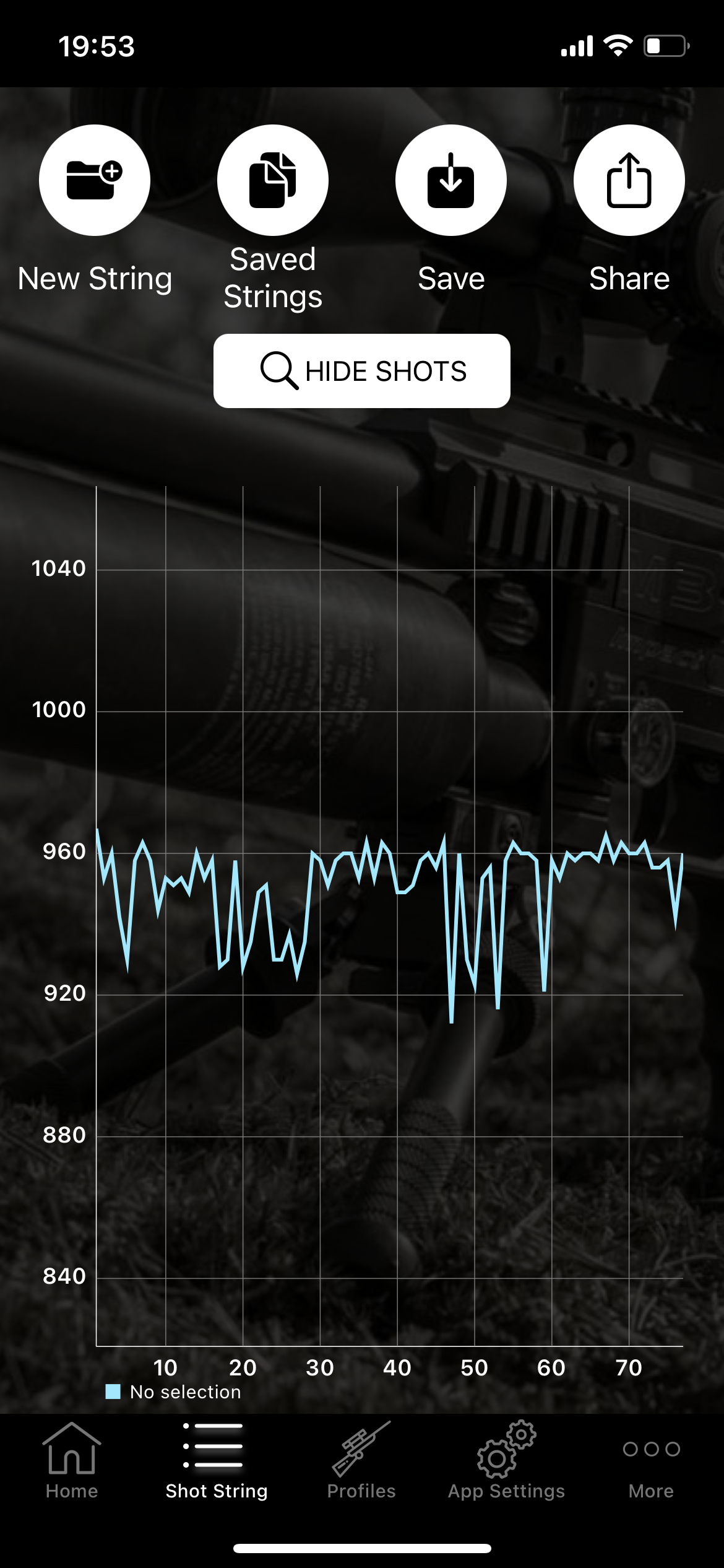

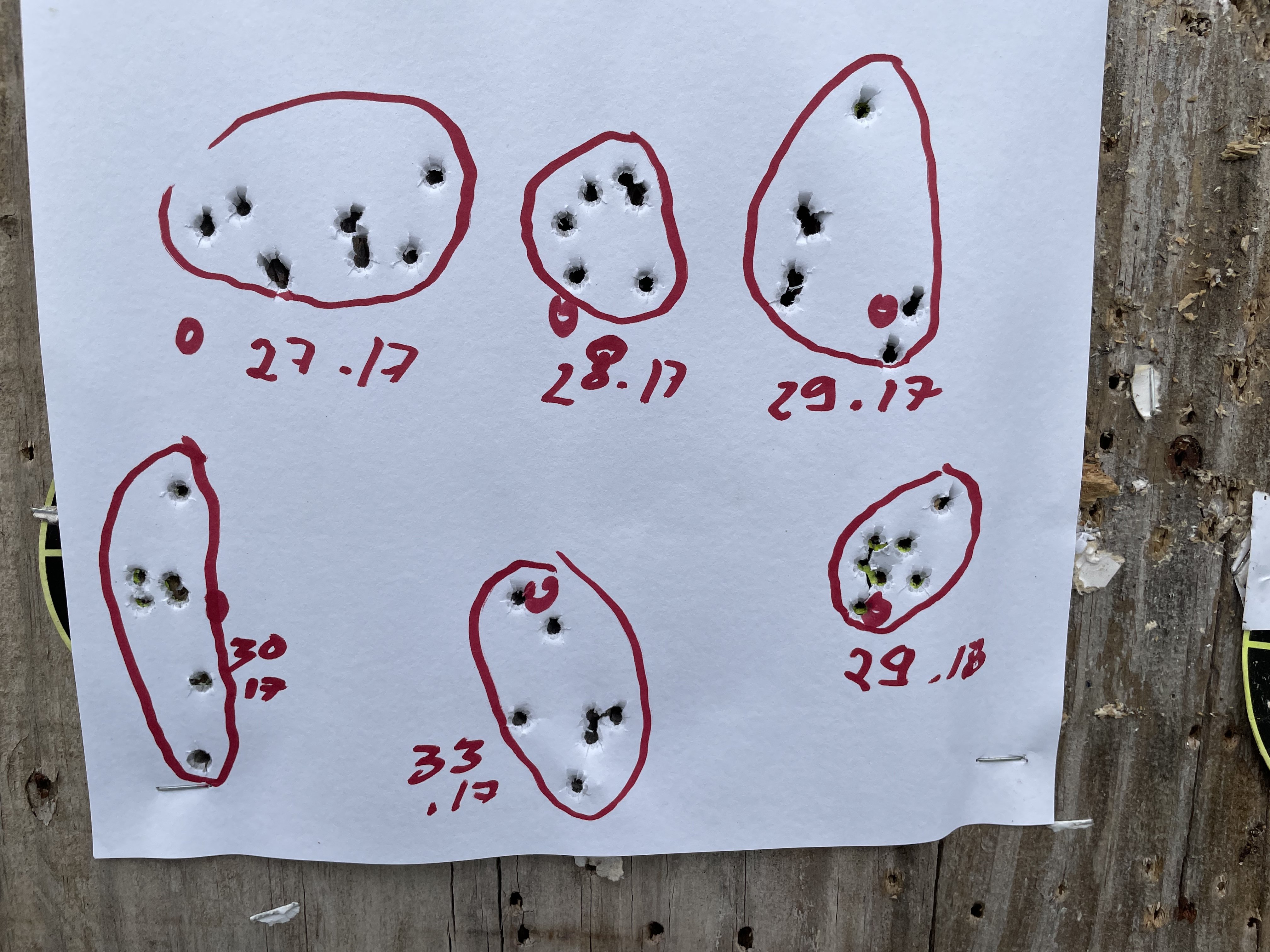

Hello, I did some tests with the spring adjustment but it doesn't seem to have much effect. Follow the data Uragan 2 700mm .22 huma air reg at 140bar slug 29gr .217
The top number is the weight of the slug, and the bottom number is the number of turns from the bolt flush to the block.
shots at 56 meters
Any tips on how to improve?
The speed on the gun is essentially entirely determined by the reg pressure. The hst just has to be 'enough' to open the balanced valve.
The poor accuracy likely relates to more than the velocity though, as all the ones I have set up have shot very well in that range.

Another is to maybe try the 28gr 0.217 Zan if you haven't. They have generally been best in these guns of everything I've tried, and usually very close to the reg pressure your gun is at, shooting around 960fps.

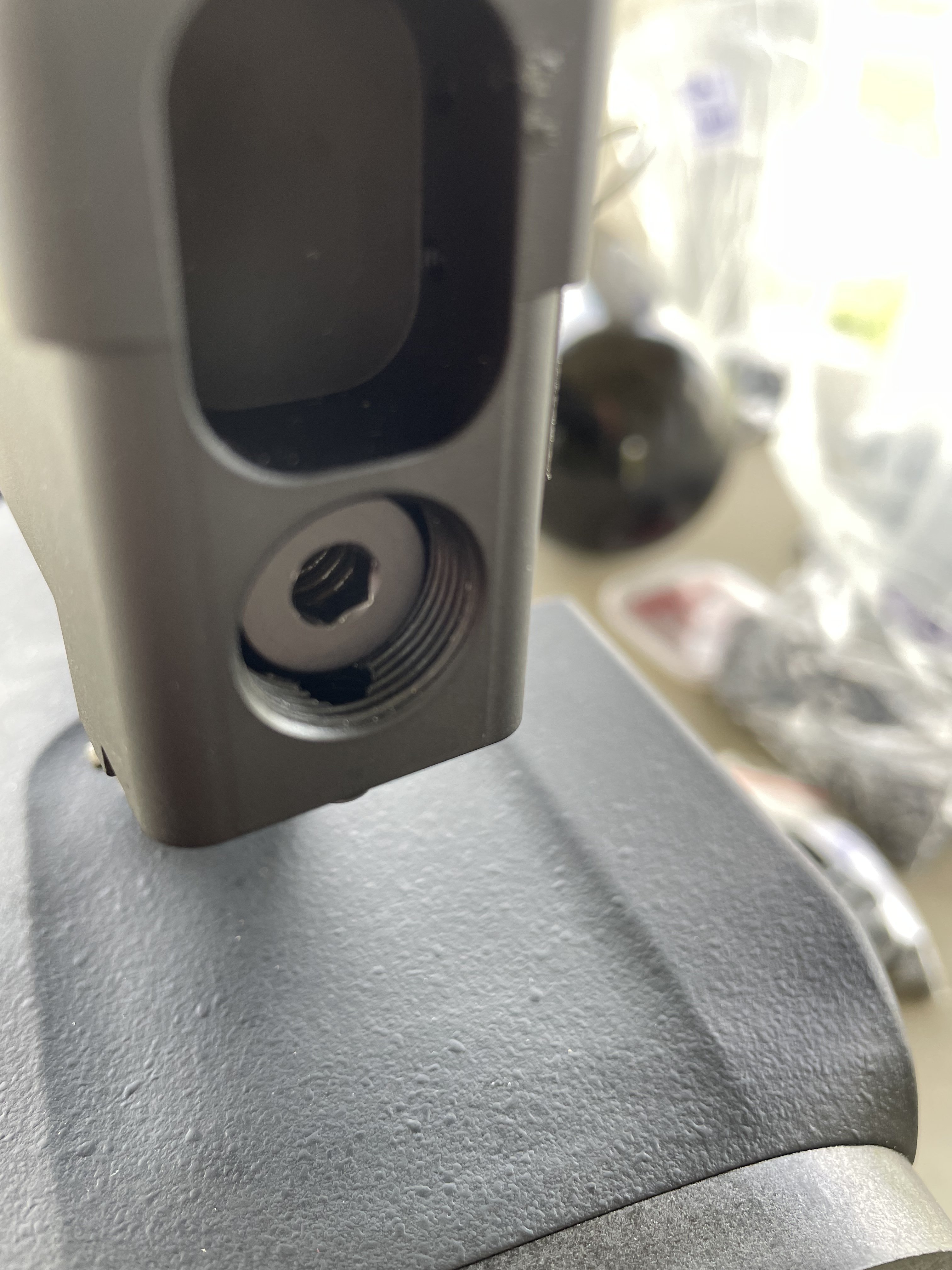

This is proving difficult to adjust. I installed a human air regulator, it is at 150 bar, with energy of 57foot-pound. The spring adjustment does not change power, but it may reduce the spread a little, if I leave it close to the block the spred reaches 30, with an ugly sound, it sounds like a sneeze, if I add 5 turns, the spred drops to 19, improving the sound for something like a dry stamp. Regarding the slug, it seems that the thicker the better, but then I had a type to test
Did you read the suggestions people had on how NOT to adjust the rifle with the spring? That is not how you adjust your power in these rifles. Several people mentioned it in this thread.
With a balanced valve system, you don’t adjust with the spring. It isn’t like the rifles where you fiddle with the reg and hammer to get them in balance. Go back and read the posts. The hammer is basically set it and forget it once you have it set enough to open the valve, and then you adjust power with the regulator.
