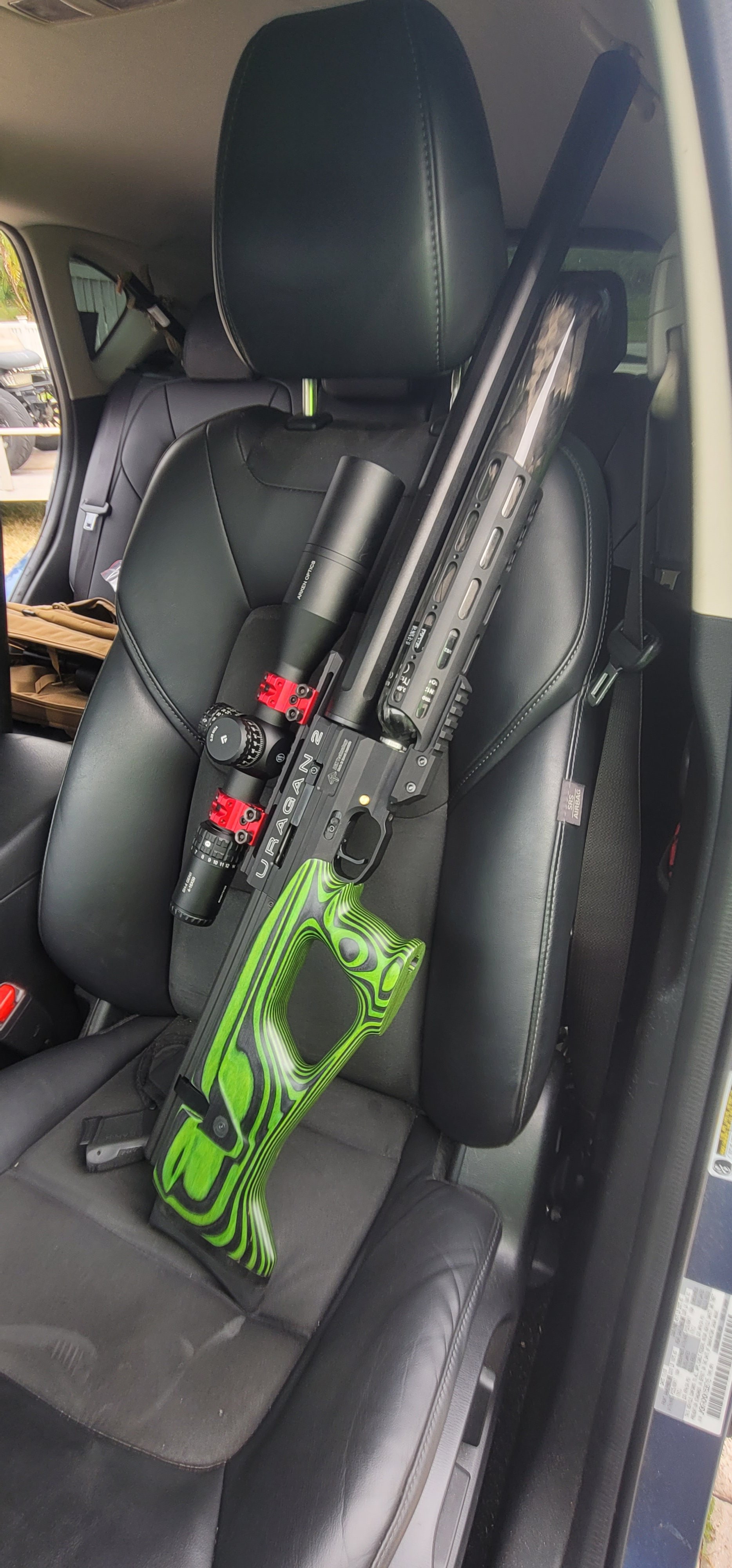

The loudest part fo the rifle is the hammer smacker the valve. I have the 700mm in .22 the person ai bought it from said he never tuned it, so out of the box it's shooting 28gr Varmint Knocker slugs at 880fps. Overall length is 39", I don't plan to put a moderator on it as I dont want it any longer but the shots really arent that loud, it's the smack of the projectile.

I dont want it longer aswell. The 700mm is long enough, its just 1 meter. If I go with the 600 I can still attach a 10cm moderator if needed, but i'm not sure if I want to go that route.
I really like the green one, thats the one i'm looking for aswell.
