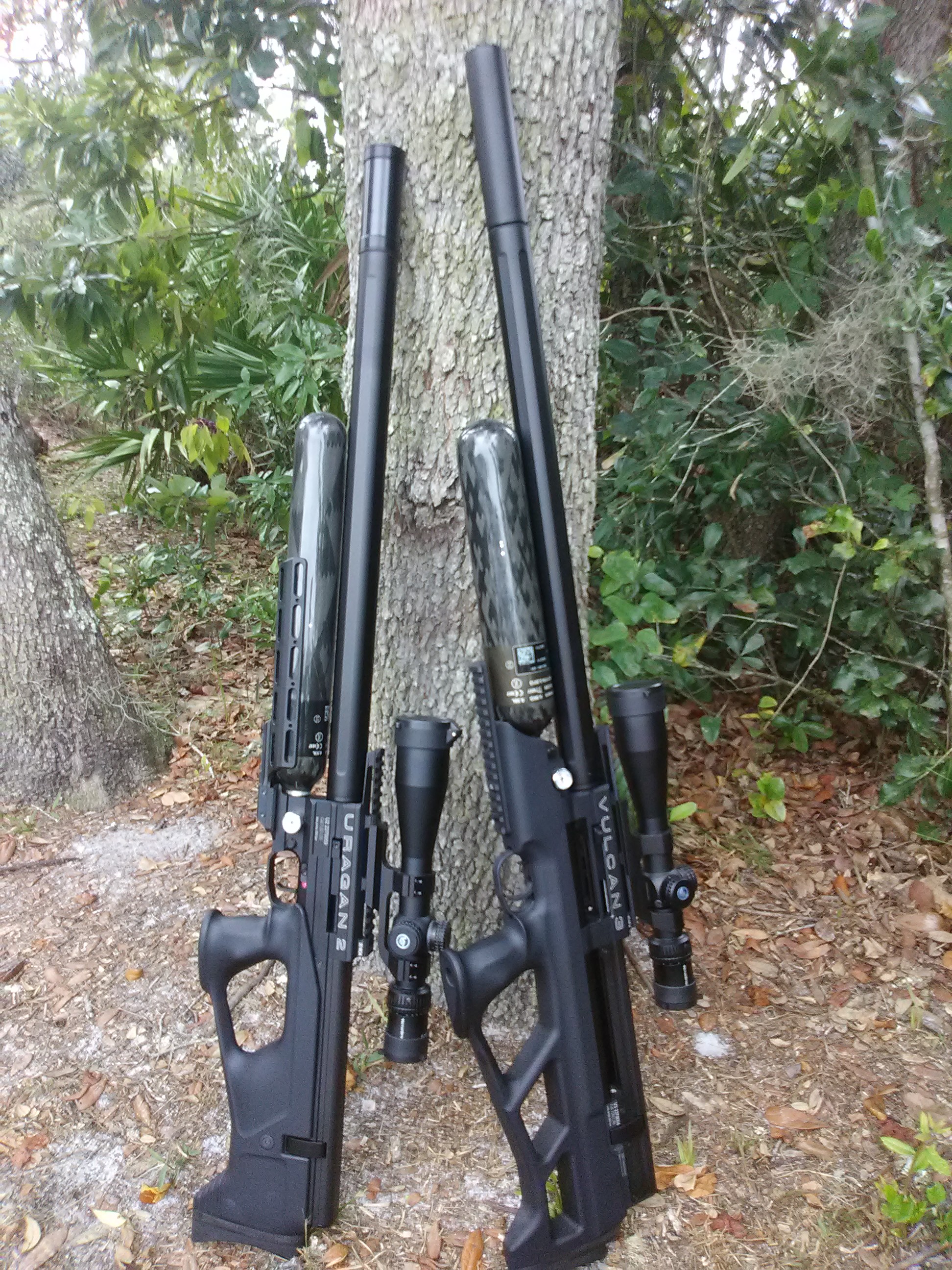

Here they are for size comparison, V3 has AGT factory moderator, U2 has 4" Pugio (Silent Thunder Ordnance) moderator. You can see where the shroud ends, and moderator begins. U2 purchased November 2022, V3 in January 2023, both .30 (700mm), 96-97 FPE out-of-the-box with JSB 44.75 pellets. Nothing adjusted on either. U2 shoots pellets better than V3, smoother functioning and quieter, too.
Here they are for size comparison, V3 has AGT factory moderator, U2 has 4" Pugio (Silent Thunder Ordnance) moderator. You can see where the shroud ends, and moderator begins. U2 purchased November 2022, V3 in January 2023, both .30 (700mm), 96-97 FPE out-of-the-box with JSB 44.75 pellets. Nothing adjusted on either. U2 shoots pellets better than V3, smoother functioning and quieter, too.View attachment 418435
Thanks for sharing. I'm really liking the V2 in the 600mm setup for .22 I checked on Krale and the only available now is the CF stock, price is way better with them too.
U2 is more pleasant to shoot, smoother functioning, quieter and less "jolting." Loud clang in ear from V3 doesn't help either, one day I'll get around to install depinger. Of course, V3 didn't have to go back under warranty, so points for dependability. Both are hand cannons as far as power, V3 makes you feel it more. Only adjusted HS in Uragan .25 to tighten up JSB 33.95 groups, easy to do following YouTube video, stock needs removal. WM
