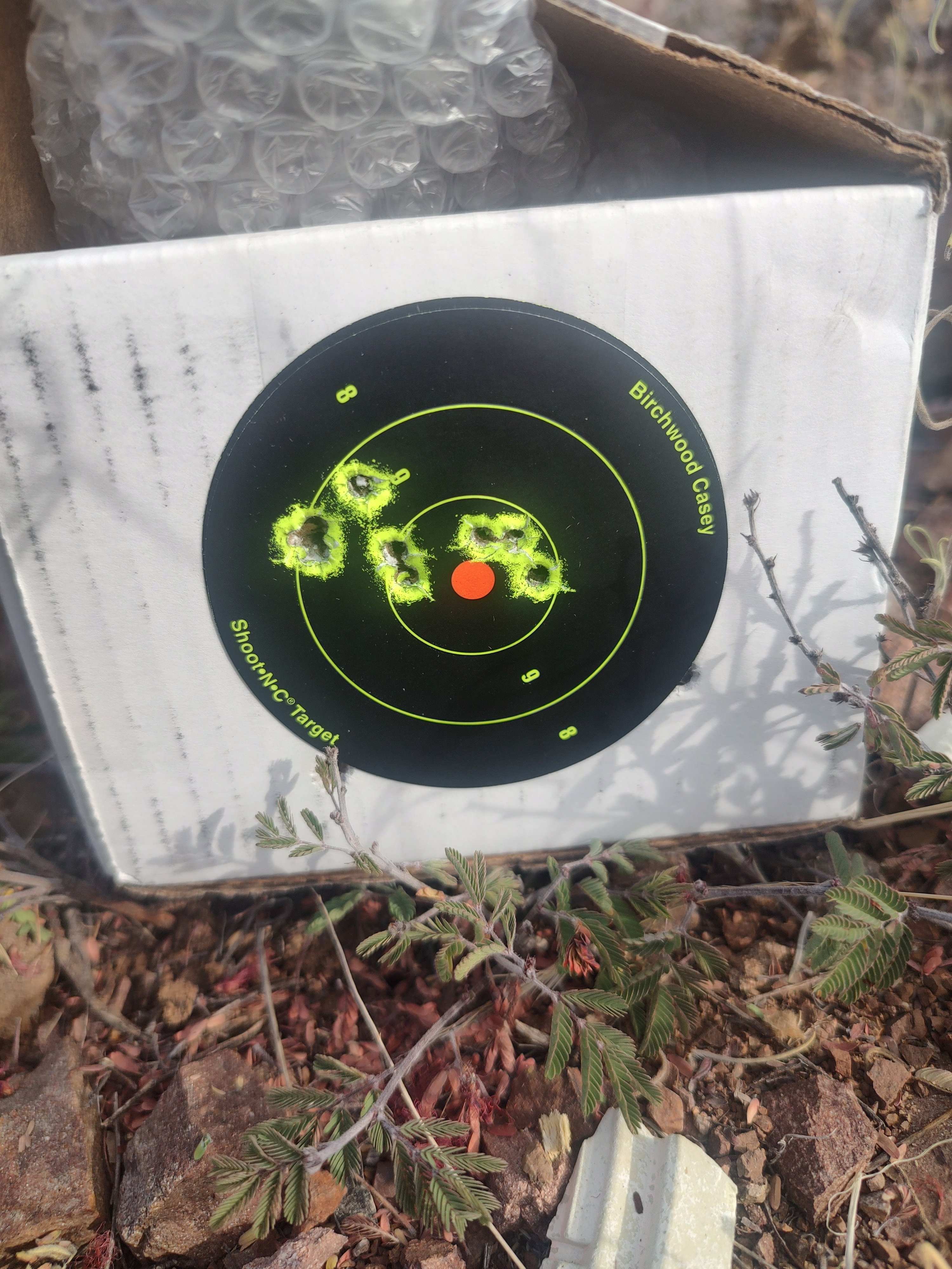

Here's an example of today's 10-shot group at 50m. Started close to the bullseye on the right, then moved to the left and settled down in that tight group on the left for the last few shots. Never touched the scope between shots.
Gotcha. Do you think it would affect shot count at all? Maybe lighter spring would prevent some of the bounce, if there is any?
That horizontal walking could be a scope problem. Another optic or clamp the rifle in a solid rest to remove the human and optic from the equation.
That's what I was thinking. It's a Vortex Diamondback...not top of the line, but they seem to be decent. I had a suspicion that the turrets are not tracking right when I returned it to zero with the pellets I previously scoped with and they were not where I zeroed them. Need to see what optic I can use instead.
