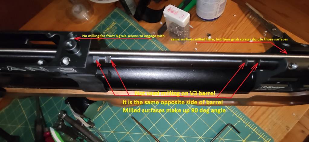

The barrel in my vulcan 3 500 / .177 for sure fit in something else, it have machining on it that do not correlate to this V3 rifle, so i assume it fit in AGT ? too
I am talking about flat spots milled in the barrel where 4 of the screws in the vulcan 3 do catch ( the 4 back screws ) but the similar millings further out the barrel, well the grub screws there ( under the scope rail ) do not hit those milled places,,,,, not even close.
I will agree having all different parts is not desirable, i would assume something like a barrel could be machined to work with several models.
But this also look to be the case looking at my barrel.
Of course my regulator tube was apparently machined wrong, or a wrong part was used,,,, but i am inclined to think the first, and then there was no regulator spacer in my gun. So clearly on the factory floor / QA department / Assembly DPT, things could be better at AGT, not being able to put in a regulator spacer, that should make bells ring.
And it is not like there are no room for the spacer in my V3, just if you put one in there, air would leak out of the REG breather hole as it is in the wrong place. but apparently people noticed this but then just assembled gun with no reg spacer,,,,,,, and thats just all kinds of wrong,,,, unless AGT make a gun that dont have that, but i think it is the same for all V2 and i assume even older vulkan models,,,,, not sure with other models from the brand.
