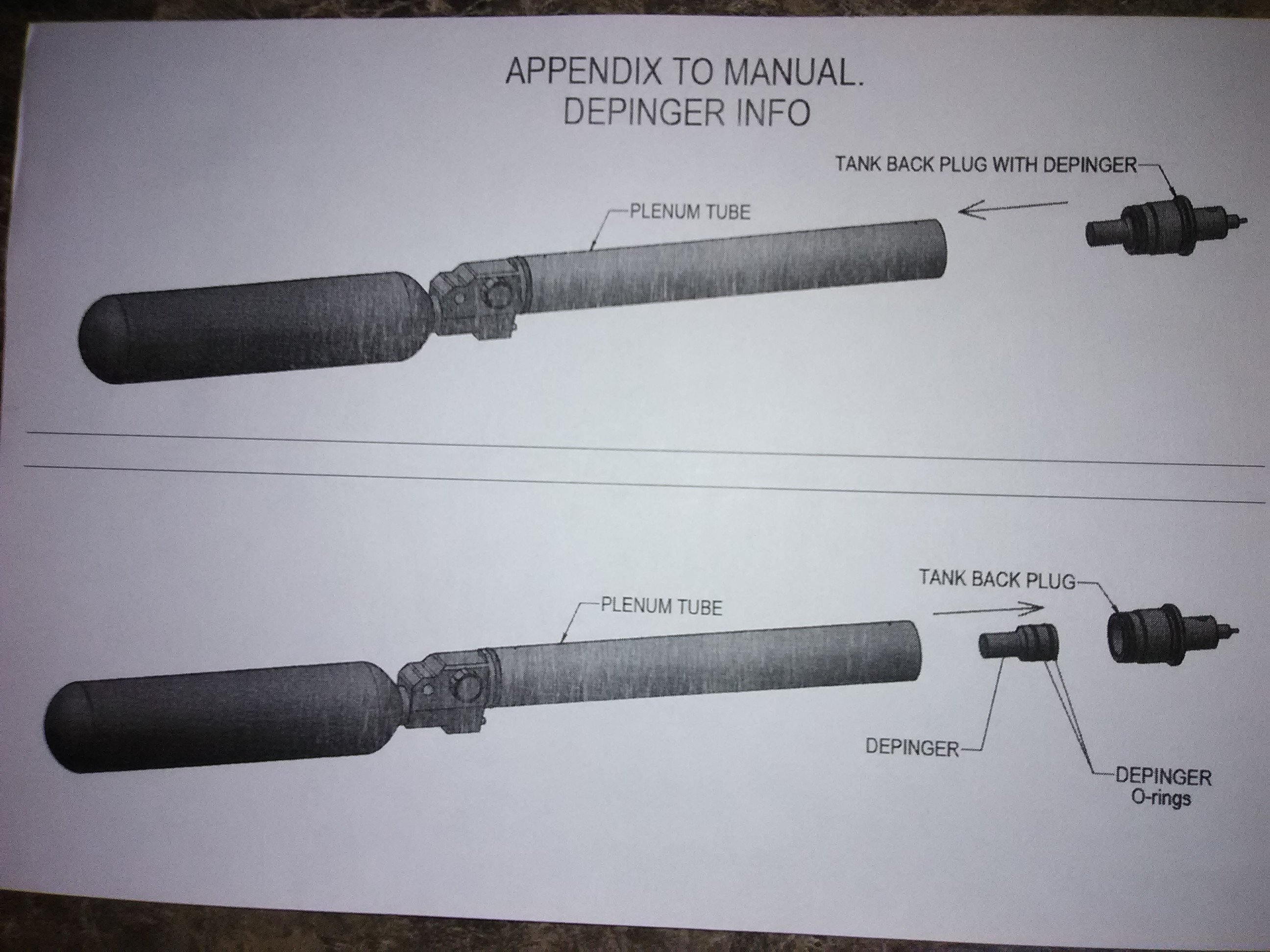

Bought V3 and U2 Synthetics .30 (700mm) from Krales this year. V3 much louder ping than U2. This appendix was in V3 Owner's Manual but doubt I have one installed, way too loud. Check out these threads in archives; "Perfect depinger for Vulcan 3," by Rabbit's foot, (3/1/23) and "Ping Be Gone," by Sleeper192, (3/3/23.) I've already secured the corrugated plastic for Rabbit's design, might work in U2. WM

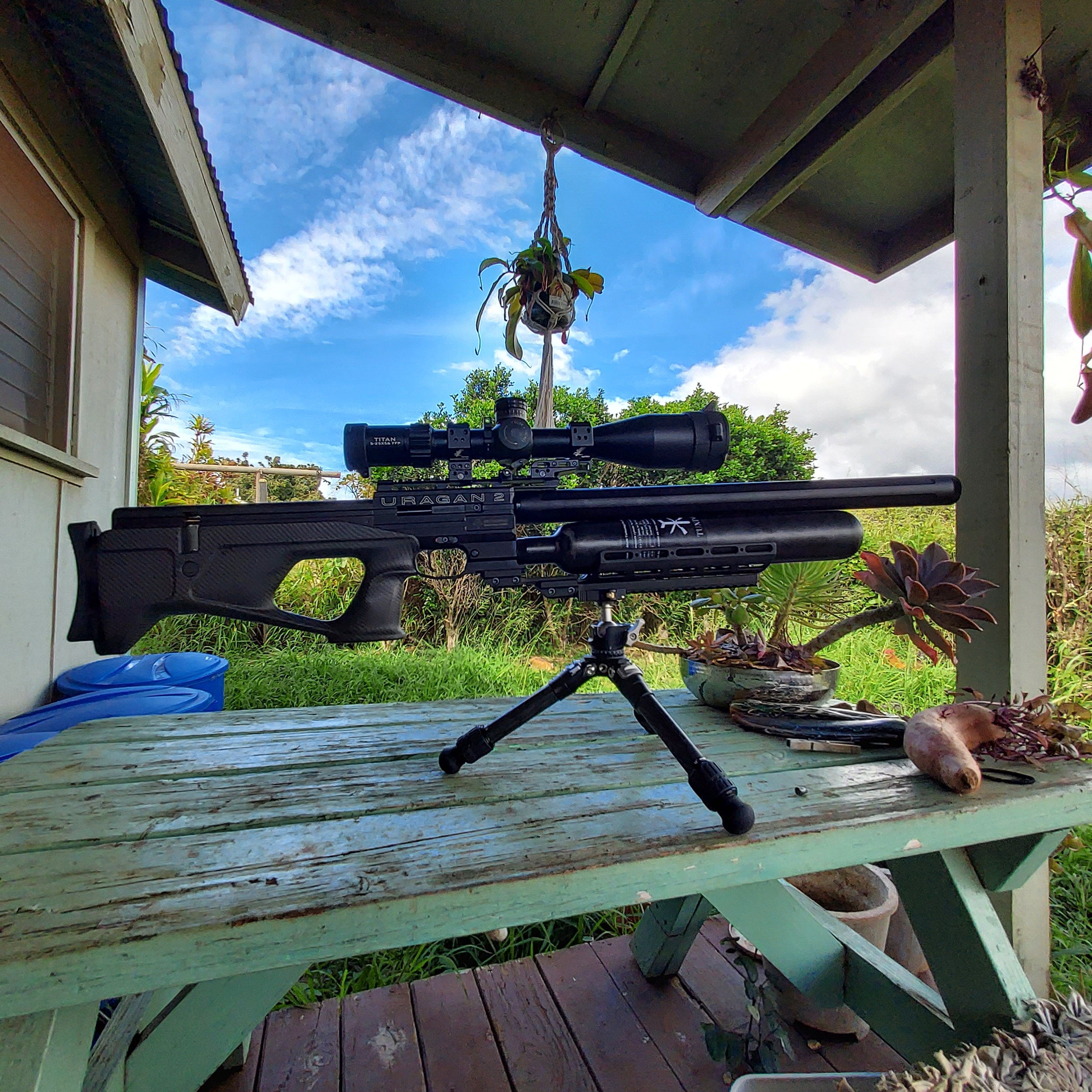

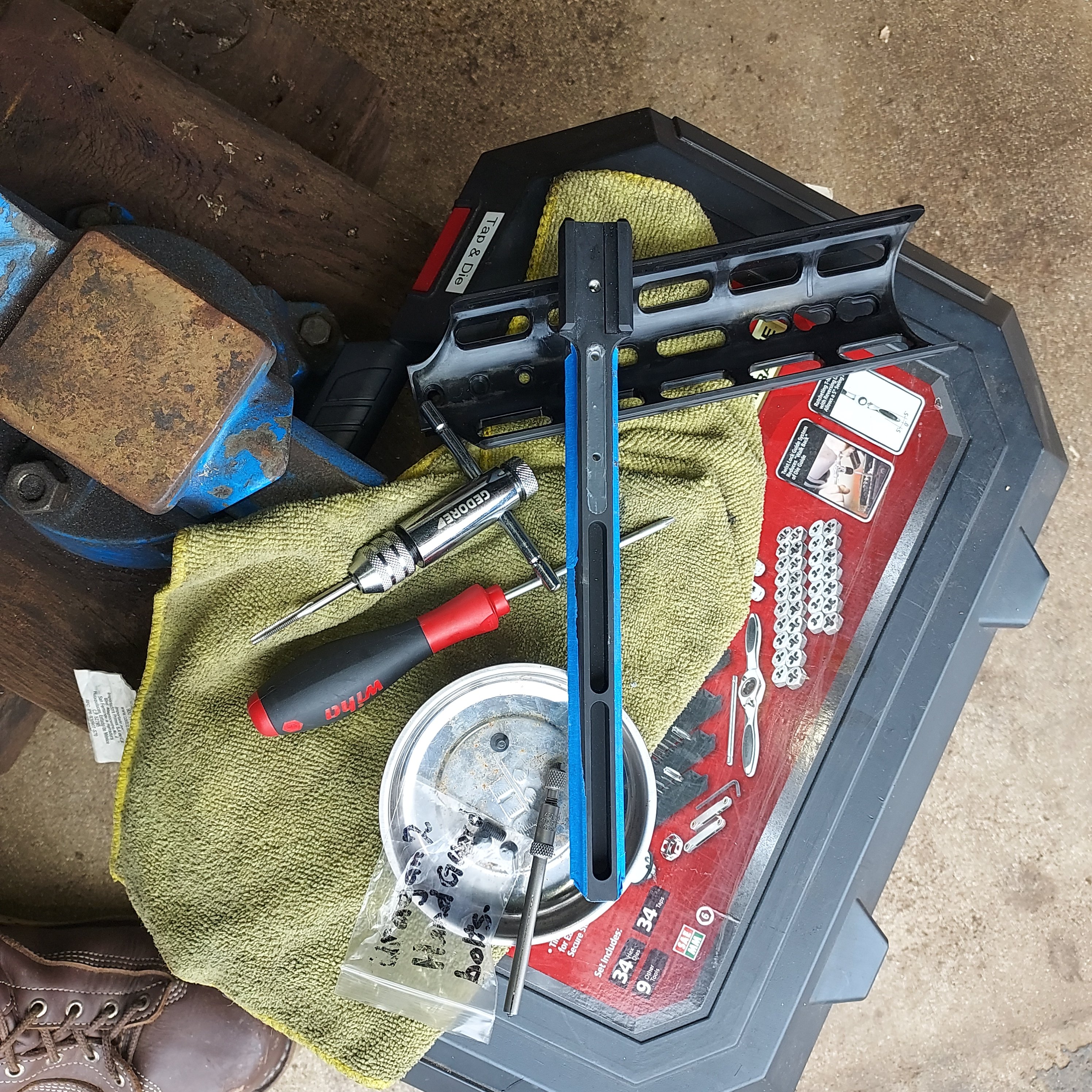

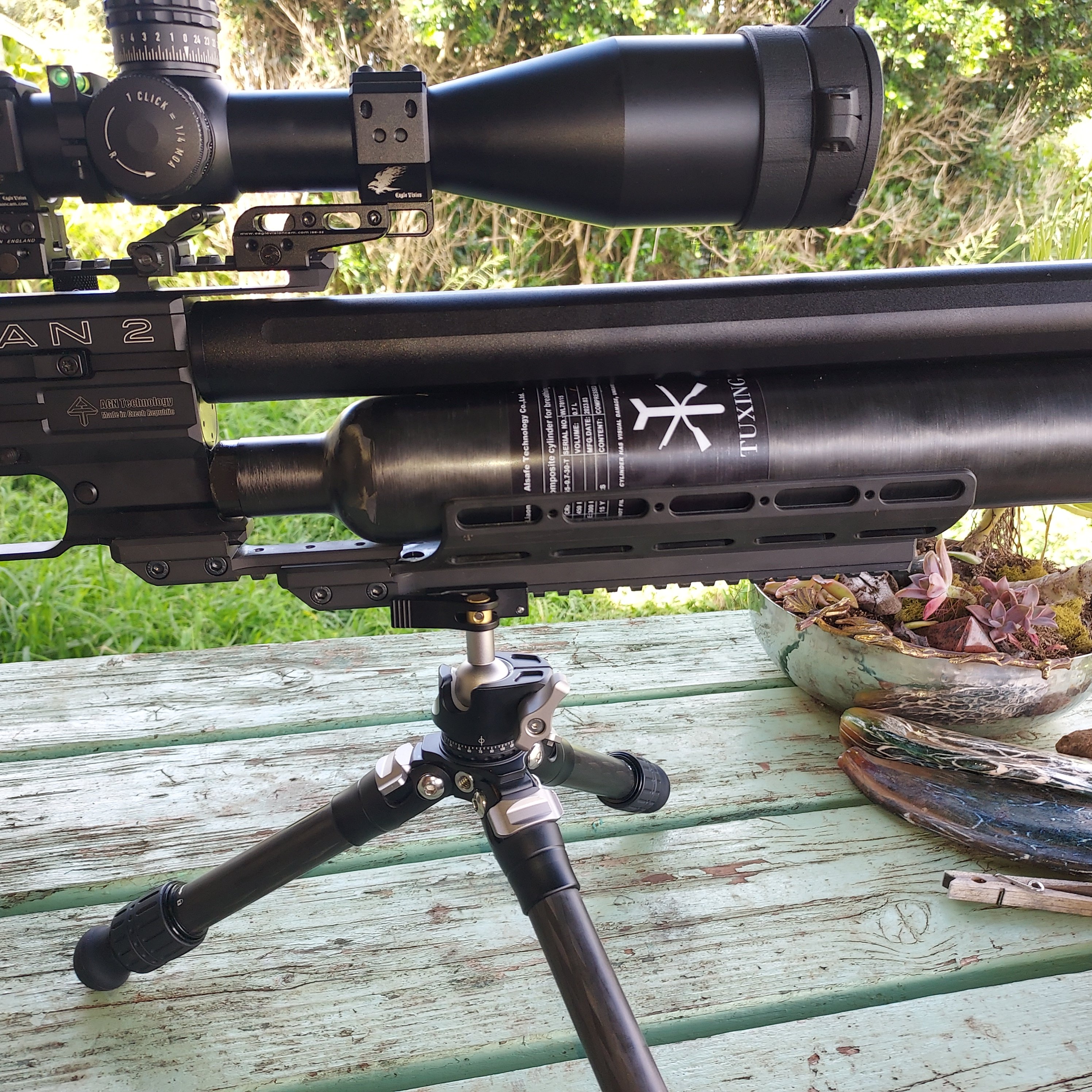

Did the Picatinny/keymod piece under the factory bottle still fit after you swapped it to the 700cc bottle?
No, it did not, but...
I spent $165 for the extended rail section.
I removed The hand guard and Slowly heated it with a heat gun, then when it got warm & pliable, I slid it onto a spare 500cc aluminum FX air bottle and used some tape to hold it on tightly.
The FX Bottle is a millimeter or two bigger in diameter than the 700cc CF bottle I got.
I attached the Picatinny rail from the hand guard to the pic rail section of the rifle and to the extended rail section.
(It clears the bottle by a couple of millimeters).
I am drilling and tapping the extended rail section M4 X 0.7 thread, where I will attempt to attach the hand guard.
It looked very " factory " when I filled everything up.
I will try and post a picture when I finish tomorrow or when I shoot it on Saturday.
