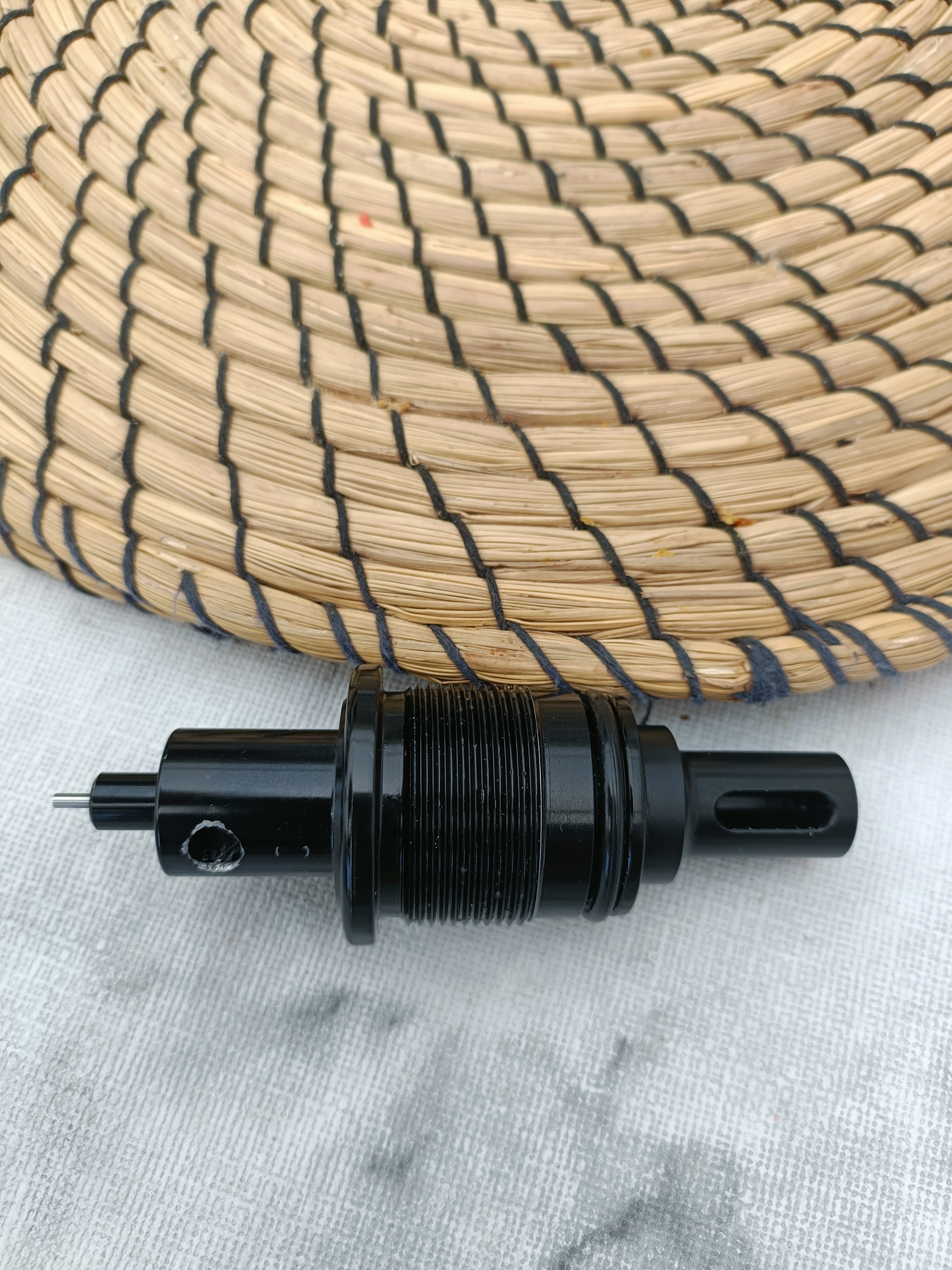

This Is The Depinger. But Will Not Go Past Second O Ring To Be Flush

we made one some time back when we had our U2, to get rid of the ping totally we needed to make slip rings for the H/S in the end it was not noticeable
we are only 12lbft so loosing the volume in the plenum helped us but will have an affect if you going for big power

Hi yes it's my channel and thank you for watching, if your running at that power level a de-Pinger will work perfectly 😁
