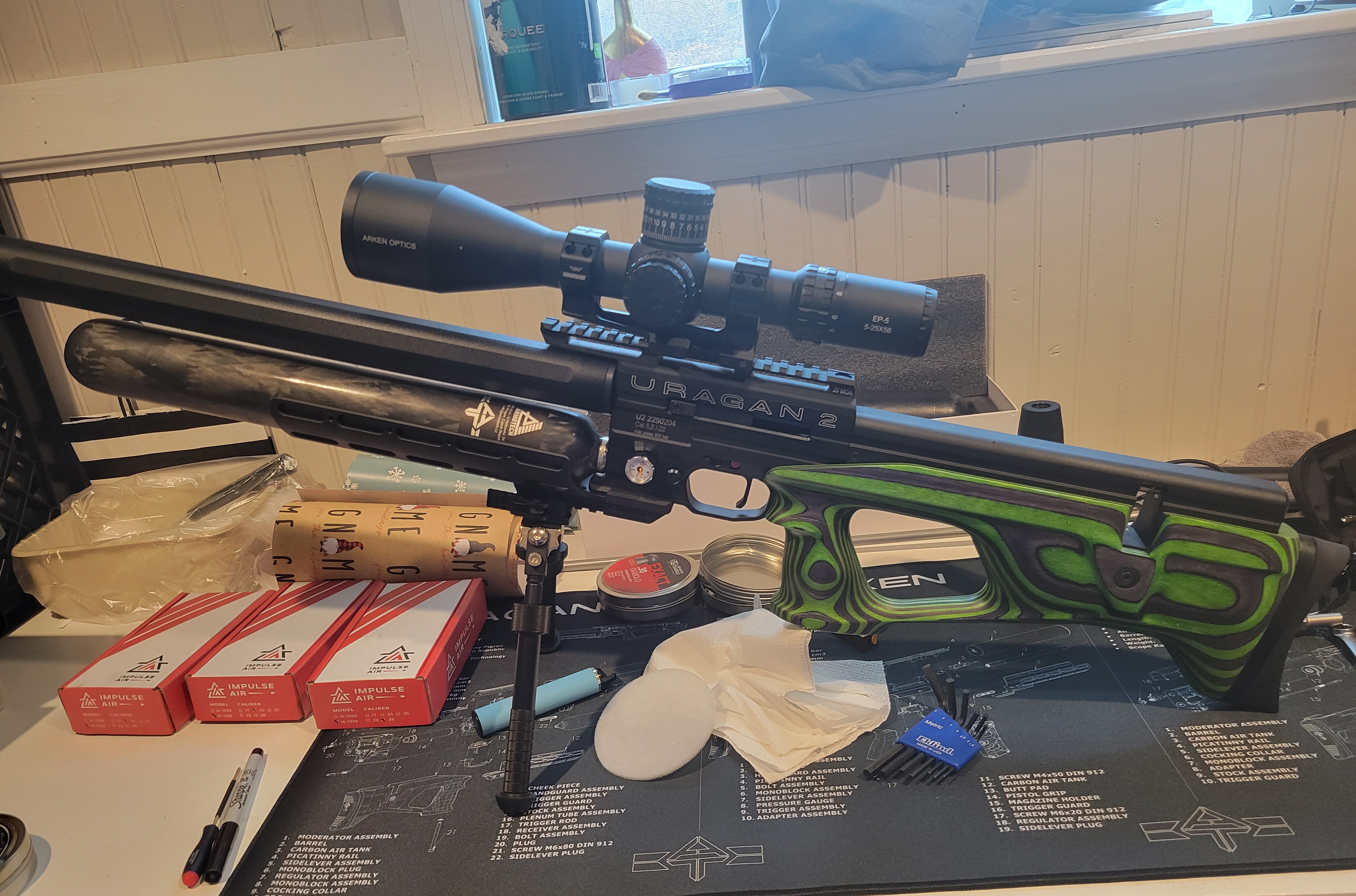

22 600mm Uragan 2. Should be a fun toy with the AGM Varmint on top.

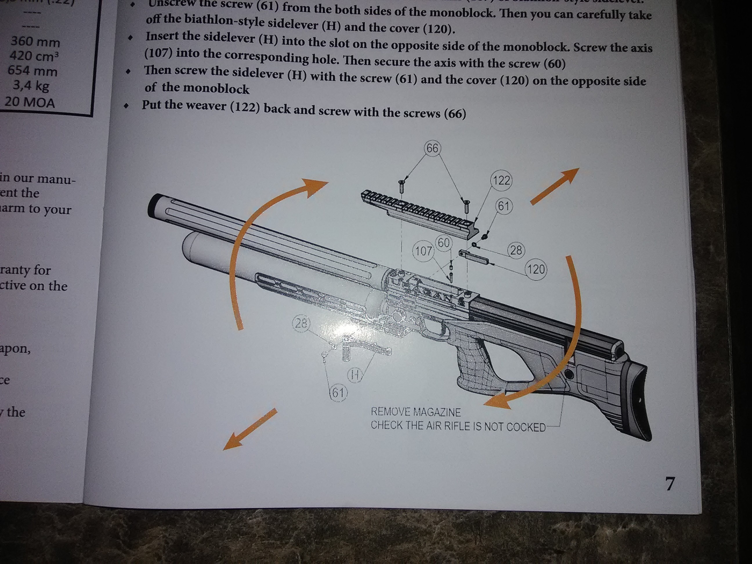

Just got my U2 .30 (700mm) from Krales. Let me know what you find if you switch cocking lever to right side. Following Owner's Manual (page 7) instructions, was surprised to find both the Pinching Screw (60) and Axis Pin (107) missing, the cocking arm pivoting on a steel pin low in the threaded hole where missing parts should be. Contacted AGT for replacement parts. Thanks, WM
Ctkny,
Mine was No problems. Was just as book said. Set screw and threaded pin.
AGT's reply was to see Page 7 of Owner's Manual (Pictured) for correct reconfiguration of cocking lever. I responded, in bold letters, that Pinching Screw (60) and Axis Pin (107) were missing, just a solid steel pin, was acting as an axis for cocking arm. I suspect the steel pin, installed from underneath, was temporary, to be replaced during manufacture by parts (60) and (107), just didn't happen in my case. WM
