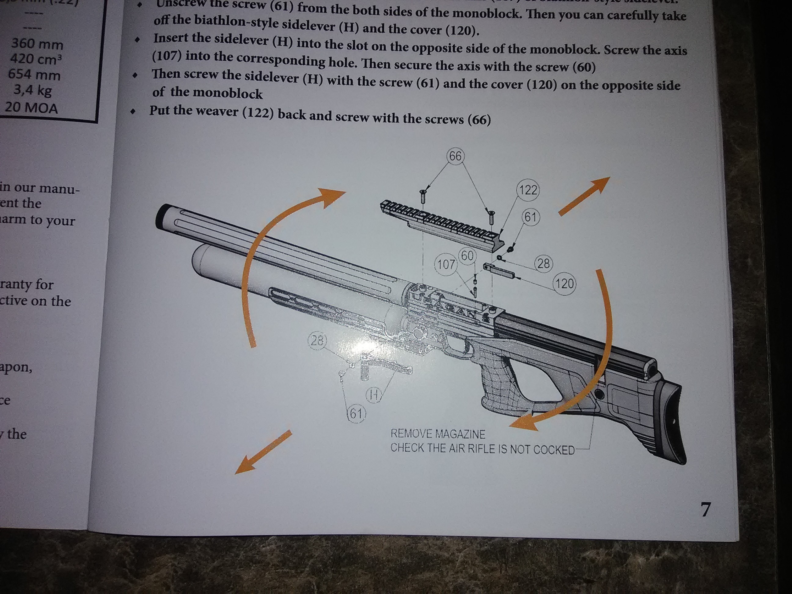

AGT's reply was to see Page 7 of Owner's Manual (Pictured) for correct reconfiguration of cocking lever. I responded, in bold letters, that Pinching Screw (60) and Axis Pin (107) were missing, just a solid steel pin, was acting as an axis for cocking arm. I suspect the steel pin, installed from underneath, was temporary, to be replaced during manufacture by parts (60) and (107), just didn't happen in my case. WM View attachment 320355
Hi I have the same issue, did you manage to remove the pin?
Big mistake on my part, found same thing when AGT Vulcan 3 arrived, was top of pinching screw I was looking at all along. Inserted correct size metric Allen wrench and removed. Some members tried to tell me but just couldn't see fitting, well, it was there. :whistle: WM

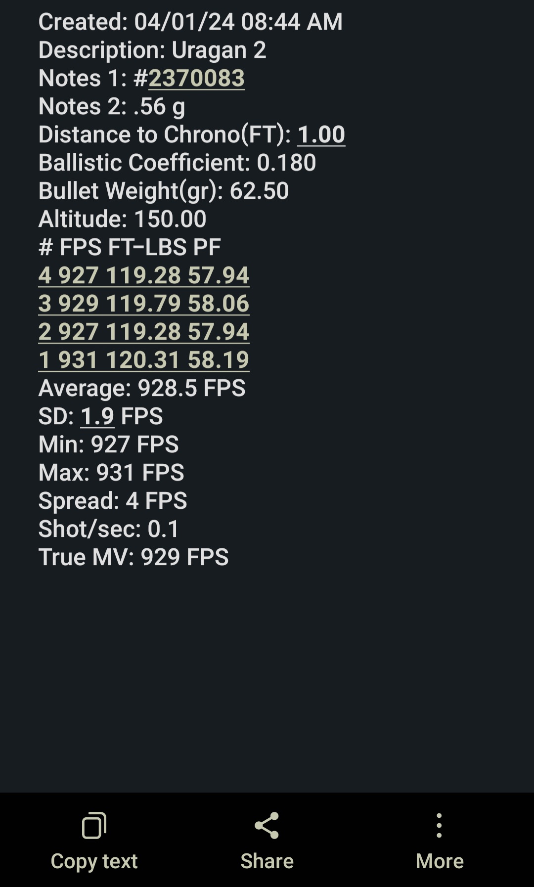

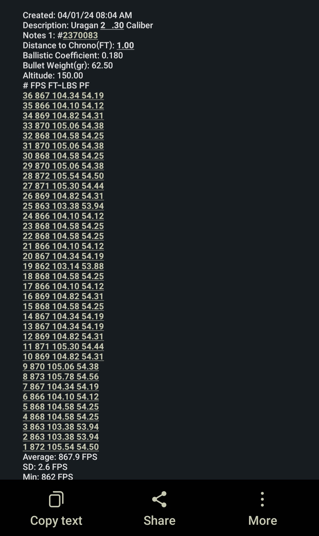

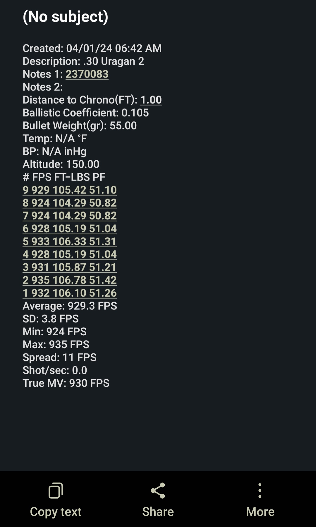

Starting off of a 300 bar fill and refilling at about 180 bar I get 5 mags or 45 shots.
