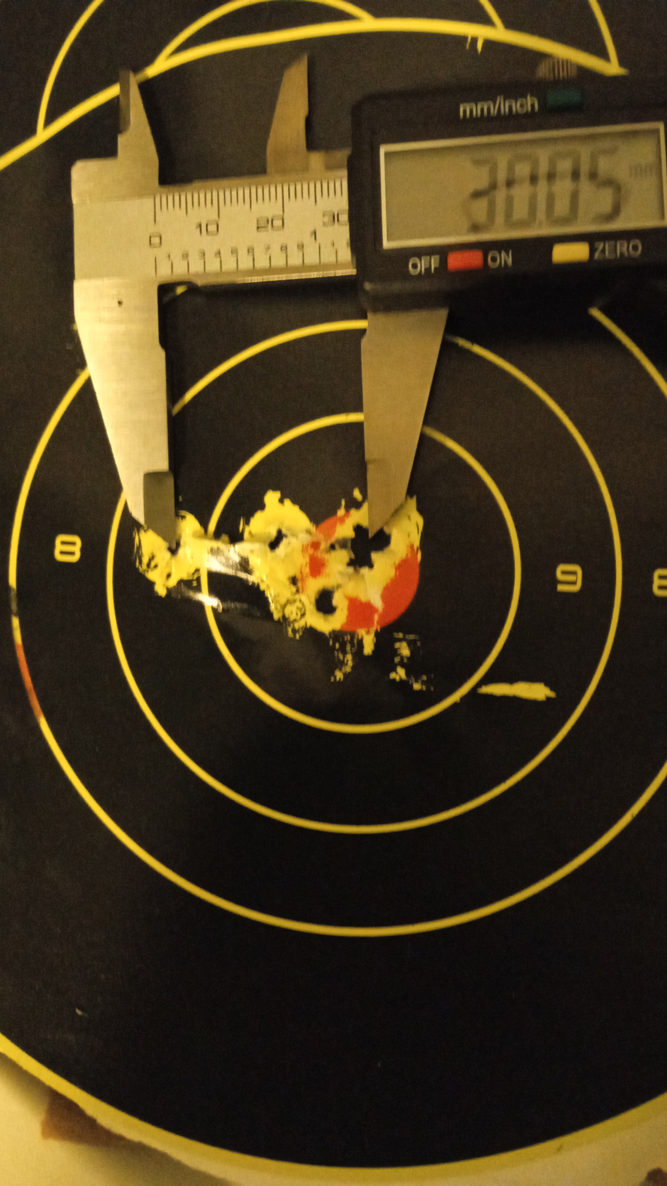

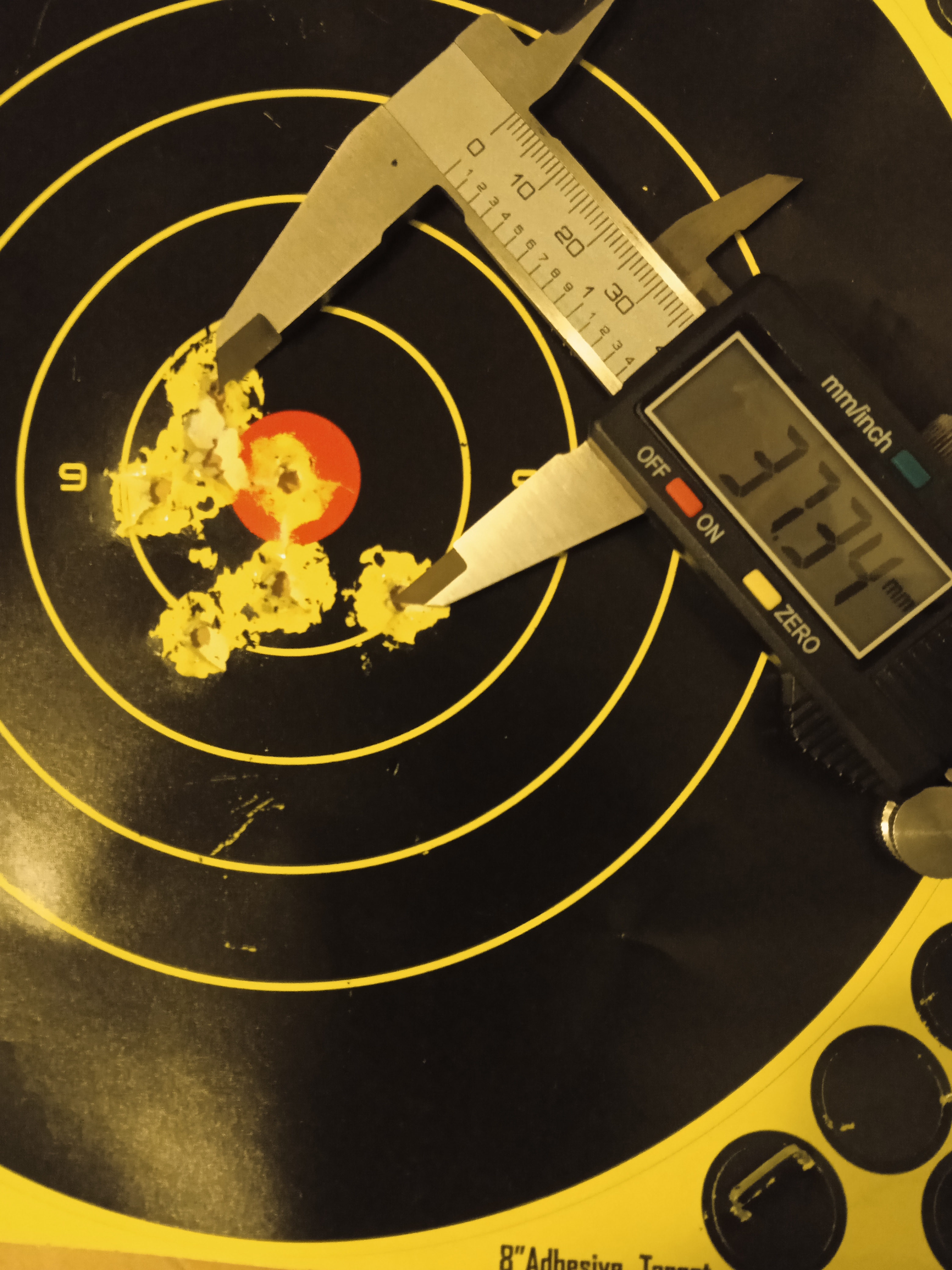

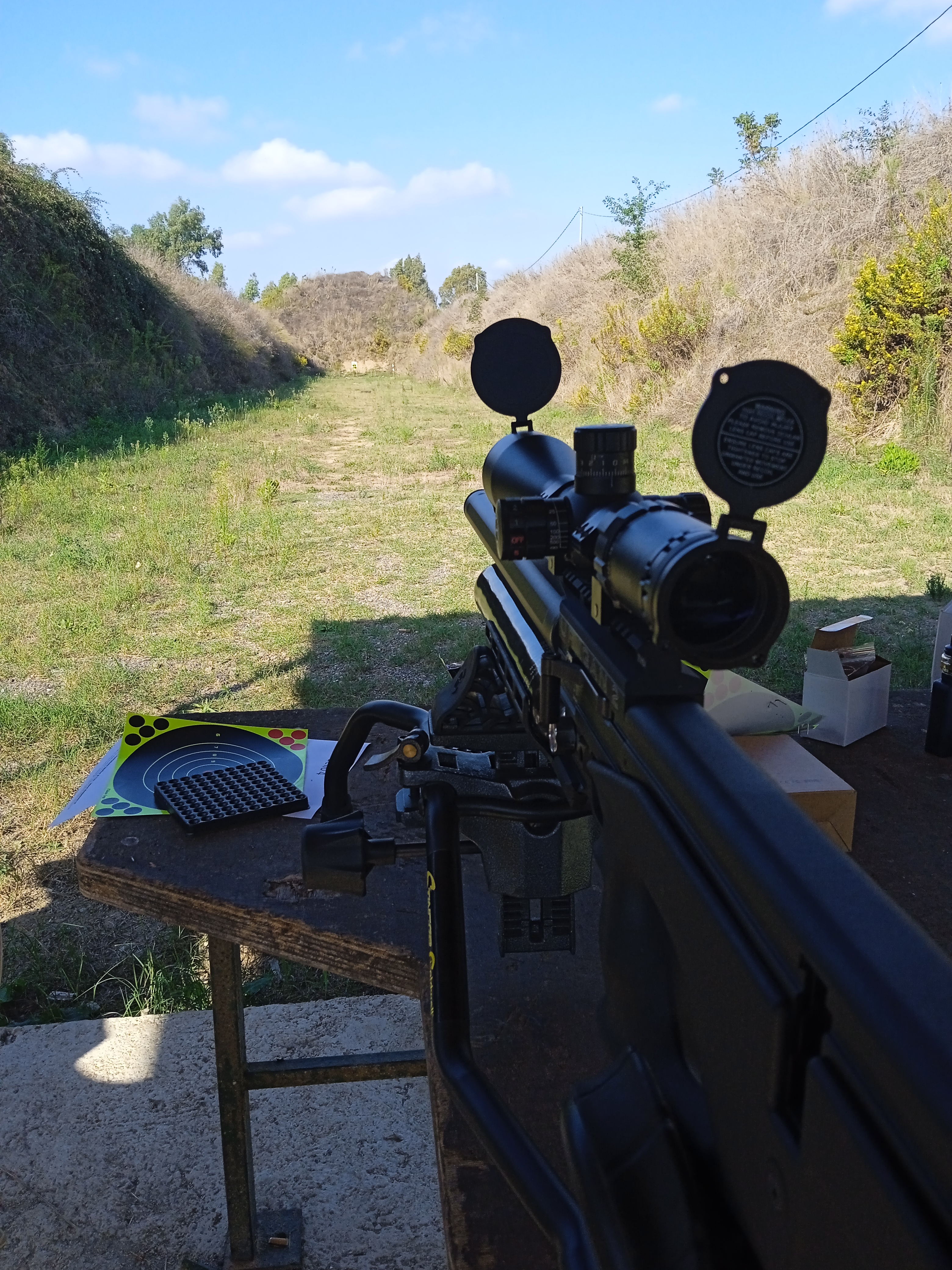

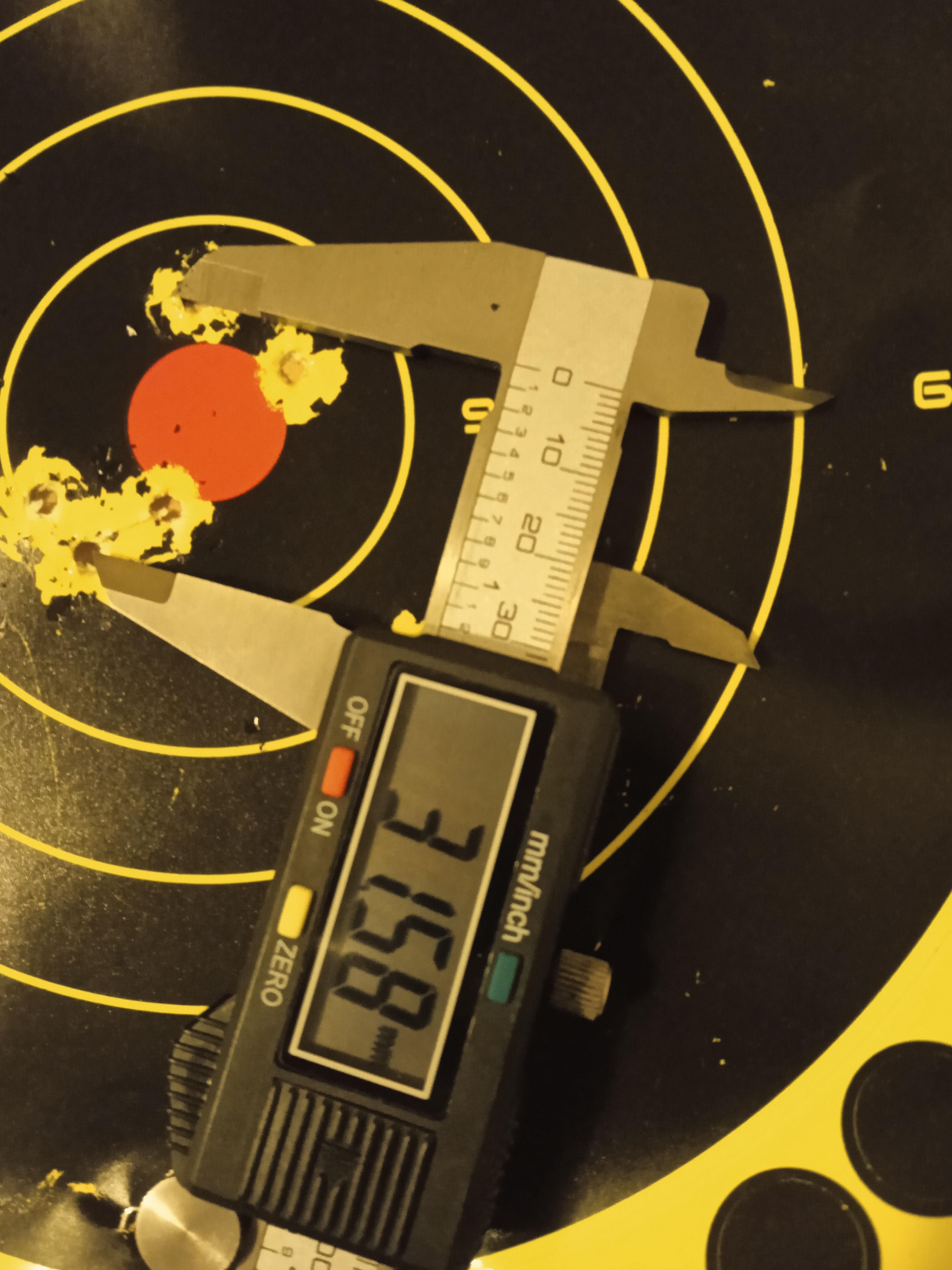

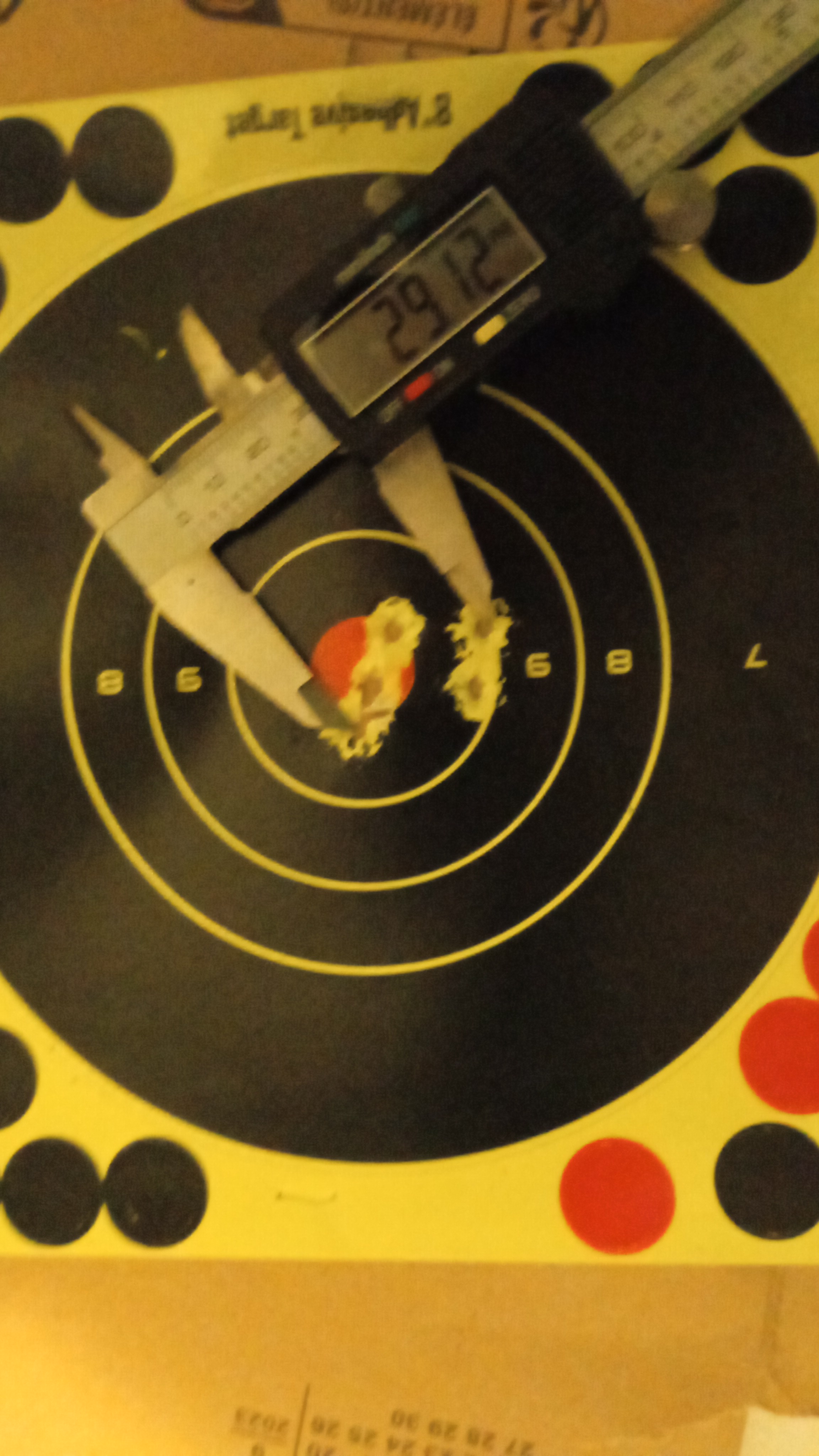

Hy . Seeing your posts, I also shot with Uragan 2 in 6.35 CALIBER with Altaros 49.5 grains, initial speed at 253 meters per second. target at 120 meters (130 y) obtaining groups of approximately 30 mm outdoors. now since these slugs develop a ballistic coefficient of 0.21 at 260 meters per second g1 function, I would be curious to see your results indoors at 250/260 velocity meters per second. I'm sure you'll group even more. I don't have an indoor line. your test would be great ballistic data for me. Thank you.

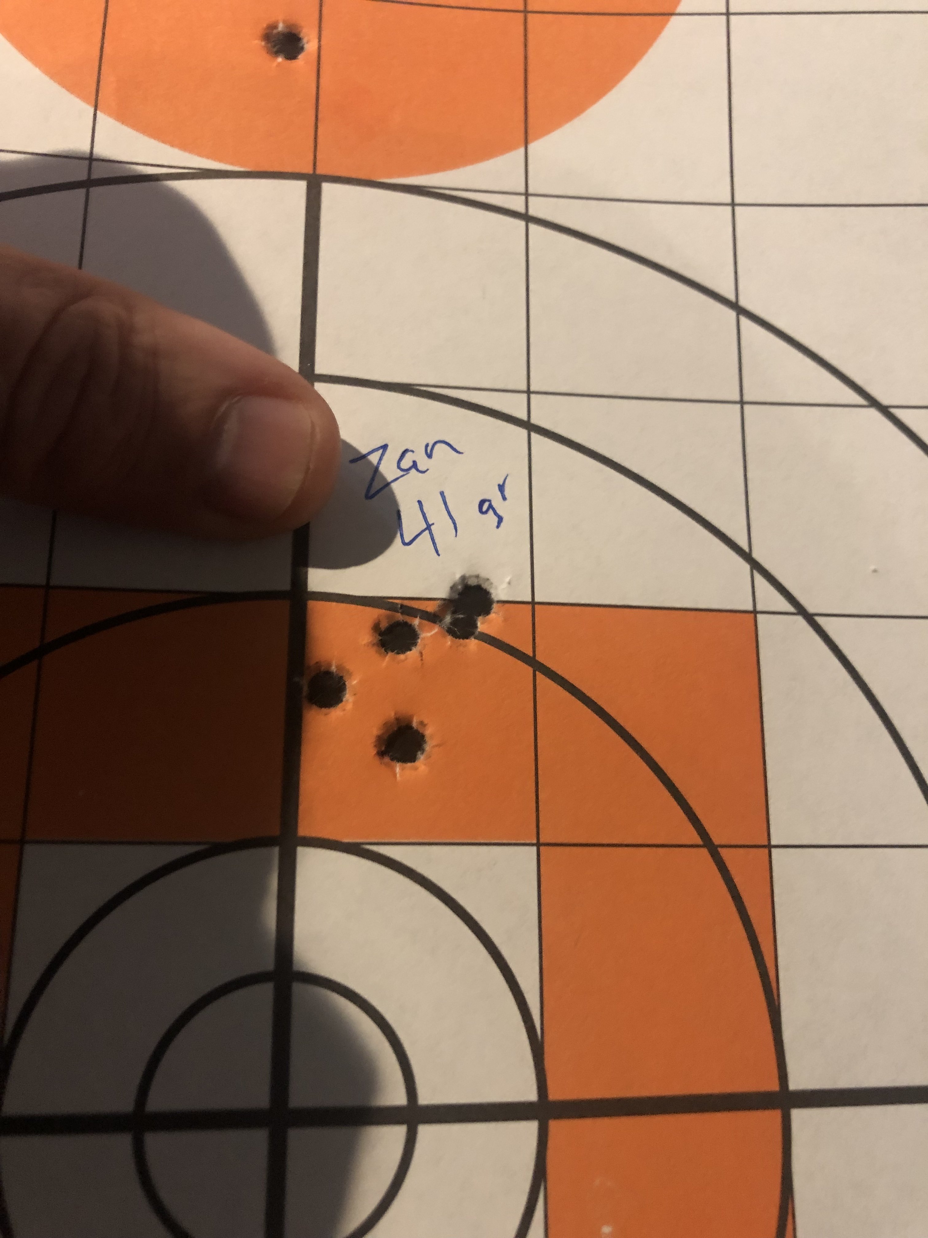

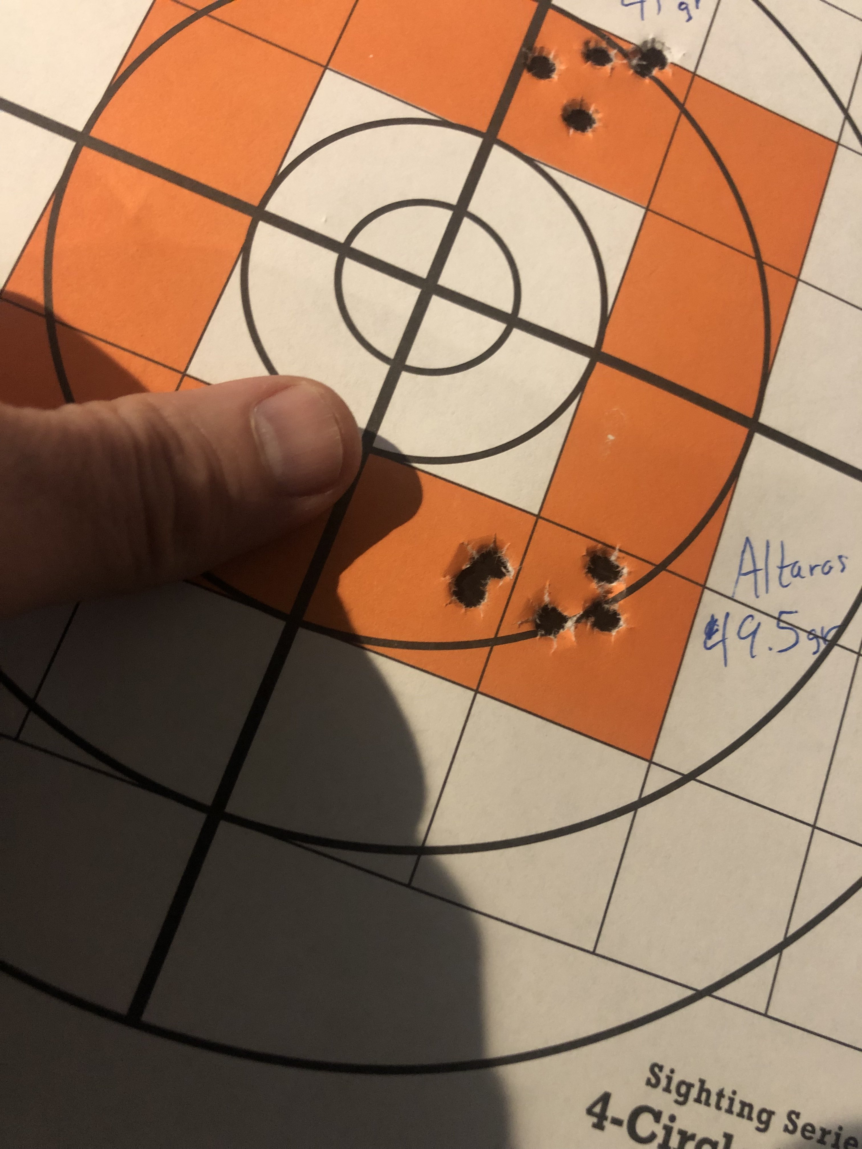

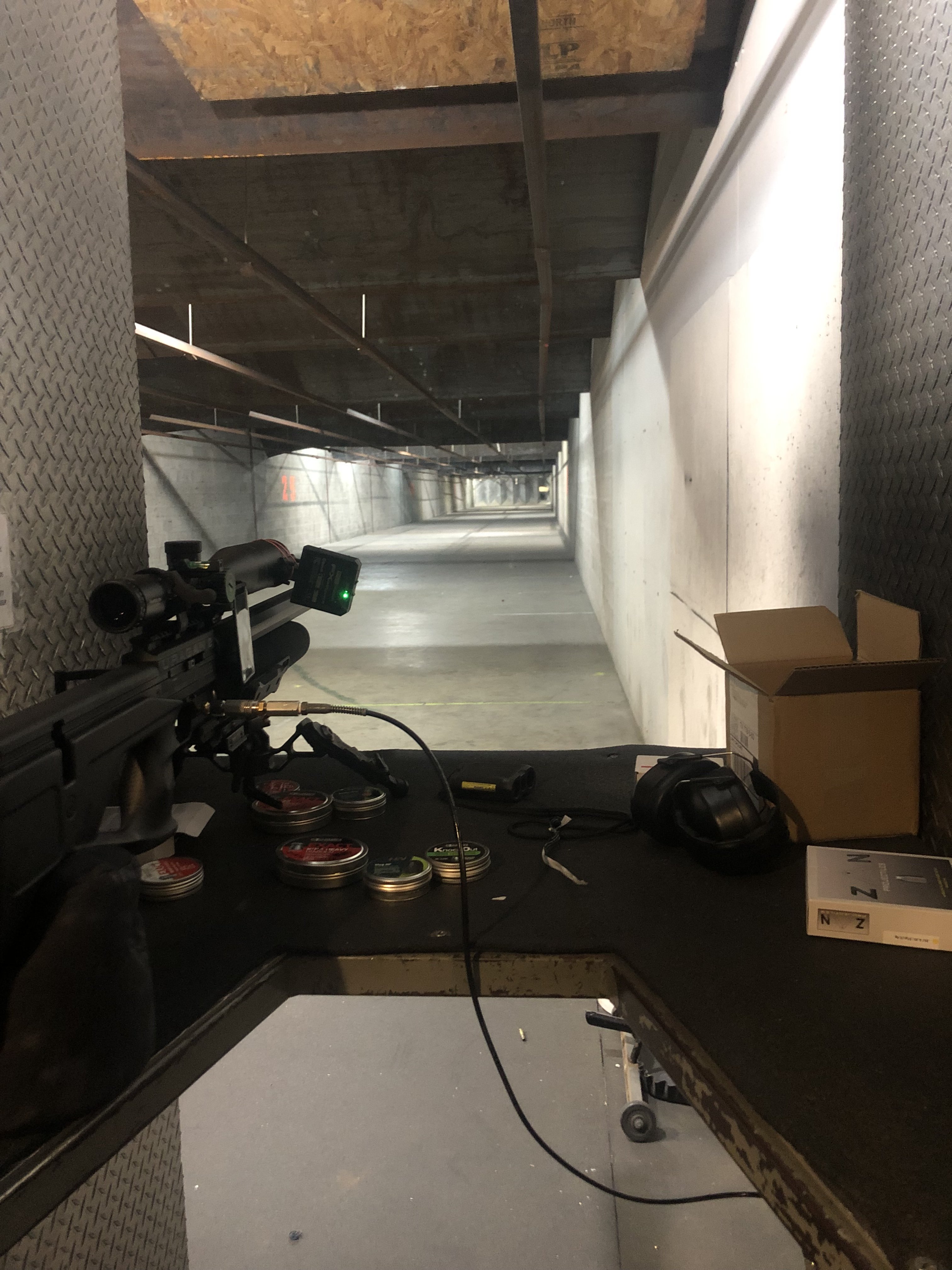

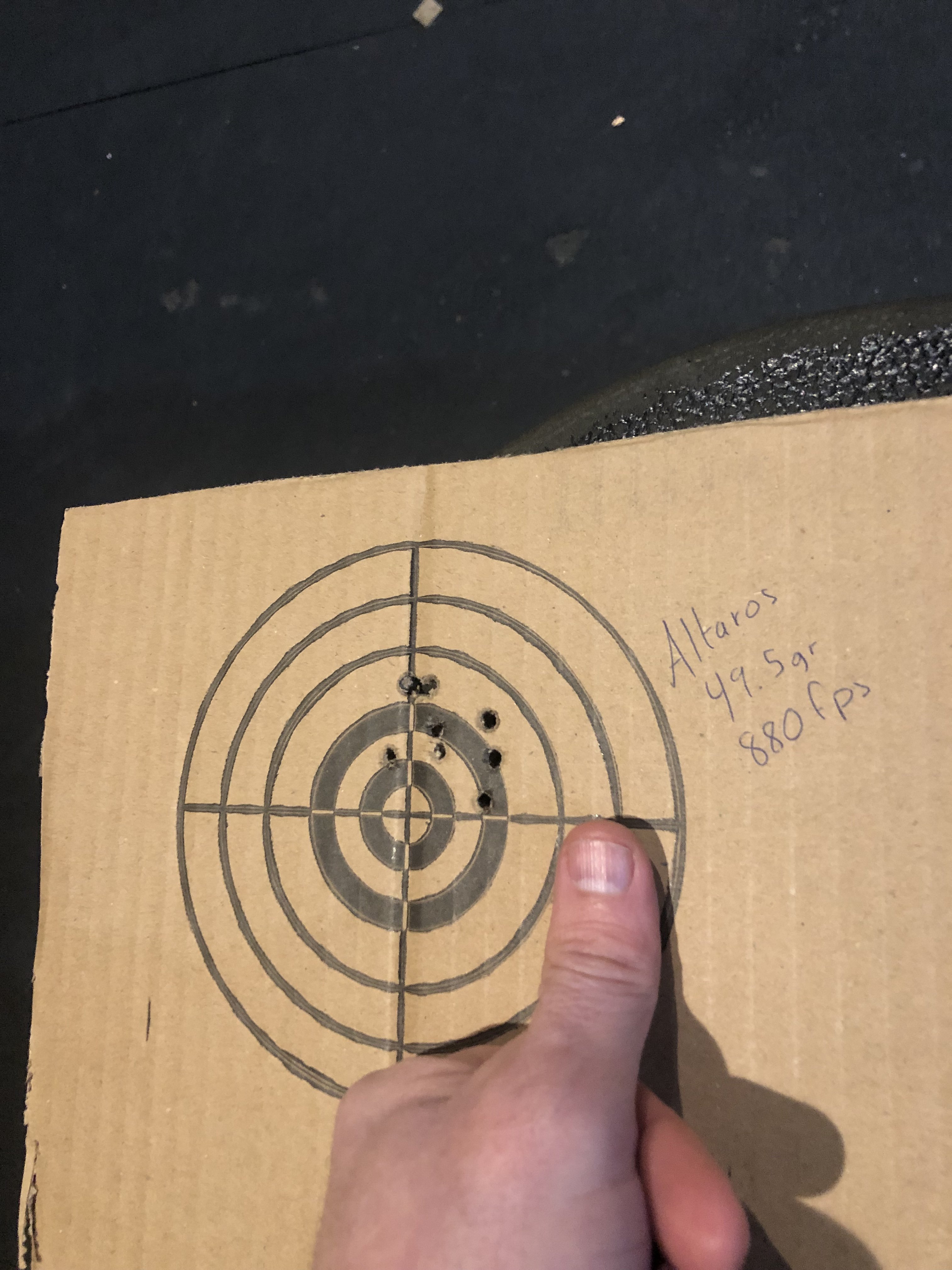

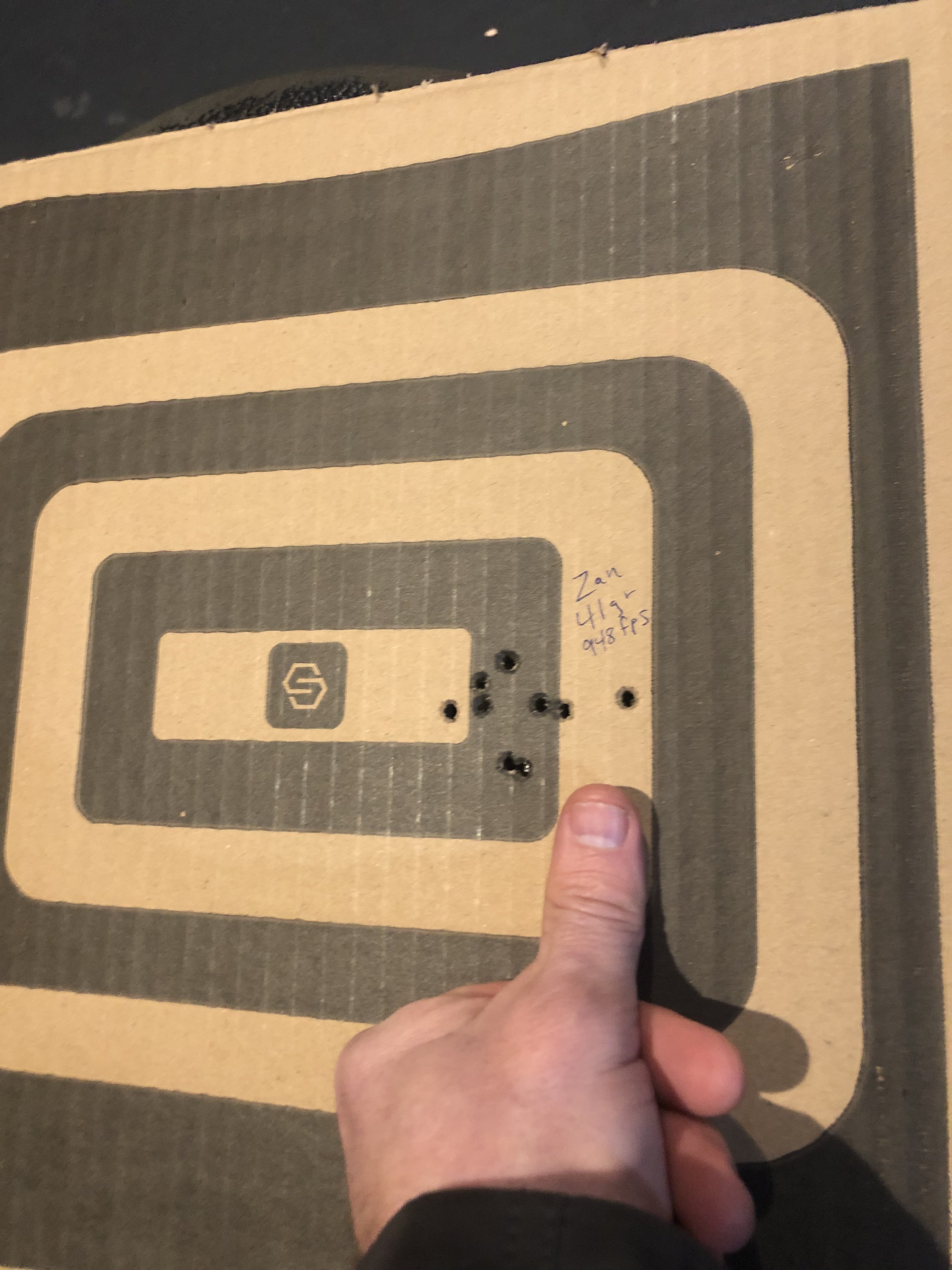

I tested 8 different slugs. The 2 best are the Zan 41gr (948 fps) and the Altaros Smooth 49.5gr (880 fps). This accuracy testing was done at an indoor range at 100 yards. You may see in the below pictures some pellet tins. These tins are only used to contain slugs as that is all I tested being this is the projectile type for my intended purpose and reason for owning this .25 U2. The pictures groups are not cherry picked. They are what I achieve in a short compressed testing session. This is a no embellishment, just fact, no unicorn sighting post. I’ve seen and you’ve seen the fairy 🧚‍♀️ tales! Take it or leave it, I’m just sharing.

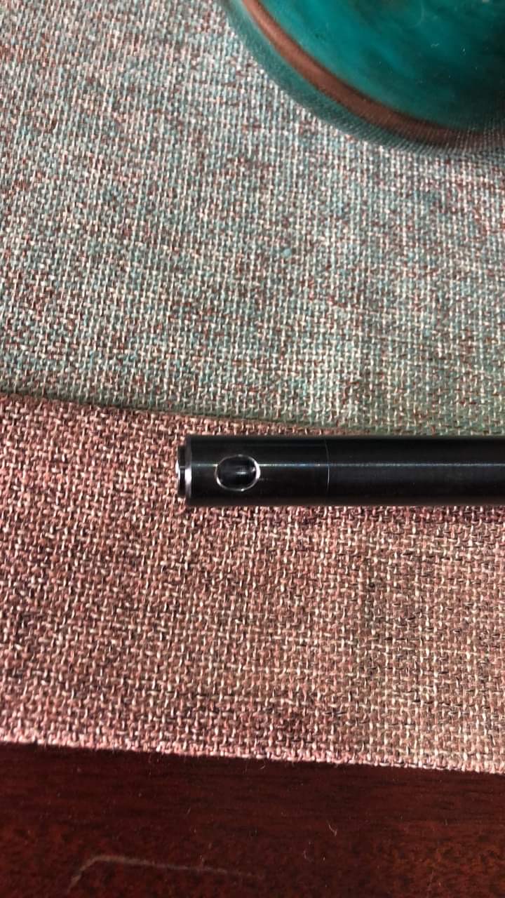

This U2 does have a slow leak! It is coming from the balanced valve. AGT has created a gen 2 valve which remedied this issue. I expect to take delivery of the gen 2 parts in 8-10 days. Cheers!
View attachment 331687View attachment 331688View attachment 331689
Great shooting.
