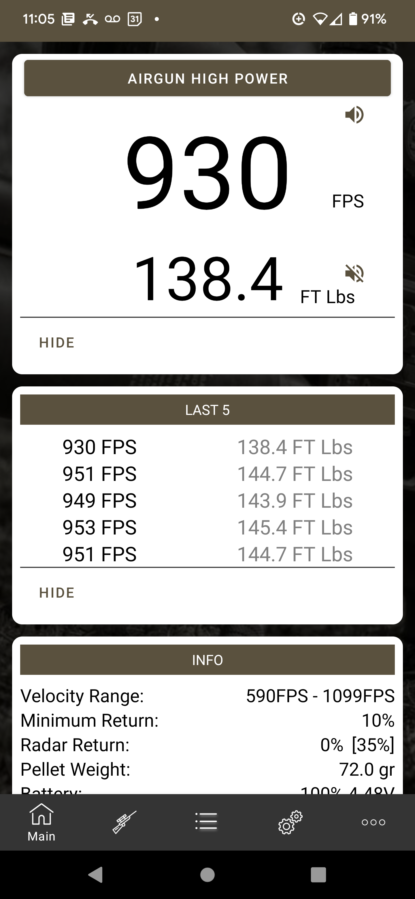

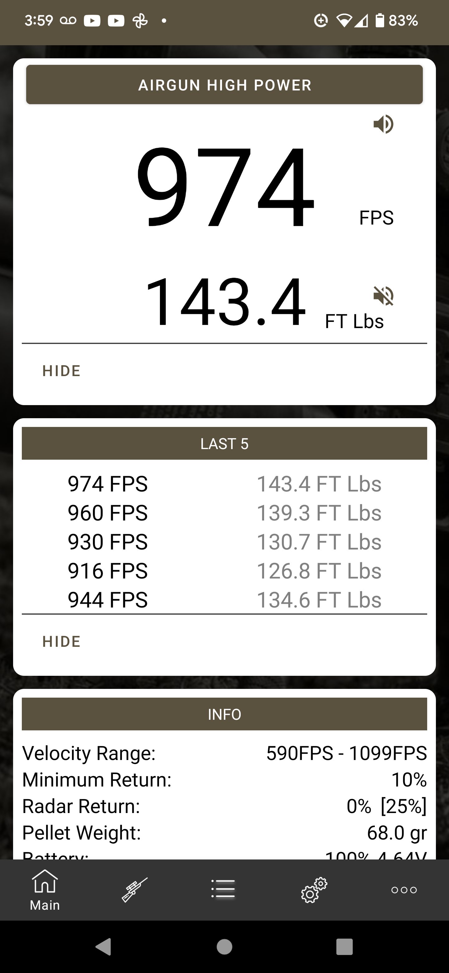

Got some sun moa groups at 35 yards.. just haven't stretched it out yet. Just got gun over 140 FPE recently as well. My plan is to shoot for max power first then tune it down to the match whichever projectile I want to pursue.

Can you show us a chrono string as well as some groups? Seems like a hell of a lot of power for 35 yard limitations (assuming you are only shooting 35 yards because thats the space you have)
This is the latest screenshot while I was doing a bunch of adjustments. Was dialing in my settings and getting setting number 7 to achieve peak velocity. I don't have any pictures of groups yet but I may be able to shoot some tomorrow and post them. At the moment I'm trying to attain the limit of the gun and work backwards. And the 35 yard range is just what I have set up in my back yard ( got like 40 acres of woods behind my fence so no worries sending lead this fast around neighbors). I don't plan to use the gun for long range but I may take it from time to time and shoot around 100 yards.
