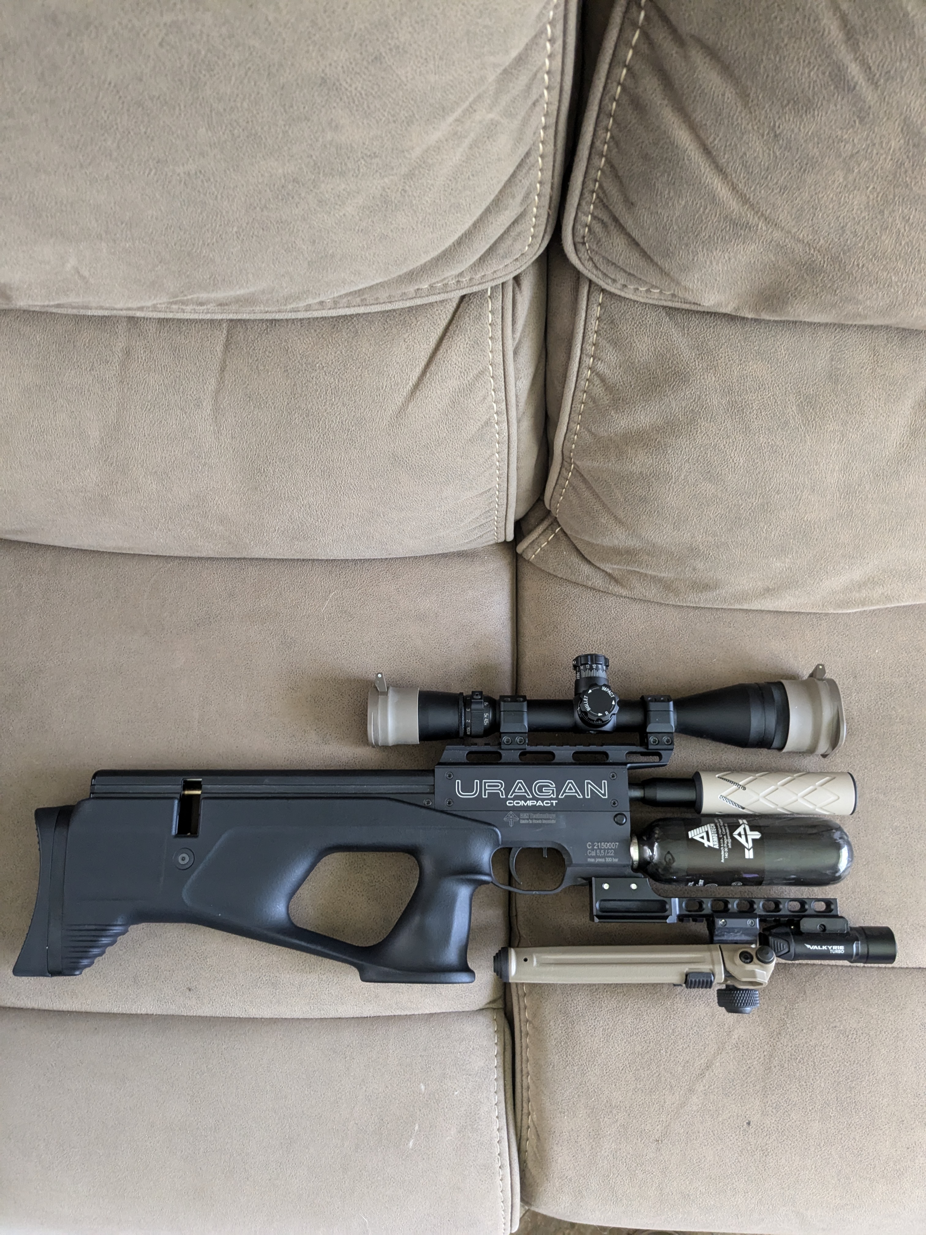

I've used red dot sights, scopes, and prism scopes on it. I shoot offhand, so the additional weight of a scope aids in holding a steady aim. The photo below shows the gun with a prism sight on it.
I did do a little grinding / sanding on the bottom, of the front of the grip. Make room for more comfort for my little finger !
