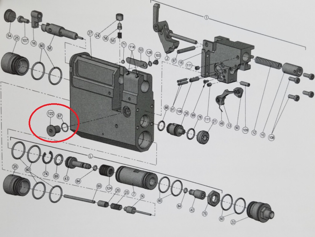

When you figure out how to safely "tune" your Uragan I will be grateful for whatever info you can share. I think I know how to do it, but don't want to mess up a good thing.
I like my lil carbon fiber Uragan.177 so much I’m going to convert it to an FT platform - yes it does get all the love
Wrenching that screw clockwise did not further increase my FPS with my 10.34 gr. pellets (maxes out at 870 with plenty of room to continue turning). Wrenching it CCW did eventually lower my FPS.
I did did learn the hard way to make sure air cylinder is COMPLETELY EMPTY before unscrewing.
Unless there is is another way to increase FPS , then .177 15.5 gr. slugs at 850 FPS won’t be achieved. Can’t get them going faster than 675 FPS by adjusting hammer spring tension alone.
