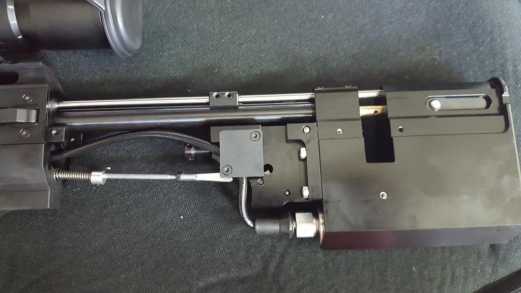

I haven't touched one yet but that appears to be the hammer spring adjuster. It's still not obvious from the pics I've seen, where the regulator sits.
I'm one to find the lowest reg pressure at which a gun will shoot the disired power while having a lighter than average cocking/firing cycle. Sometimes that means more reg pressure, sometimes less..... (and I always depressurize the action and removed the bottle (I hope there is a valve in this big boy bottle) if adjusting the reg)
Ex... My Vulcan 2 .30's firing cycle feels like the valve is getting hit with a 3 pound hammer everytime I pull the trigger. I'd love to back that out a bit but I don't want to lose any power or consitency. When time permits, I'll back the spring tension off a little and test for a while. When I get a comfortable result, I'll see how much (if any) power I lost. If too much and the accuracy at distance changed, I'd then go to the reg and raise pressure by a small amount and see what happened. It's time consuming and iterative... I don't currently have a way to test the reg outside the gun and this has been a busy spring (oddly good growing season considering the weather here the past 2 years so I'm taking full advantage).
Without having even seen a Uragan yet, I can't even guess how I would do this. Well, if that's truelly the hammer spring adjuster than can guess at that part of the puzzle. Then again, if mine has a comfortable shot cycle and does well on power and shot count.... I prob won't touch it except to make sure I have the best spring tension for consistency, if needed.
I believe the regulator sits at the connection with the back block where the hose connects too. There is no valve on the bottle, it screws right off (MAKE SURE IT IS EMPTY IF REMOVING). If you've ever messed with a Colibri, it looks very similar in design. I have not messed with regulator settings on my Uragan, only hammer spring tension.

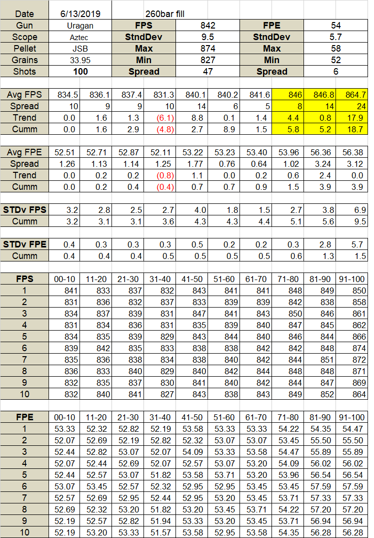

Just shot a 100 shot string from 260 bar to 125 bar. The shot string will be here soon but basics impressions are....
1. something is diff between my 2 distinct 100 shot tests but my 55y aim point was less than 2 inch diff, I had not changed shooting location or touched the chrony (other than turning the power on) Whatever it is/was created a 20fps difference in the core numbers that I can not explain.
2. String off the bottle only had a higher STdev. Not surprised.
3. While I don't know the pressure the reg is set at, I think a good number of my shoots were off the reg. YET, they were not substantially different (depending upon your expectations)
4. I won't replicate these tests completely so it might be hard to prove BUT (and I think you'll see it in my next shot string) there is most certainly room for 100 shots between 260 - 125 bar within a little smaller spread. Small tweaks...…..

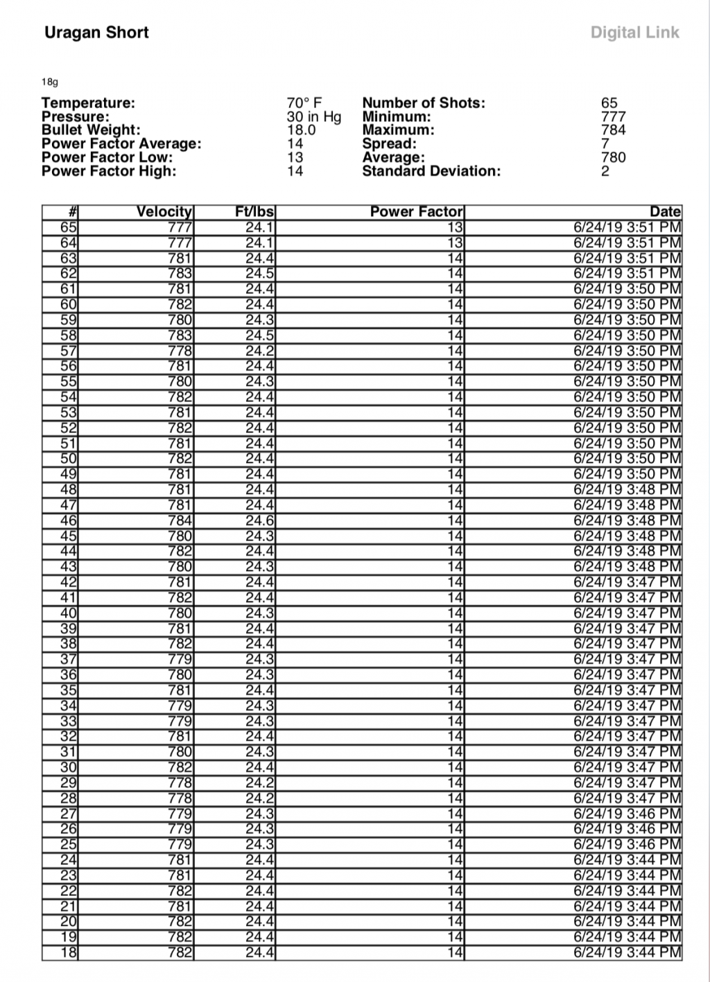

I too like my airguns to shoot using the regulator pressure as opposed to the hammer (its simply quieter & smoother). My Uragan is shooting the 18g JSB at 780 fps. I tried to adjust the HST but it only generated more noise & less efficiency.

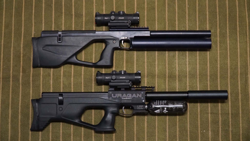

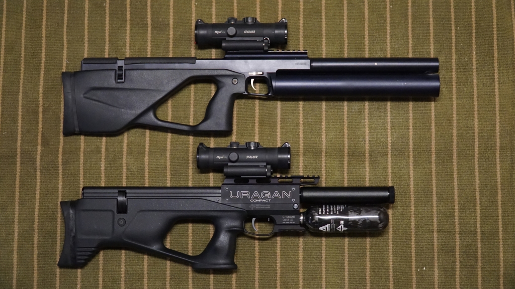

I believe the designer in one in the same. Here you can see some similarities:
The two airguns are almost identical in weight. The Colibri measures 28'' in length, while the Uragan measures 24.4'' / 30''. While hunting I probably won't need the additional moderator, but for backyard shooting it's got a little bark. The AGT moderator looks like its designed for .30 cal, so I plan on trying a more appropriately sized moderator.
From the factory my Uragan is less powerful & a bit louder than the Colibri. But in almost every other aspect it is superior: quality, craftsmanship, magazine, ease of use, stock, grip ergonomics, lever action, & design.
The regulator is performing really well straight out-of-the-box. From a 250b fill (yeah yeah... I know it can take 300b) I'm getting 65 shots at 24 fpe with an ES of 7 and an SD of 2.
