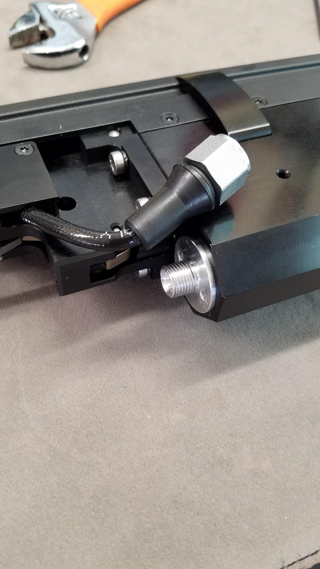

Alright, I figured it out.

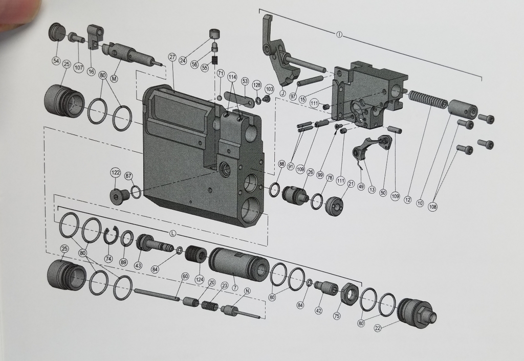

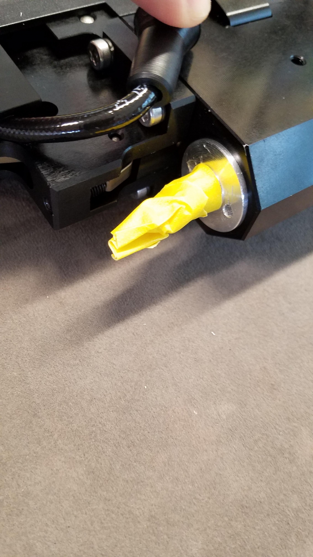

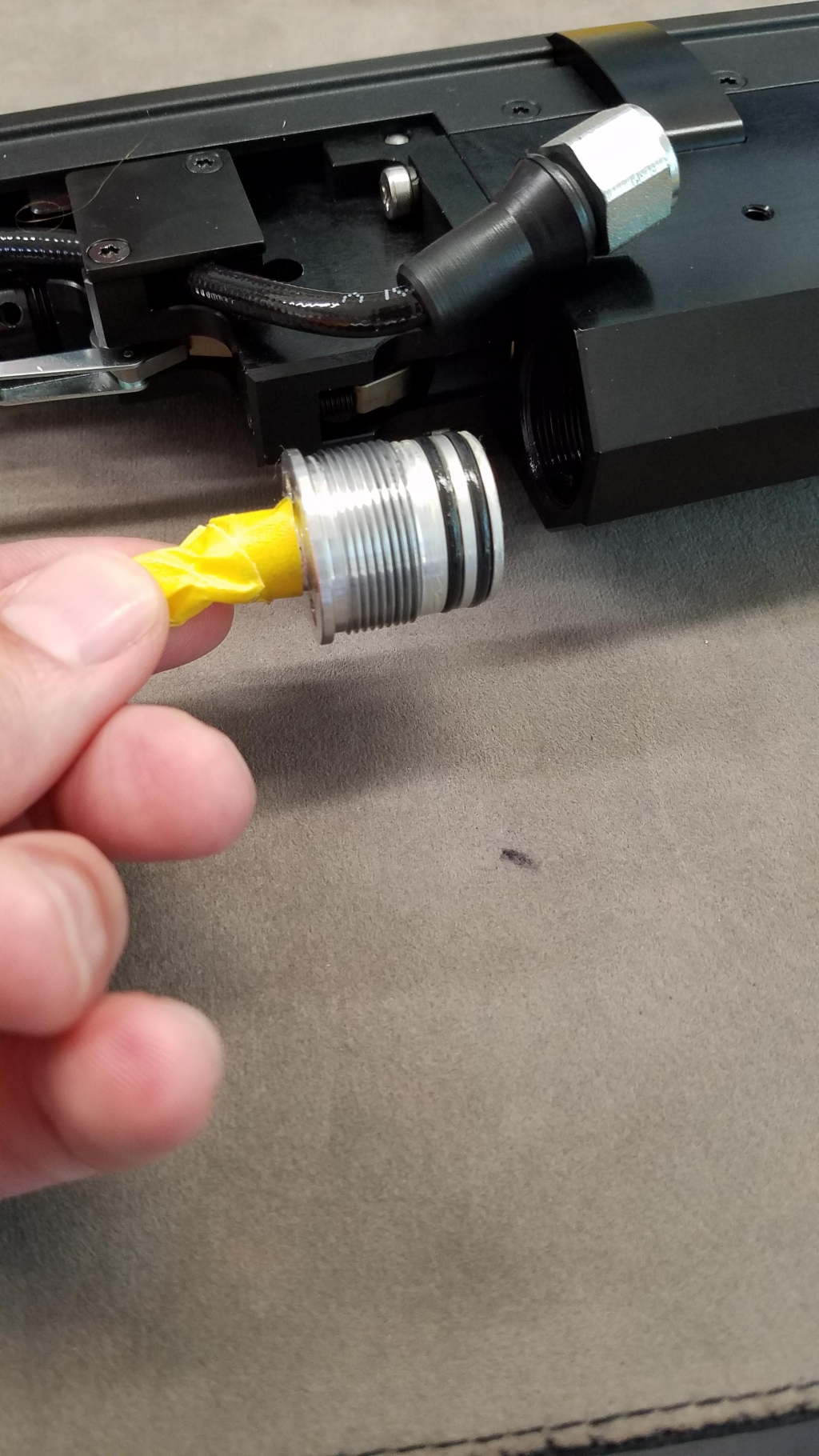

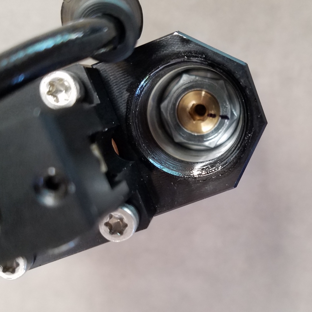

(42) is the actual adjustment that requires a 4mm hex key. Would've been a heck of a lot easier if they designed the tube to reg housing transfer port (22) to be 4mm instead of 3mm so that you didn't have to remove it to make minor adjustments.
Degas the airgun & disconnect the tube fitting
If you don't have the correct spanner wrench, protect the threads and use some needle nose pliers
Remove (22)

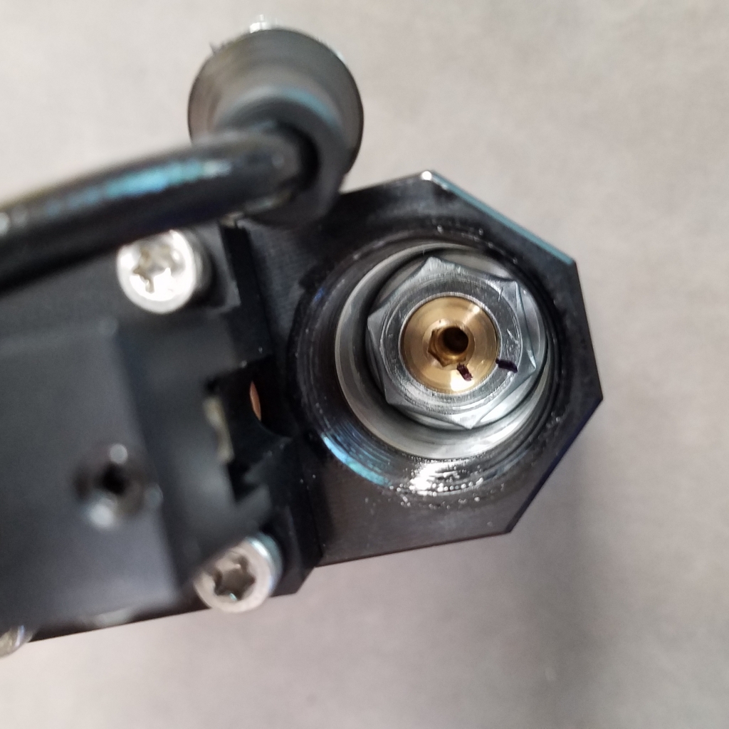

Mark your original setting
Turn CC to increase reg pressure. Note that the nut (75) is held in place by the tension from (42) and the pressure from (22). I suggest carefully holding the nut while making the adjustment and then making sure its snug.
Initially I increased the reg pressure too much (780 fps to 880 fps) so I had to go back & decrease the pressure (hence the clockwise mark)

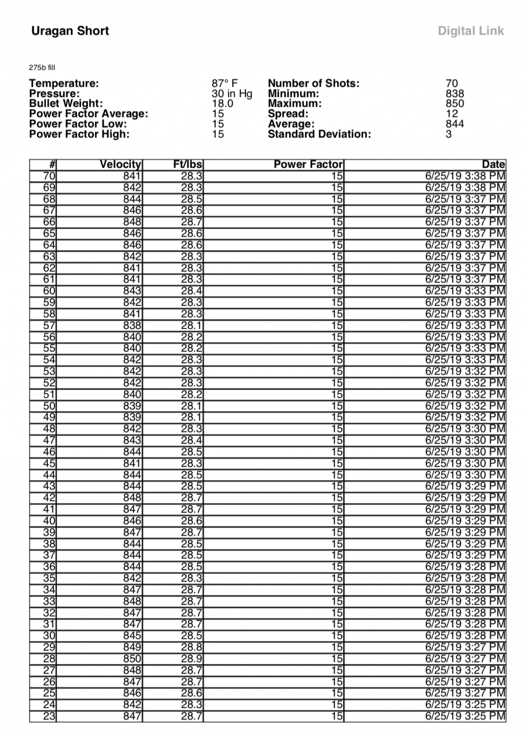

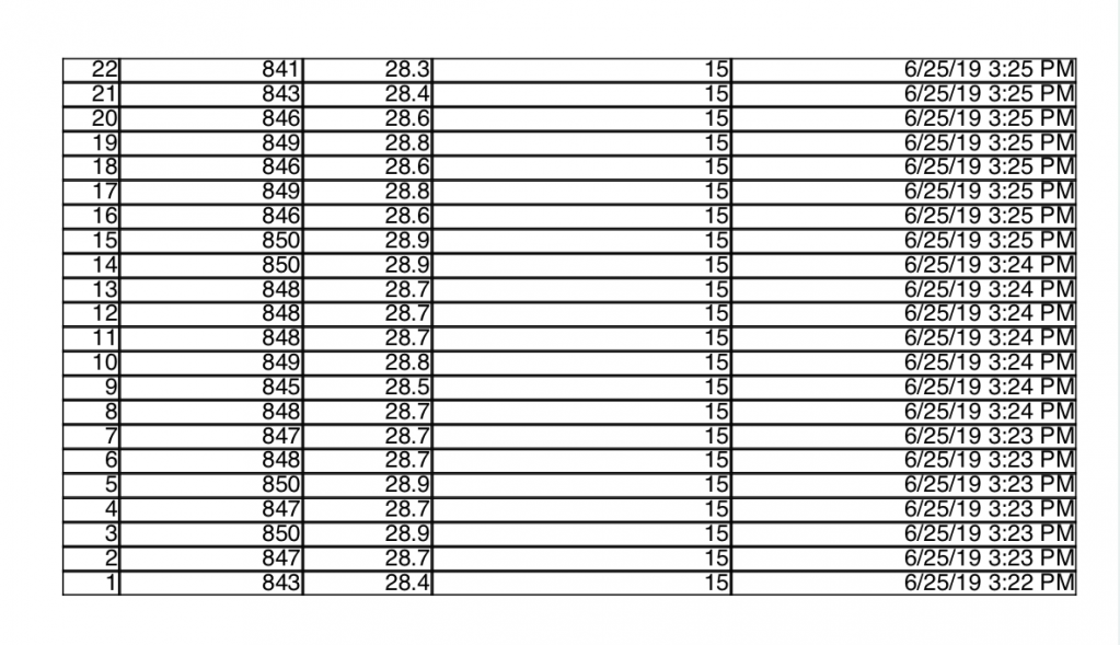

Finding the harmonious point of an airgun is always a balancing act. Typically I find my airguns to be most harmonious when they are driven by the regulator pressure. By that I mean the regulator has slightly more influence on the shot than the hammer (and the hammer isn't hitting or bouncing) silly hard to open the valve.
My target velocity is 830 fps with .22 JSB 18g pellets (to match my Colibri & Leshiy).
This string was an average of 14 fps hotter than I'd like, but when I decreased the HST it was a little out of balance (to the ear). The reg pressure vs the HST is spot on because after the 70th shot it drops about 10 fps per shot.
1561502858_11765460025d12a48a6658c3.20408282_Screen Shot 2019-06-25 at 5.46.34 PM.png
1561502858_13908357305d12a48ad16643.04635250_Screen Shot 2019-06-25 at 5.47.21 PM.png
Perhaps someday I'll find the time to reduce the regulator pressure just a hair. But for the time being I'm pretty happy with 70 shots @ 844 fps (28.5 FPE) on a 275b fill. Realistically I'll normally fill to about 250b, which I think was about 12 less shots.

when you turn CC the reg the speed goes up without turn the HST
Yes you'll have to adjust your HST as well. Remember the goal is to find a balance between the reg & HST.
From the factory my HST did almost nothing for increasing the velocity.
Are you sure that CW you increase the bar ?
At most guns, except FX regs, you decrease CW
At mine R5M after 7 "minutes" CW, from 875 fps goes to 920 fps without touch the HST
The same at cricket, P15, Taipan, Huma regs, etc
Hi Mike,thanks for all the info you have so far discovered and put here for all us Uragan owners to learn.I have just got my Uragan ( .22 long ) here in the UK,like you i am disappointed with the poor information in the manual.I would like to know how to tweak and set up my new gun.My manual doe's not even show me how to adjust the trigger (first stage,second stage,etc).My manual ,like yours i think,is just a load of numbers on a schematic/map of the gun.On the schematic of the gun,in this post,would i be right in thinking part No109 is the second stage adjuster screw. ?.Please keep us up to date with any more info you discover about your gun ,even the smallest adjustments as some of us "Newbies" to PCP's are reluctant to tinker in case we void the warranty on a new gun.Thanks for listening.MikeC.

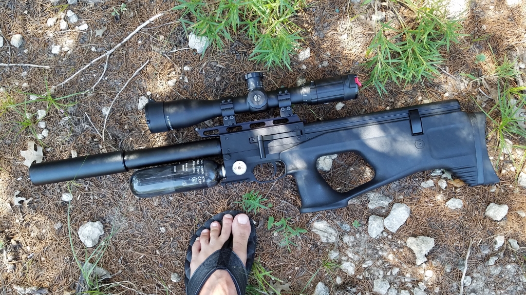

Got to do a bit of shooting this morning. Basically zeroing my scope and pellet culling before the heat got unbearable.
My Uragan short likes pellets in this order:
  1. JSB 18g (840fps)

I've been staring at the diagram Michael posted above and at the back half of my trigger group (sear is just above the regulator fitting) and don't SEE any way to adjust it with the screws I hoped to find. I haven't been motivated to disassemble that area. My trigger is ok but there seems to be room on the sear engagement to adjust for a lighter/shorter release. I might try adjusting the length of the trigger rod a half turn one day when I have more time. If I do that, I'll report back.
