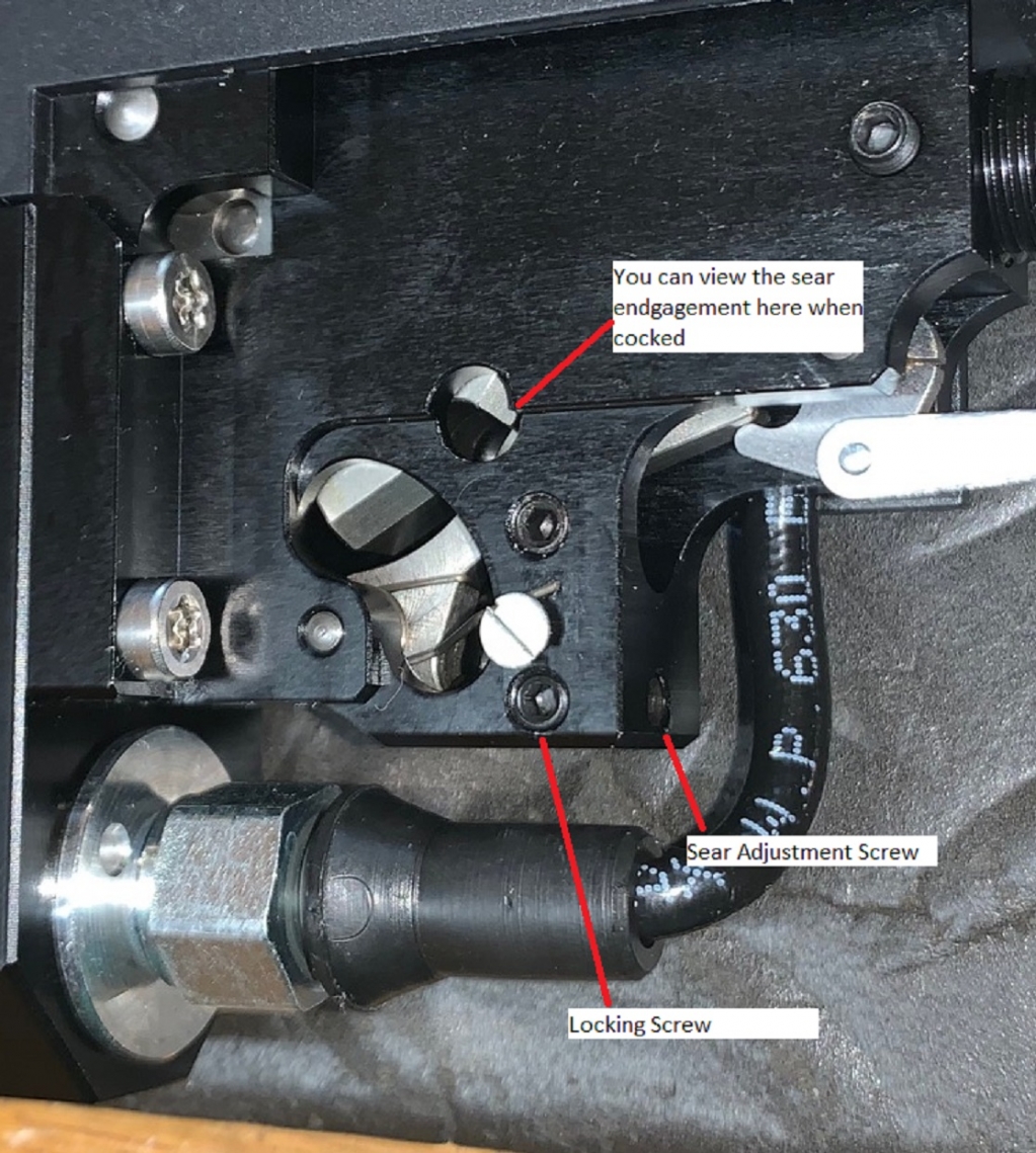

i found out how to adjust the trigger,,,,where the tube goes into the back of the gun,,,just above that is a grub screw,,,at the side is a locking grub screw,,,undoo the locking grub screw and turn the sear adjusting grub screw clockwise to reduce creep,,,allwaise test the gun for accidental let off after adjustment,,ie,,,bash it about a bit to see if it goes off on its own,,,you can view the sear as you adjust it and see how much shelf you have left,,,hope this helps any one
jrayner ,mccastro (mikeC) here from the UK.Just got my Uragan .22 (long).I would also like to adjust the second stage of my trigger (due to old injury to last pad of my trigger finger).I read with interest your posting about how and where to adjust said trigger.I'm just not clear on your instructions,so for a thick head like me,who does not want to get it wrong and blow the warranty on a new gun, could you list the part No's (as on the Manual drawing above) please. Cheers MikeC.
on page 9,,,,,loosen locking stud 111,,,,,,then adjust stud clockwise109,,,,,you will be able to see the shear poin if you face the gun to the rite,,,it only takes a very small amount of adjustment,,once set,,,tap the gun viggourusly to make sure it dont go off,,dont blame me if you get it wrong,,lol,,,or i have got it wrong,,,,,,let me know how you get on pls
Just a different visual for the sear/2nd stage adjustment. If I had had my reading glasses on I would have been fine earlier but many thanks to jrayner ! As always, don't mess with this unless you are confident that you can get a safe result.
Thanks to jrayner and JCD for the quick reply.Those instructions , part No's and photo make so much more sense to me . I will be very careful as i adjust and make sure i give the gun a good "bump" test after each tweek.Keep the good info coming guys, as i think a lot of us new Uragan owners are in the same boat as i, with the poor manual.Cheers MikeC. P.S. will keep you fella's informed of changes and anything i learn.
I never mentioned how my adjustment went.... Simple answer, went fine. Trigger isn't really any lighter, didn't really expect it to be. It breaks a little cleaner though. I could adjust it bit a bit more but I'll hold off. I might take a little back off the HS and that should lessen the pressure on the sear.
The MKII's shoot fine but a liitle squirrely (at 900fps) sometimes now that I've played back some video in slow-mo I took when I had the right light. I don't want to shoot them harder... so I'll back the HS down again and see if they settle down.
good to hear jcd,,,,,,,,and that pic is spot on,,,well done,,,have you come up with any ideas on how to fit a 2 point sling yet,,?
