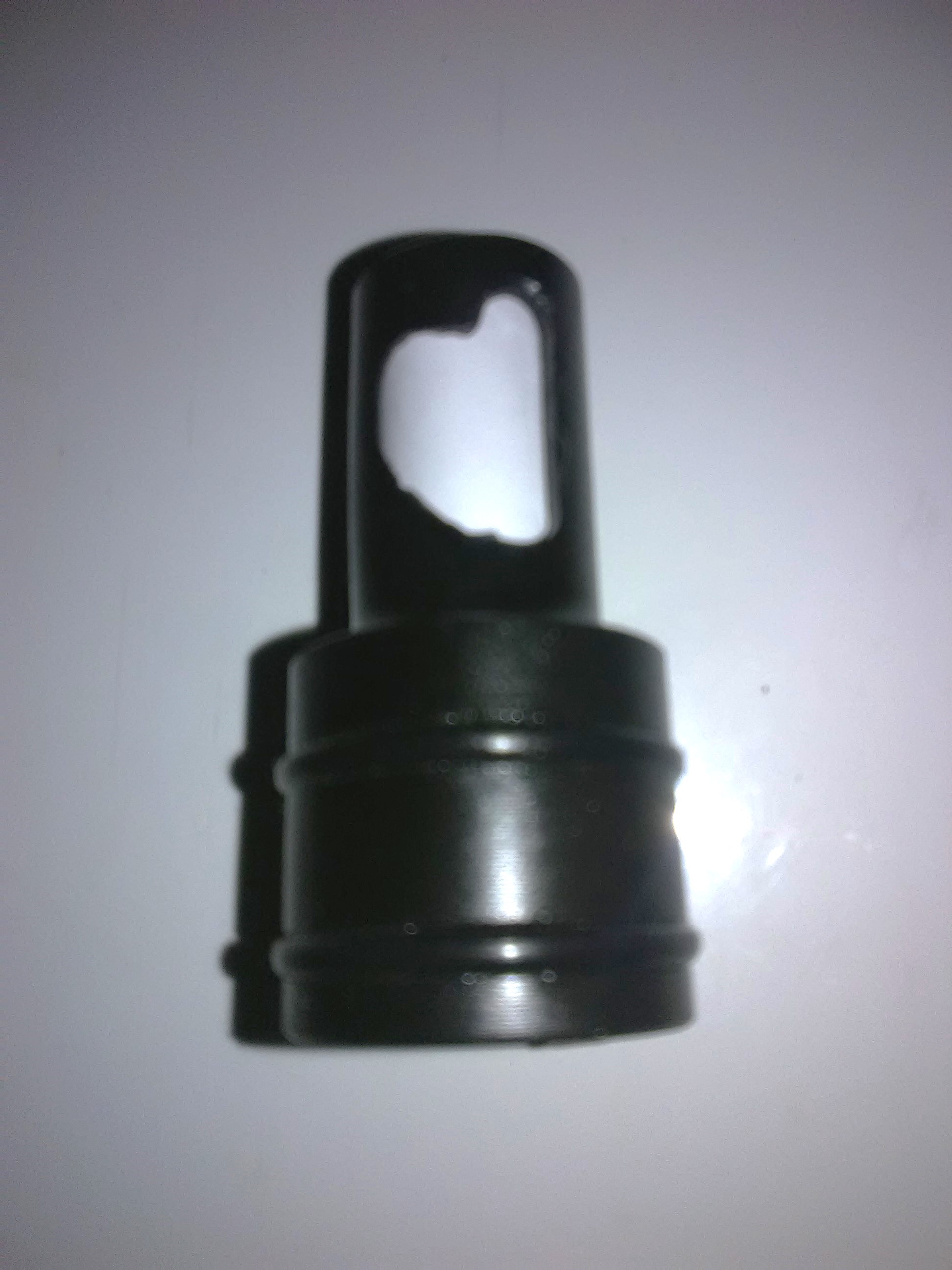

Just to say.. All new Vulcans are now equiped with "depinger" from the factory ! ;)
Agreed, mine had one but investigated why there's still a considerable "ping," as compared to U2. Photo is OEM depinger, opening should be consistent oval shape. Replaced with another from Talon Tunes, "ping" still noticeable. Nature of the beast, I guess, likely a non-issue if I didn't have U2 to compare side-by-side. WM
