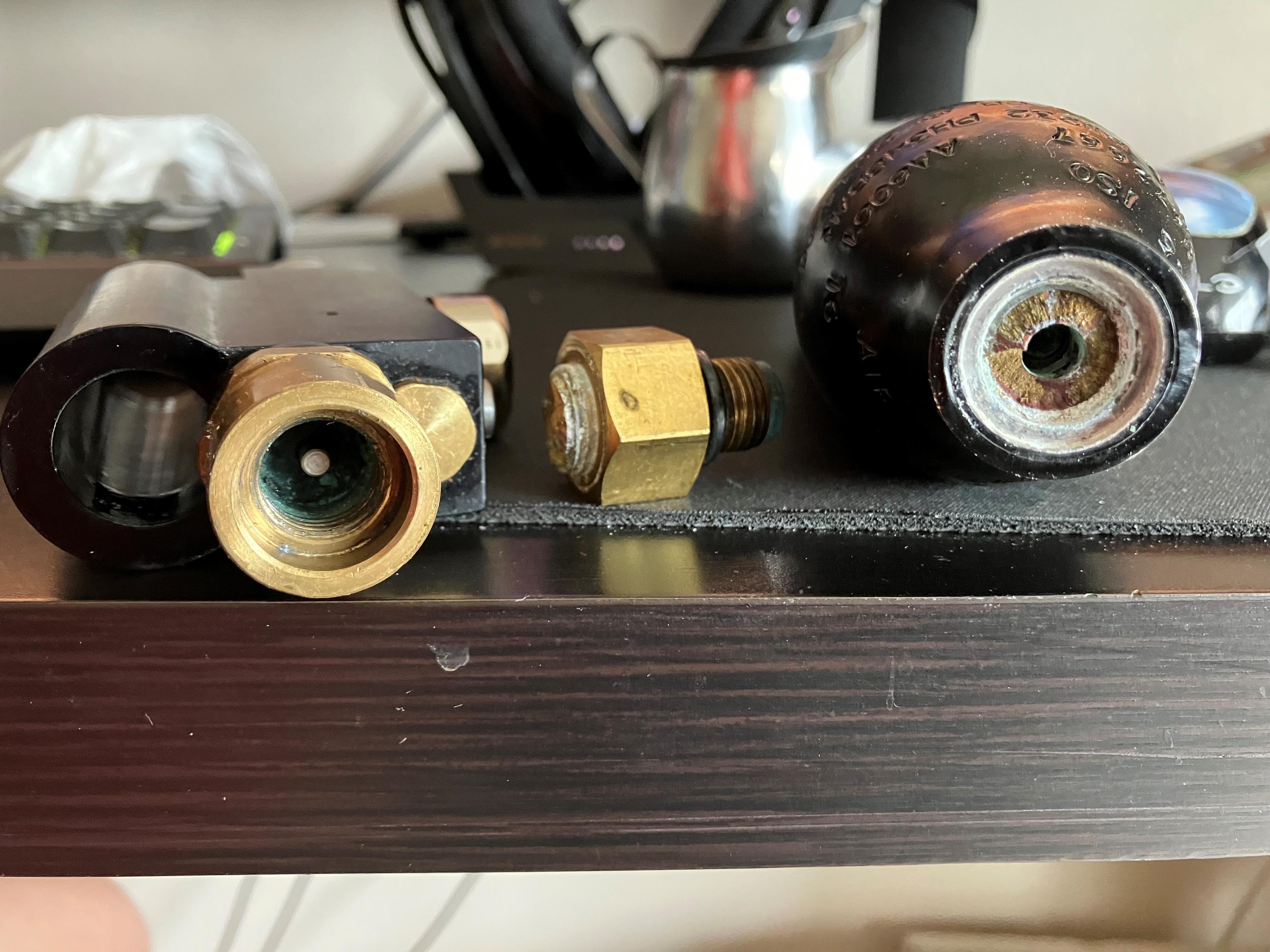

This is what my Benjamin hand pump did to my BSA R10:
Watch out for condensation getting through to the bottle. I think the BSA was affected more as I could pump it up to 225/250 bar ... creating more heat.
