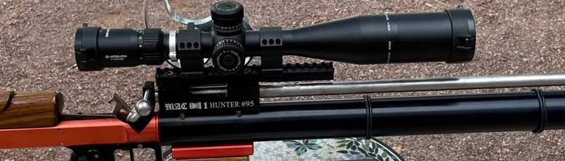

I went to fill my USFT and the fill port is leaking upon filling. I'm guessing it is an easy fix if I can find the part. Where would one acquire this part. If even possible.
Would love to see pics of the USFT.
Picture is probably 10 years old
