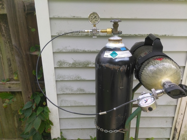

I used N2 as a backup to my paintball shop for about 2 years. The air we breath is 88% N2 so there's not a big difference except that N2 is dryer so don't worry about that. I paid $8 per month rental and $45 for refills. I did have to bring the depleted cylinder in and exchange it because the company rented from (Palmers Welding Supplies) did not deliver to sub divisions. They are 444 CF steel cylinders and are heavy. I didn't use a regulator because I filled my tanks from the N2 cylinder and it's easy to control the output and not go over 4500 psi to the tank.
Tom -The number of times I filled will probably be different than most. I basically used it when the paintball shop was low on air or had too many customers to fill my tank. Out of the two years I rented it I only had to fill it up 3 times. The tank in the picture is a 60 min fireman tank so 88 cf size. I do have several PCPs (19), and some have 250 bar (almost 3600 psi) fill pressure so I did shoot a whole lot and used a lot of air. The tanks weigh well over 300 lbs. But I was able to get it on my truck without help.
