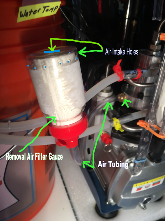

I agree that having some sort of inflow measurement would be beneficial. Although from the feedback from my post it doesn't appear like people agree. I don't know what's up with that. Seems to be a no brainier.
I like the idea of what your truck has to monitor the air filter. Can this be adapted to the YH?
I no longer use the "gold thimble" filter that came with the YH and made my own which I find less restrictive and I can change the filter as needed.

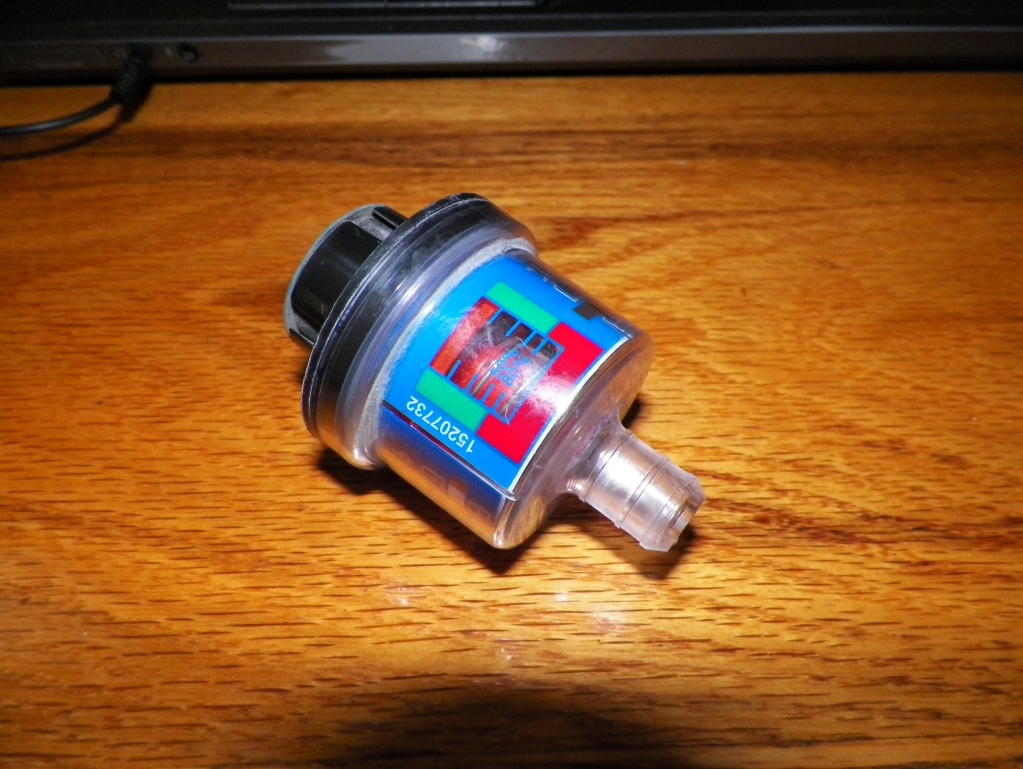

It's called an "Air Filter Indicator" or "Airflow Indicator". This one is on a 2006 Chevy Silverado. I looked the part up and they want 40 bucks for it but I'd bet i could be found cheaper especially if you had any junkyards in your area. Also aftermarket companies might be cheaper. It can be plumbed into the intake hose pretty easily as it has a 1/2" hose barb for connection.
It's been awhile since I've seen these. I can remember seeing them mostly on GM & Ford mostly.
I'll look for one at Wal Mart etc.
