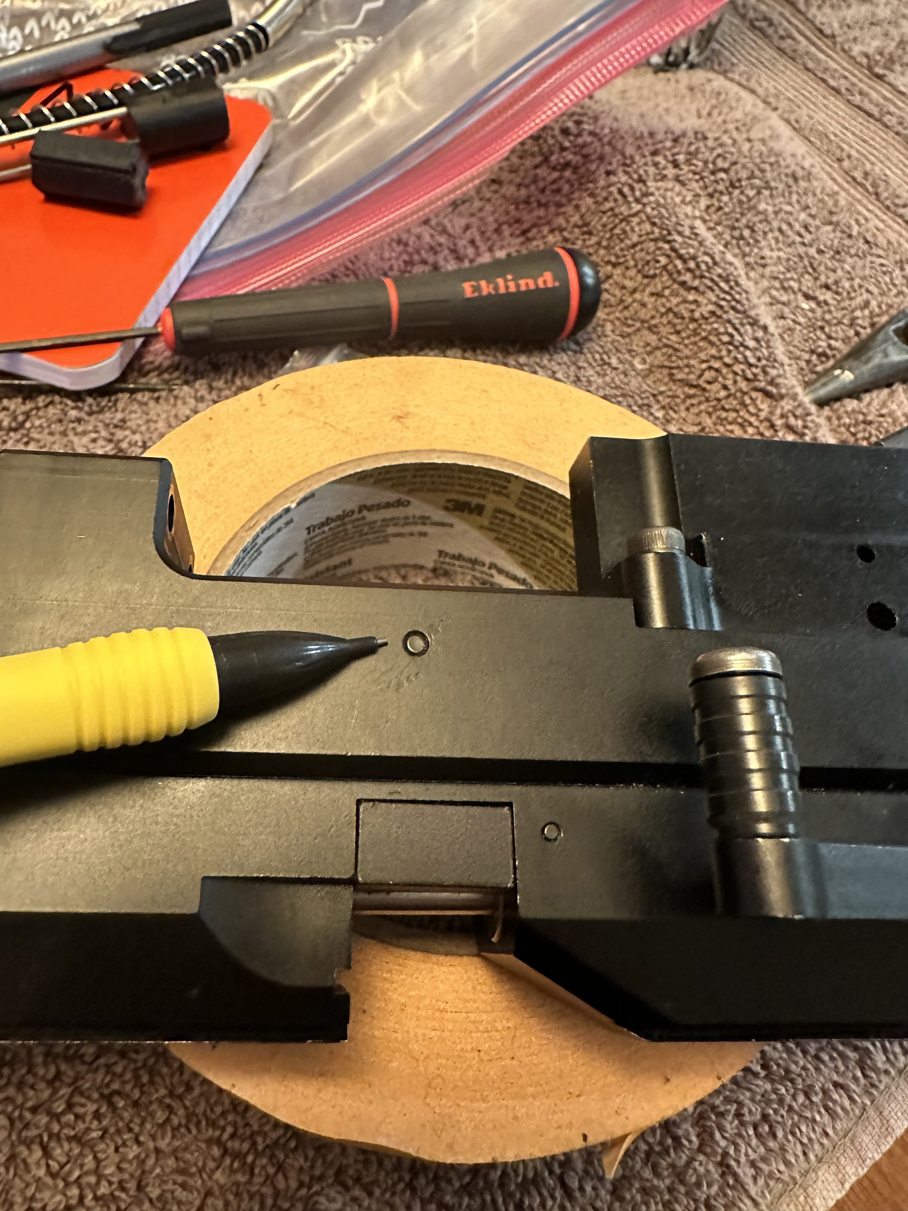

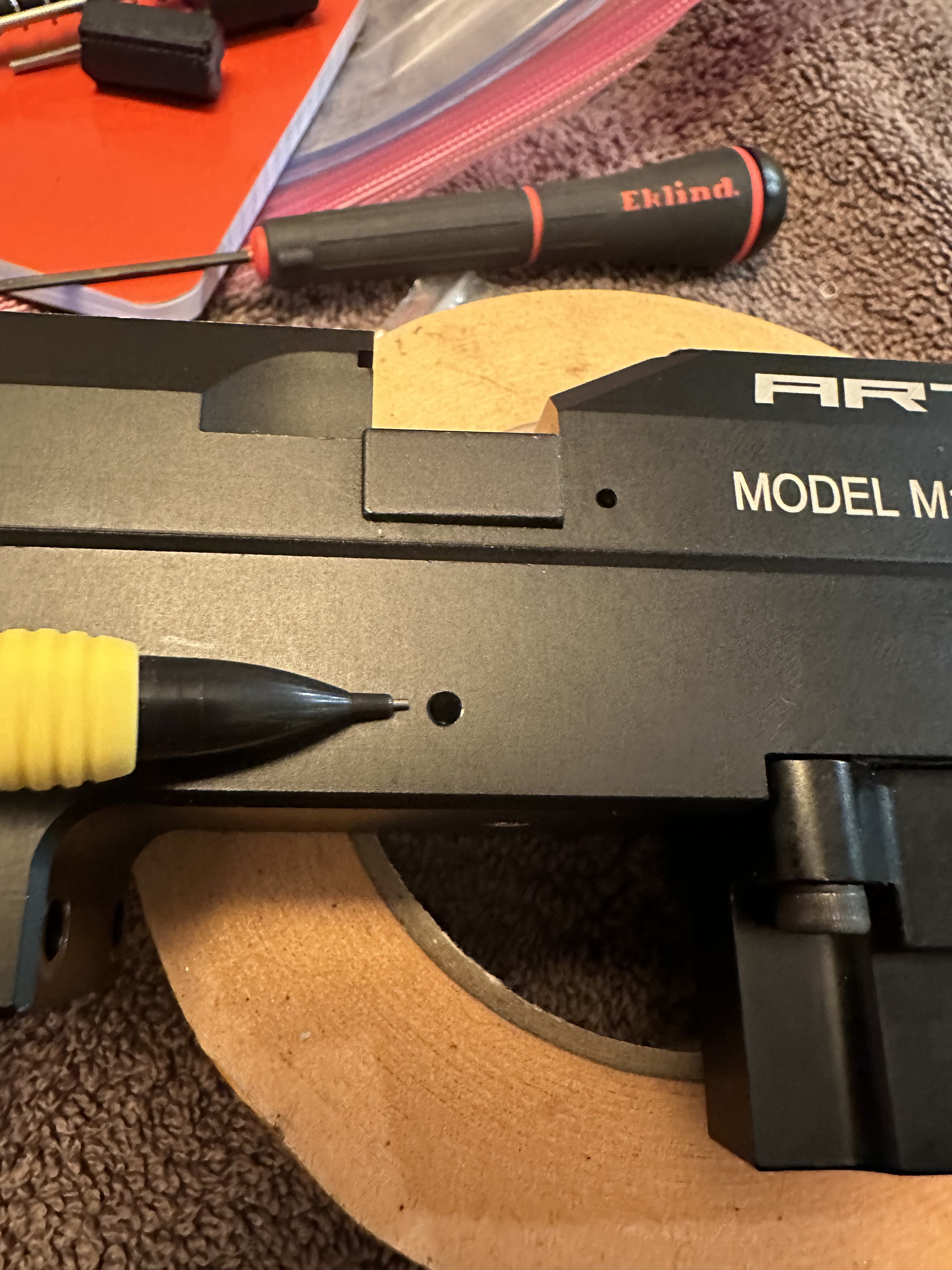

Hi all, noticing some damage at both ends of the stem. Trying to figure out muzzle velocity inconsistencies. I’ve already cleaned the regulator and put a Delrin seat in. That took away all the creep but now I’m noticing fairly consistent 4 -5 fps spread with an occasional 20 to 25 feet velocity difference every seven shots or so. I thought maybe the valve stem was sticking after seeing these marks on it. Any insight would be grateful.
