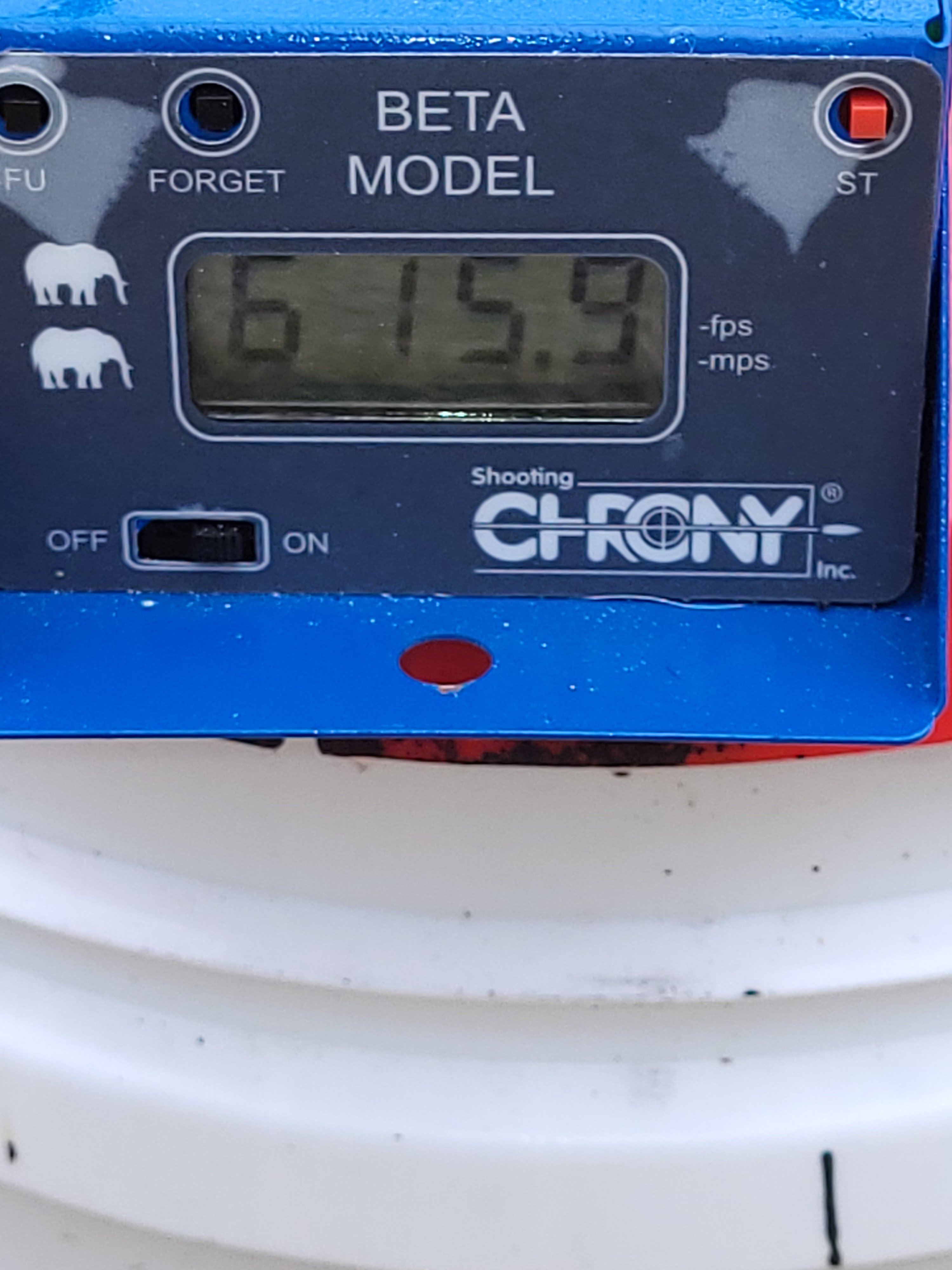

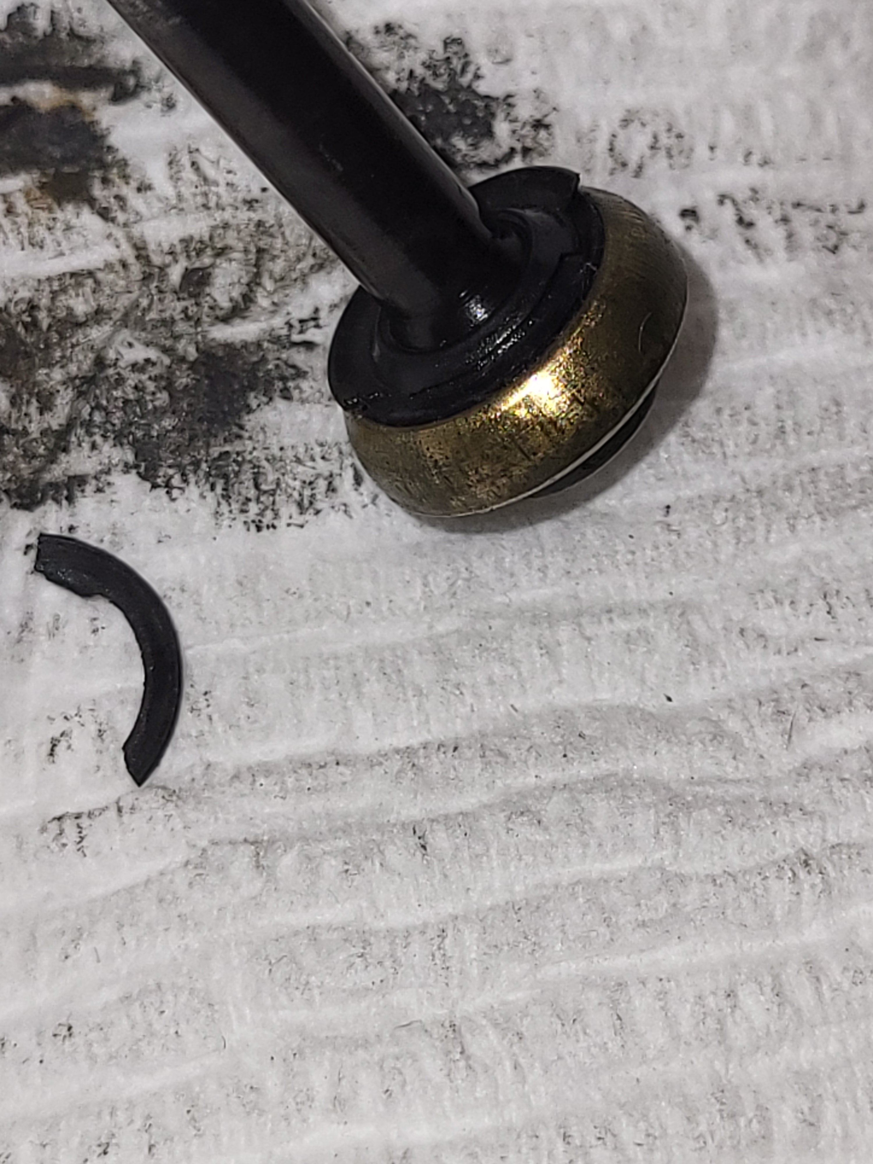

Went out shooting the 392pa this morning...about 10 shots in started shooting super weak. Cracked the bolt back, and gave it a pump to hear all the air rush out the transfer port. Broke it down to find this.
Got it all back together. Removed the bits of seal that came off, cleaned up the seal/mating surface inside the valve. Everything is good...$0Order a new one from JGAirguns.biz
The seal will continue to come apart because it the rubber is aging and starting to break down. Just be aware that you may still need to replace the exhaust valve in the future.Got it all back together. Removed the bits of seal that came off, cleaned up the seal/mating surface inside the valve. Everything is good...$0

I shaved off the rest of the outer flange that was coming apart and gotten trapped causing the leak. It will get replaced at some point....but not yetThe seal will continue to come apart because it the rubber is aging and starting to break down. Just be aware that you may still need to replace the exhaust valve in the future.
Like he said, order a new one and let it be on its way while you enjoy your plunger catching it's second wind.Got it all back together. Removed the bits of seal that came off, cleaned up the seal/mating surface inside the valve. Everything is good...$0

Yeah I don't have any illusions about needing to order a new 1....I am also that guy who won't put it in till this quick fix fails. Am curious how long it will last....for science!!!Like he said, order a new one and let it be on its way while you enjoy your plunger catching it's second wind.

I like it.Yeah I don't have any illusions about needing to order a new 1....I am also that guy who won't put it in till this quick fix fails. Am curious how long it will last....for science!!!
