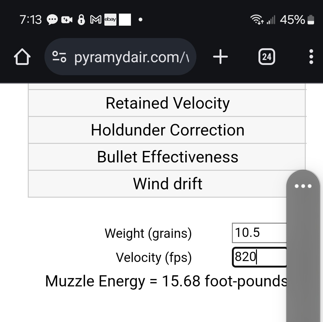

The look of the rifle is plain. But good. The dovetail seems to be aligned rather well. No scuffs, scrapes or dings upon inspection. LOP is a good fit and the ambi cheek riser is better than I thought. Shot cycle feels very strong, and is definitely different to a spring gun. I ran it over the chrono after having put about 100 shots through it.
About what I expected with heavy ammo. Pretty consistent for not being close to broken in. Total spread from 814-826, most shots are around 818.

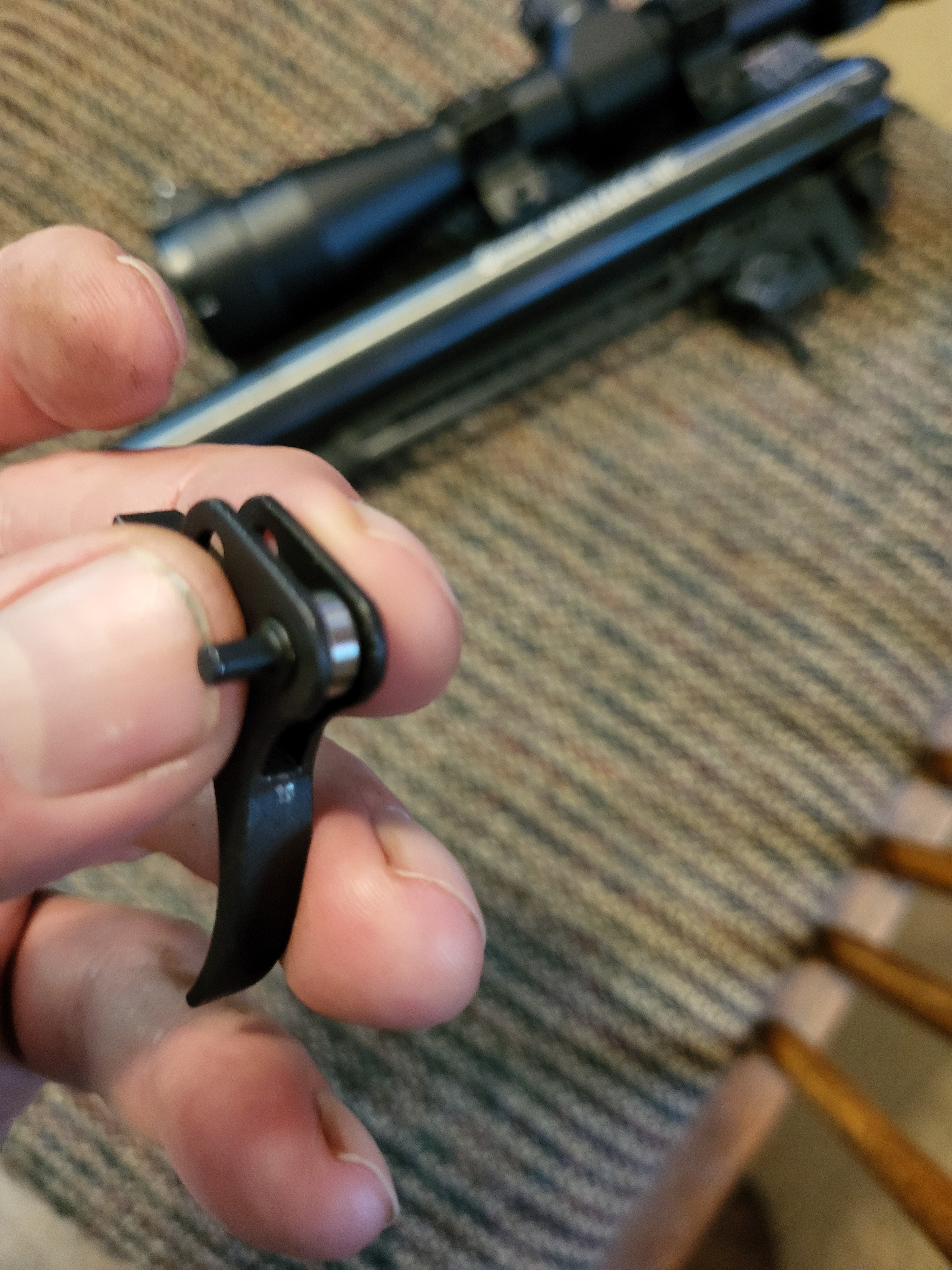

I have bearings for the trigger mod coming Monday. Currently I have removed the first pin and trigger spring to lighten it. The bearing will take out the play it currently has. Overall I think it will come together quite nice.

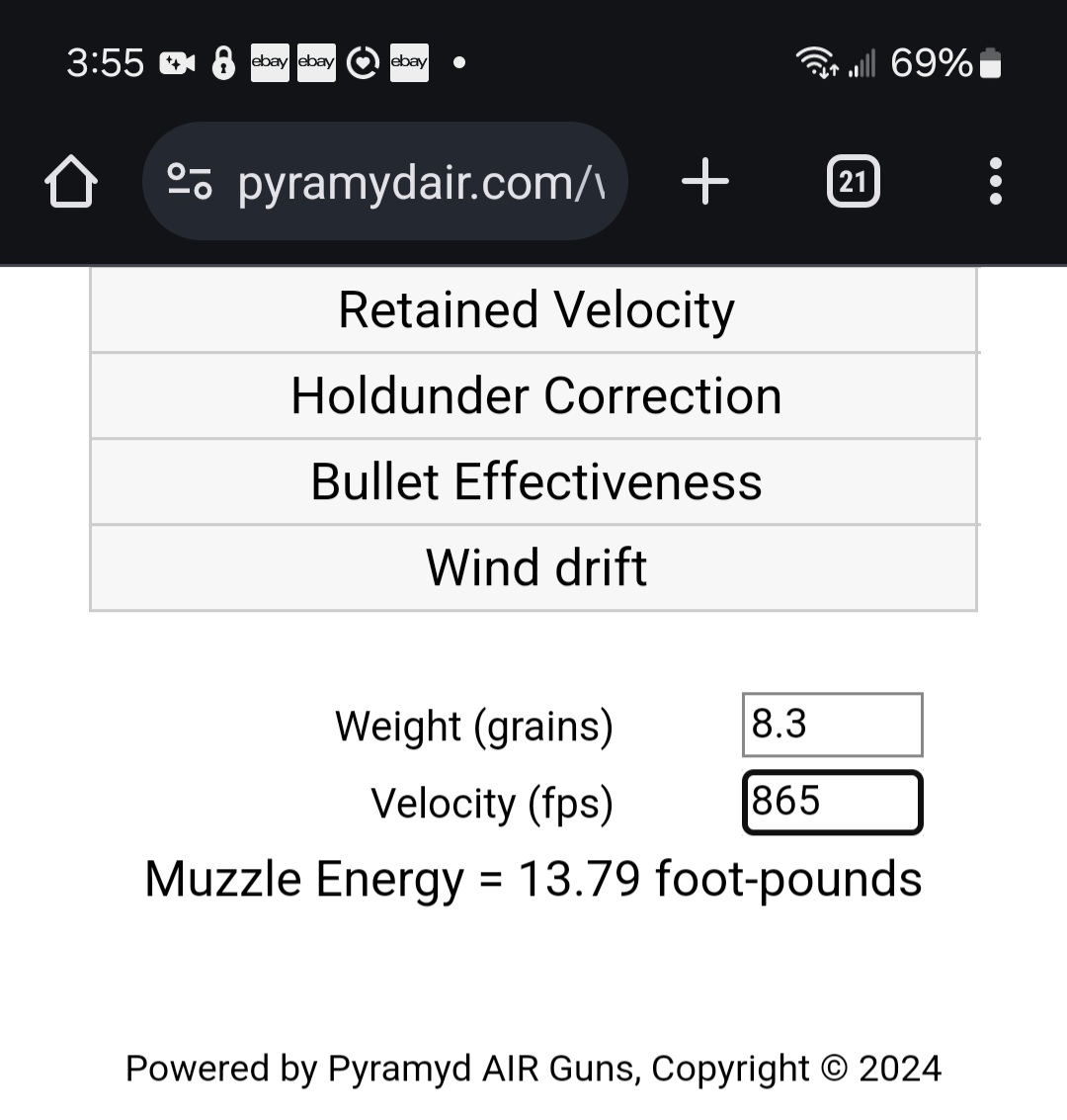

Some guys might wanna throw shade at the budget rifles, but really for a little more than 100 bucks....it looks decent. Feels good in hand, should put std. Weight 177 pellets right in the sweet spot for in flight stability in that 850-875 fps range. Not a lot to complain about.

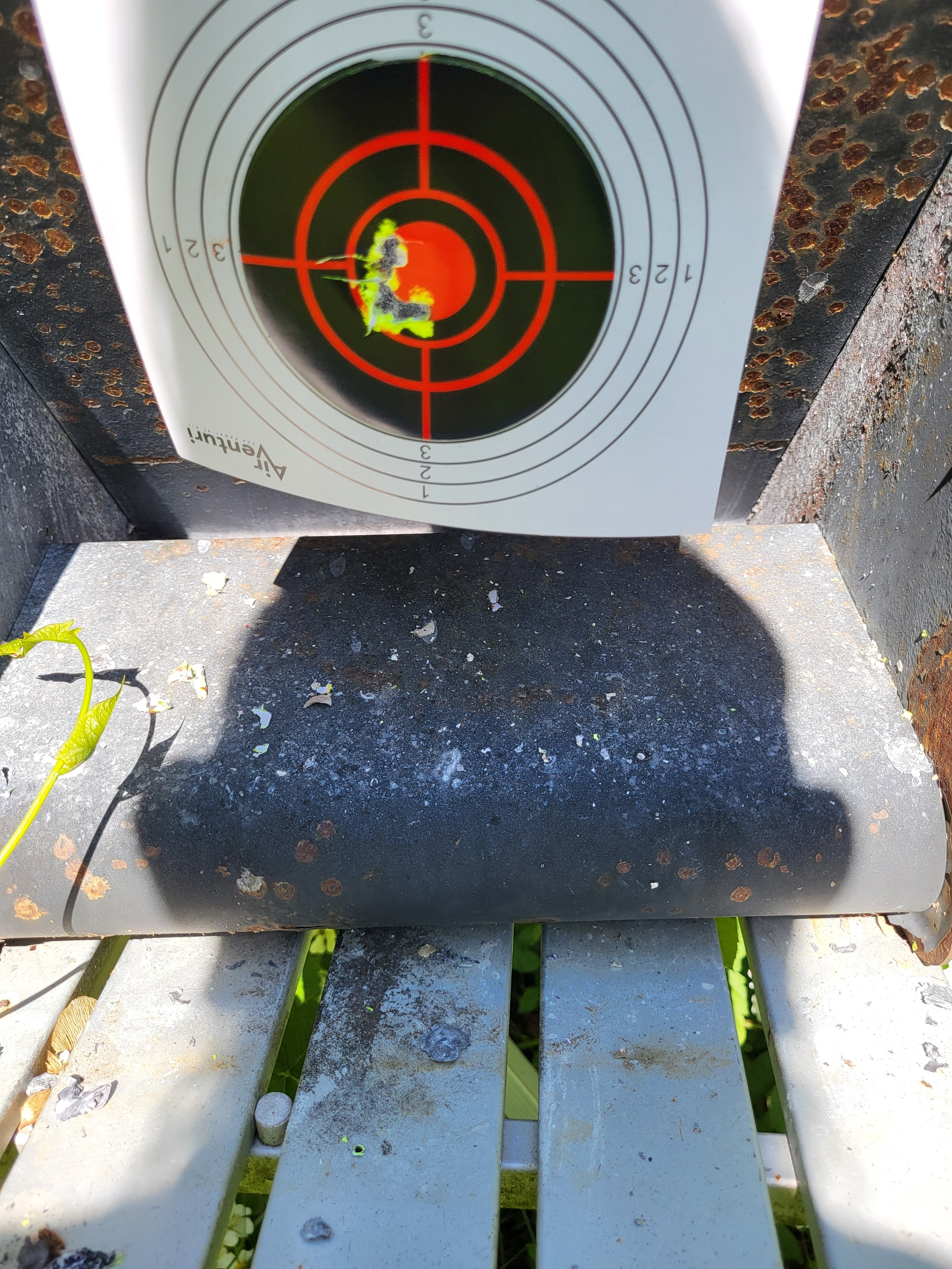

@Simplemann , I know you asked for groups at 25...what I have is 20 yards to work with. 8.3 gr. Superdomes. 5 shot group. Rifle has less than 150 rounds through it. I have made no attempt to polish the crown, and it still has a mostly stock trigger.
Bullseye is 5/8 in. The rifle is a bit hold sensitive, and the trigger could use some more improvement. This is seated offhand from my folding camping chair.

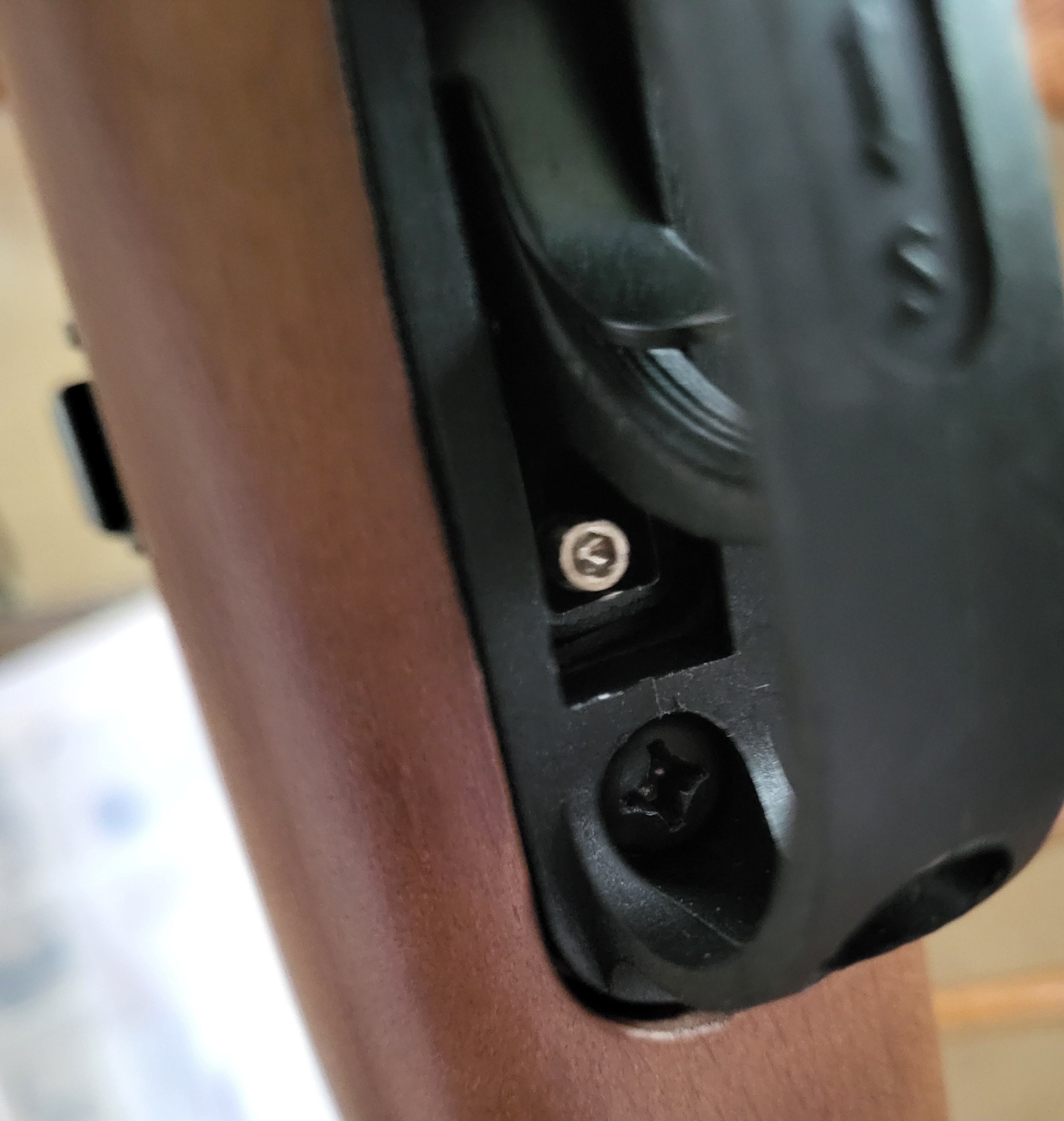

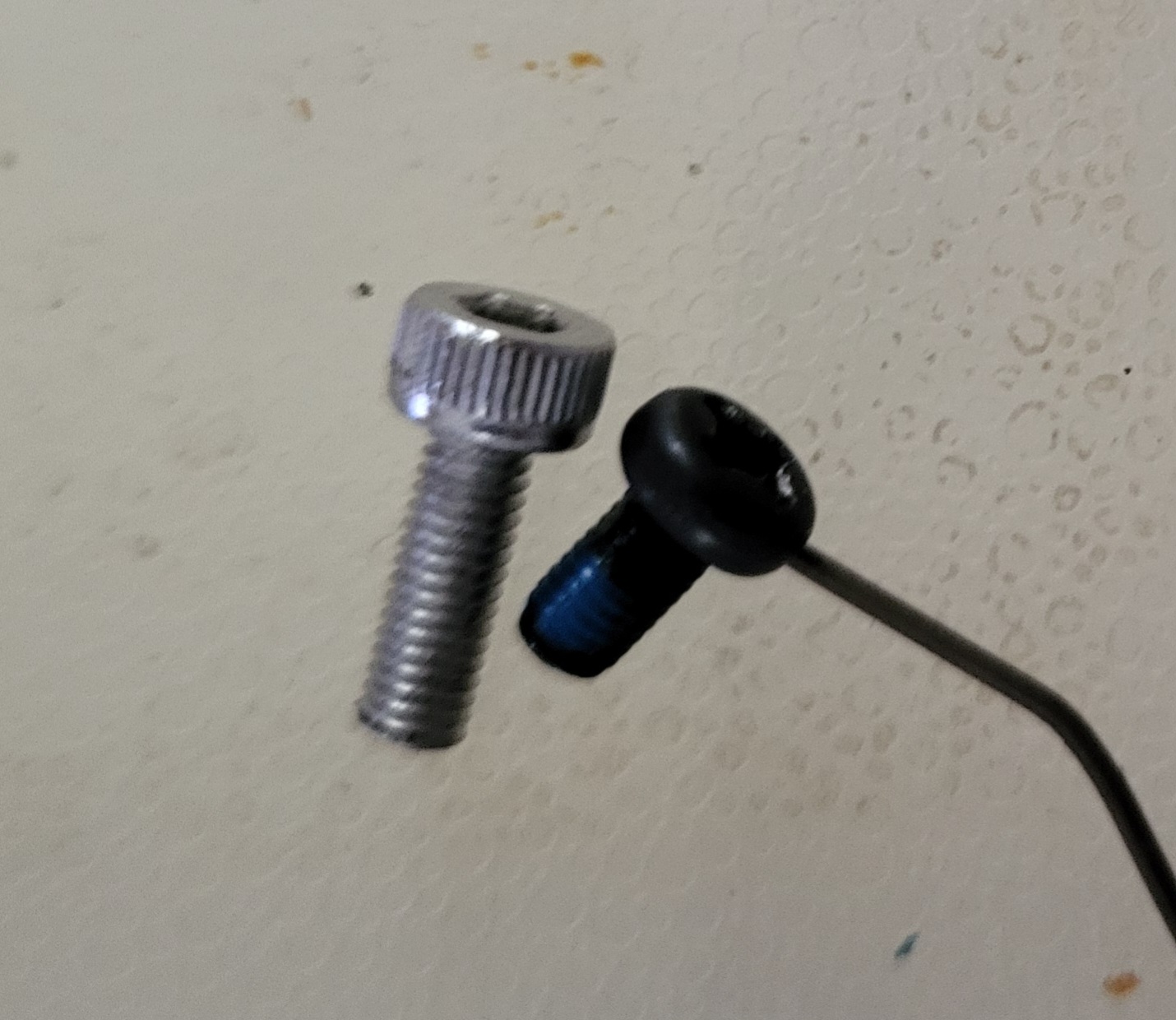

Longer adjustment screw trigger mod done. You absolutely can set it for a super clean short break. Mine is currently backed out for just a small bit of creep. I used a hex head screw which I was skeptical on during the install. The head size is taller so the trigger hits the screw head. I thought there may be a chance I would have it loaded and not be able to release the sear. Instead it works getting rid of some over travel shortening the pull after it fires.
I did reduce the diameter of the head before install, but not the height of it. Put a nice bevel on the thread end as well, so it is overall a bit shorter than shown here. Currently the 1st stage is just free, unsprung movement. Much of which will disappear when the bearing is installed. Should make for a very nice, clean single stage trigger, unless I can find some crafty way to add a spring to put slight tension on the slack portion of the movement.
If you are going to do this, be careful. You absolutely can push it too far if your screw is long enough to create a hair trigger, or 1 that doesn't catch during the cocking stroke. Start with it backed out more than you intend it to be once adjusted. Remember. ...I did not recommend, suggest or coerce you into doing this. Do not attempt this without understanding how everything you are changing works.
