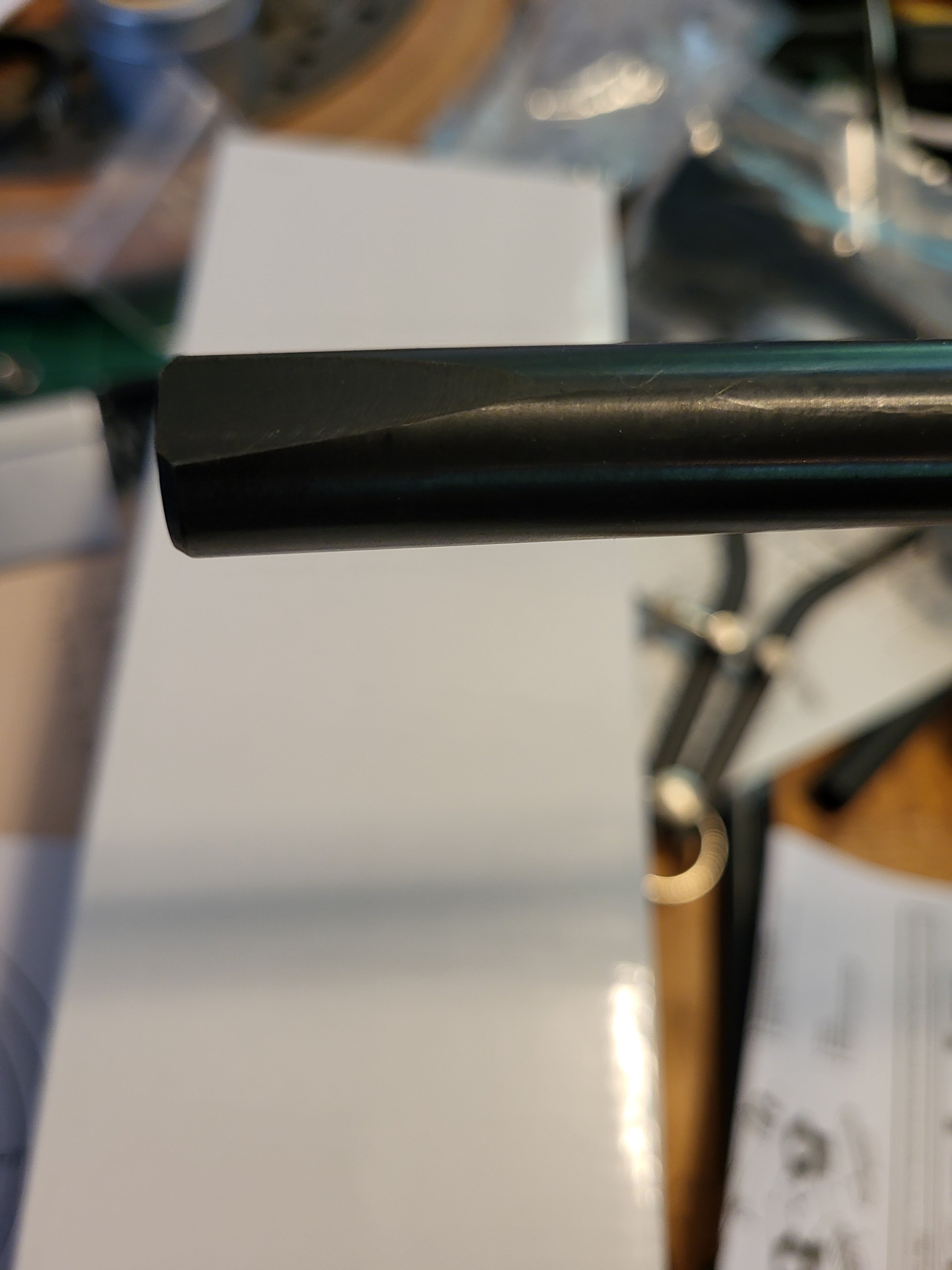

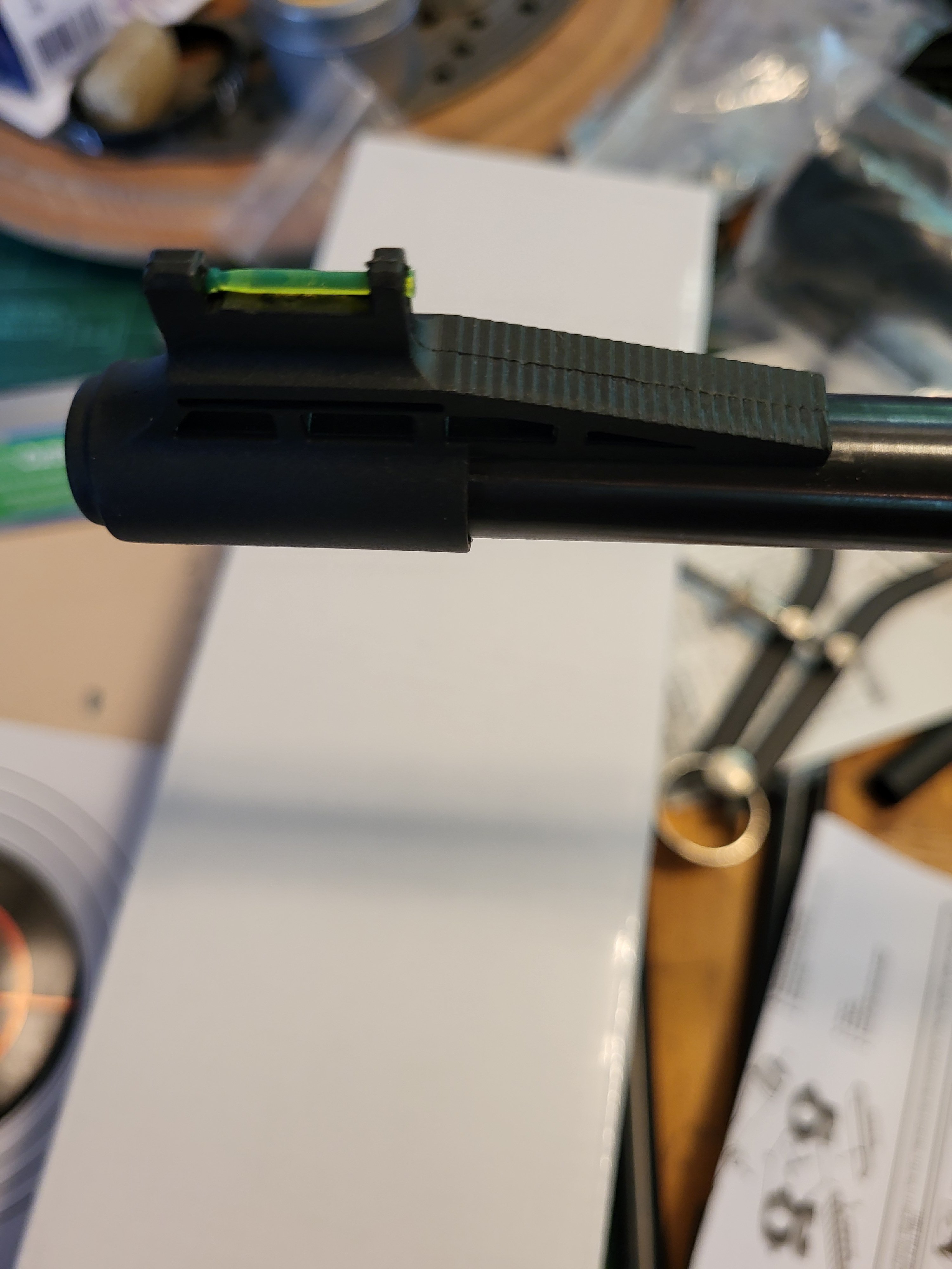

Got rid of the front sight, going scope only on this....in spite of how hard it may be on them.
may look into a muzzle brake. Definitely makes cocking easier being able to slide your hand a little further down without anything in the way.

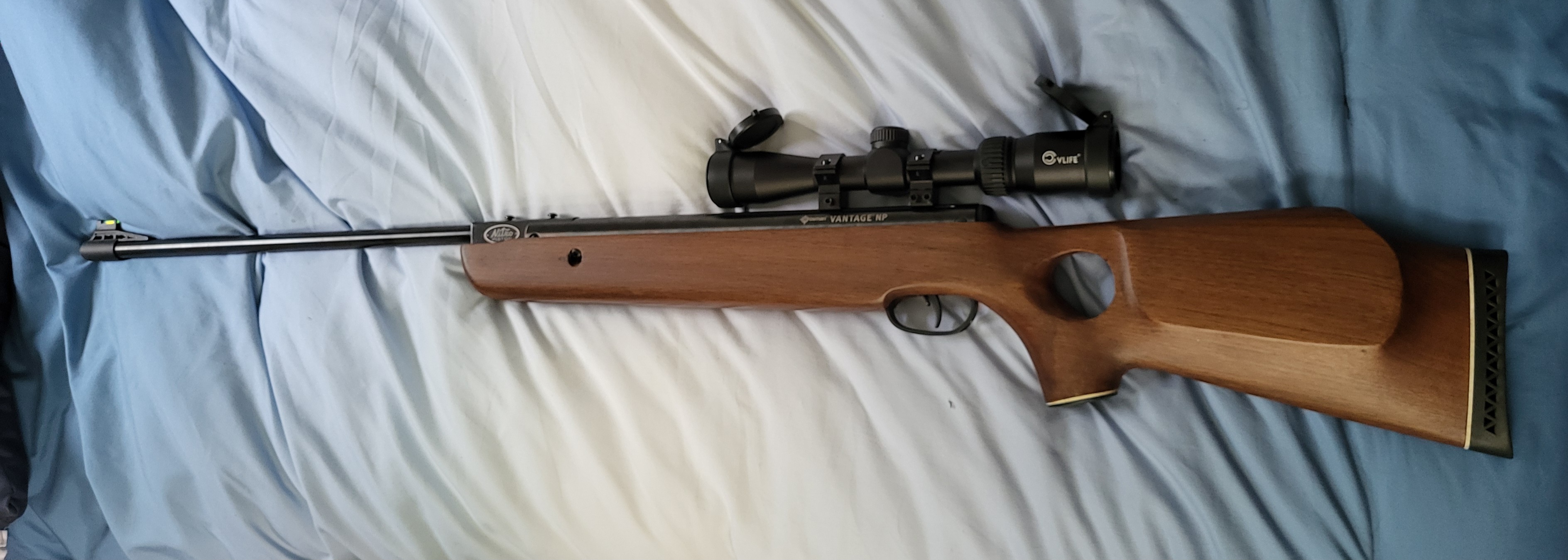

Now that I have the hold this rifle prefers figured out, I thought I would try a thumbhole stock on it. A little extra weight, we shall see if it stays on there. Gonna get in some shooting tomorrow , hopefully before the rain comes.
the option to swap stocks with the crosman lines has always been a nice option. There have to be at least a half dozen direct fit models for this gun.

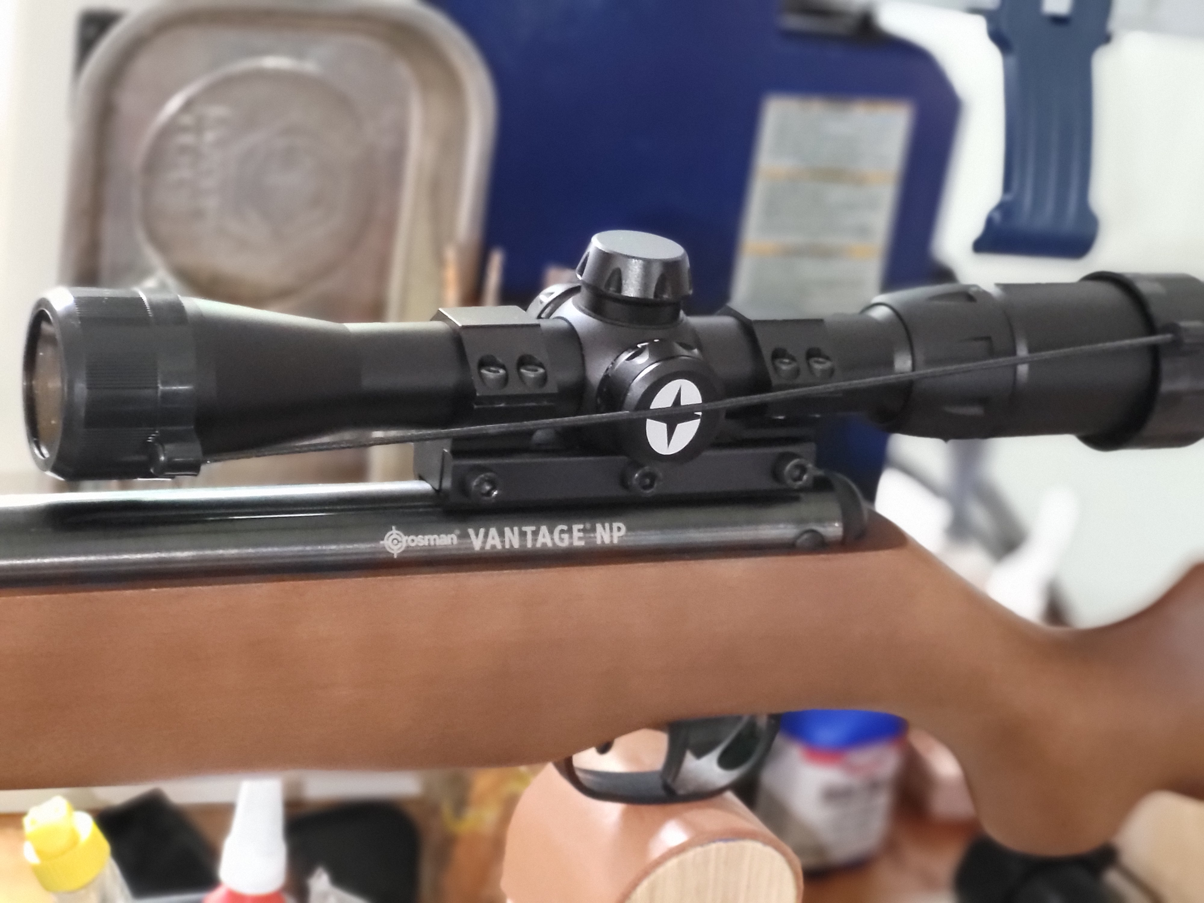

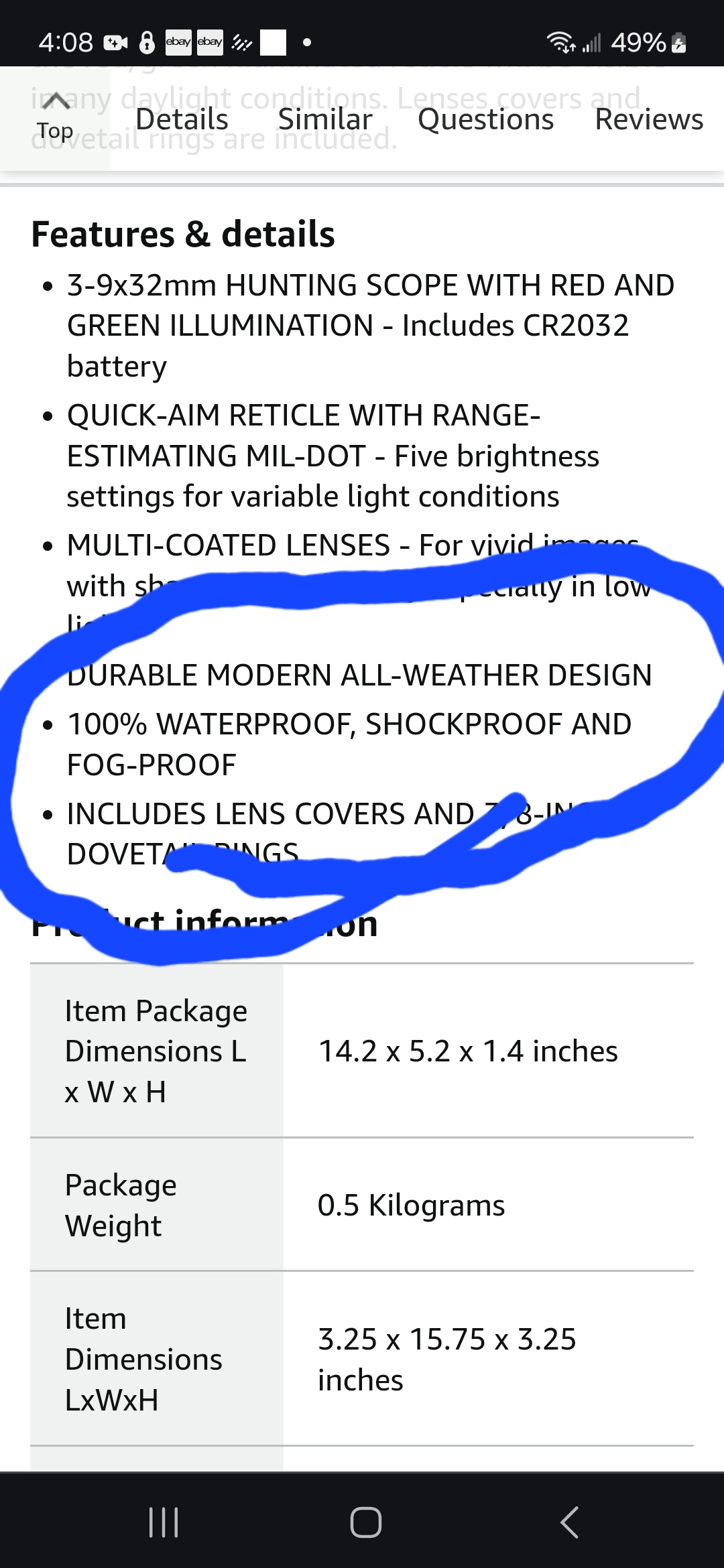

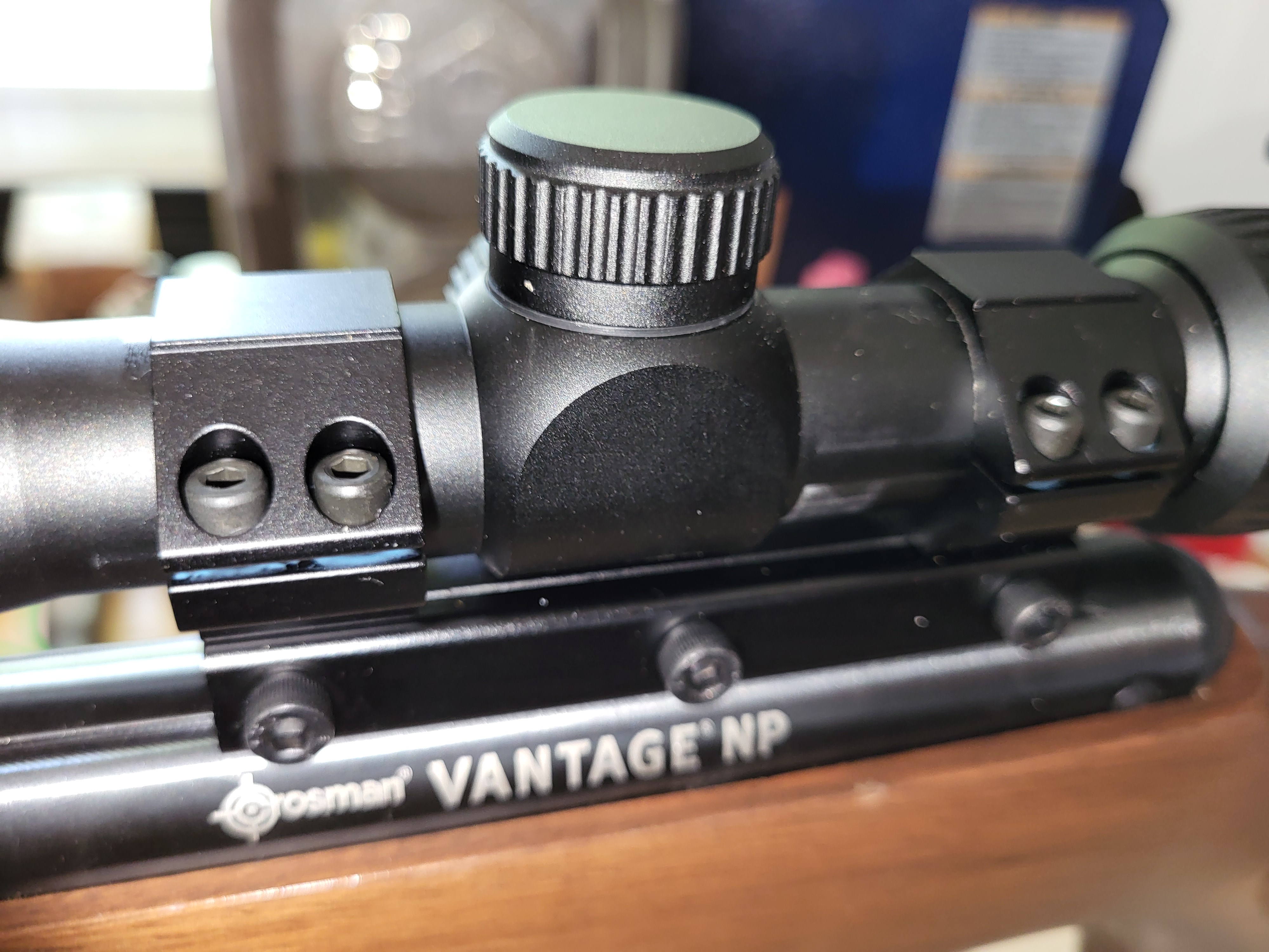

The scope has been returned. Overall I would buy it again for a mild springer, multipump, co2. Or budget pcp rig. On this gun it doesn't cut it.

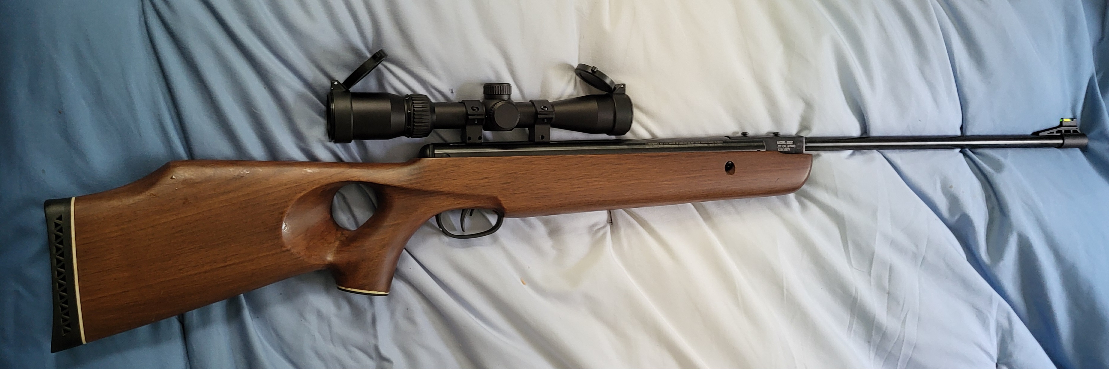

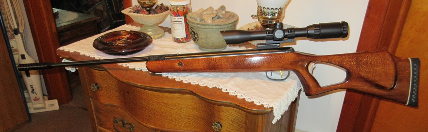

There are. Had the spring version of your Vantage in the Optimus more than a few years back. Like thumbholes and arranged a trade for Benji Titan stock a fellow member of another forum had. Don't have the action anymore, but I still have the Titan stock with a Benji Prowler .22 in it.
Scope destroyers?? Read descriptions, find ones that straight up say "Springer Rated" and if in doubt, email the scope maker directly and ask them. They'll happily tell you if the scope you're interested in is springer rated or not.

I have the cabelas outfitter, which is also a spring version of this gun. Never had issues with scopes on that. This np version is different. First the scope slid in the rings, and started to put some wear on the lip of pin stop hole. I changed to 1 piece , 4 screw per ring set up, and with the last scope the poi changes every few shots. Stock screws were tight. I switched to original stock to see if maybe there was a difference in how the action sits in the stock making the problem...same problem.
